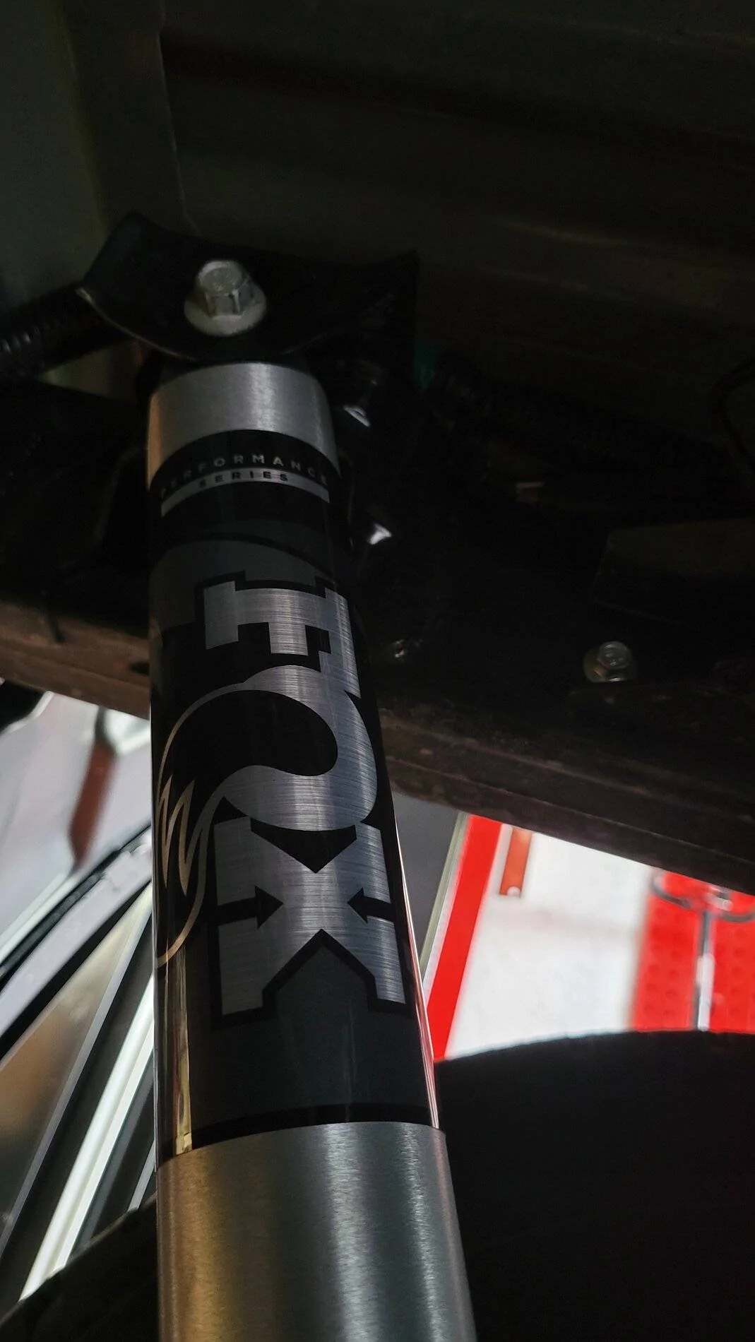

Hello all,
I wanted to just post my general journey throughout the rear shock installation. To begin, I never really use tools in my life. I wish I did more so I try to look at the instructions to see if it’s easy enough. Fox instructions were pretty bare and I was like okay… but I understand why. Rear shock installation is pretty much two screws to unbolt and rebolt back in.
I lifted the truck on the side I was working on with the OEM hand jack, then put a stand under the frame and reduced pressure off the hand jack. The more worrying part was if I needed a tool to compress the shock. I did not. As mentioned by a comment I found, they spring back slowly and isn’t dangerous. Thus, I bolted the top shock screw at 52 torque and then positioned my self so I would get the most leverage out of my shoulder and bicep to align it with the screw hole. It would help to have a second pair of hands to bolt back in the screw as you align it. I torqued the lower shock bolt/screw to 92.
All in all, a two hour process for someone not so mechanically “bright” so to speak. I highly recommend people in the same boat as me to try this out. Learned a bit more today and saved some money from taking it into the shops! Learning many skills and knowledge from owning this beauty. Thanks for reading my long post and hope it helps others at some point in time.
Cheers,
Brandon
P.S. mono tube design meaning it doesn’t matter which way the shock is , but what do you guys prefer?
EDIT: quoted stage3 explaining why they prefer the body up and shaft down. Will change in future. Won't be too big of a deal unless I decide an off-roading trip.

Do the Fox shocks have a boot?
While a monotube doesn't matter which way it's installed, most install with the boot down so that water and mud isn't sitting in the boot on top of the shock body.
No boot however reading this post, perhaps I should have installed it the other way with the logic from stage3. Thank you for your insight, Dennis.
With a monotube shock like the Fox 2.0s, orientation doesn't really matter.
We generally recommend (and generally do) a barrel-up, shaft-down orientation on our trucks. Our theory is that it's a lot harder to nick a hardened steel shaft to the point of causing a seal failure (not that it can't happen, and it absolutely can) than it is to puncture an aluminum or steel shock body by anything you kick up on the road/trail.
Not to mention, shaft damage can be mitigated by adding either roost shields or a universal boot.
On basic hydro shocks like the OEM shocks, orientation absolutely matters, since their valving is generally only restricted in one direction.
Guess I will go back under and do this again. Not now though, perhaps in a further future before an off-road trip.

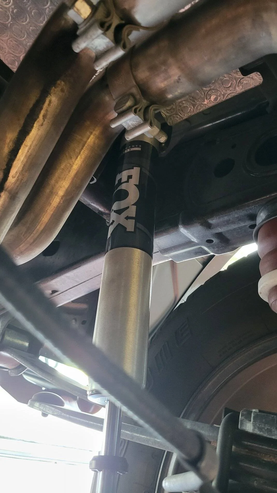

Update..
Got mine installed today..!!

Driven at all yet? Looks great! Pretty easy huh?
Took it for a ride around the block when I was done. Certainly feels like it tightened up some of the bounce and slop in the back end. Will go for a longer ride tomorrow morning about a 30mile trip so I'll have a chance to feel it out better tomorrow. It was super easy to do...

I am so glad to hear it all worked out with ease. Also, good to hear that for the quick block around the butt felt a difference :p Let me know how the longer drive feels on all the different roads!
