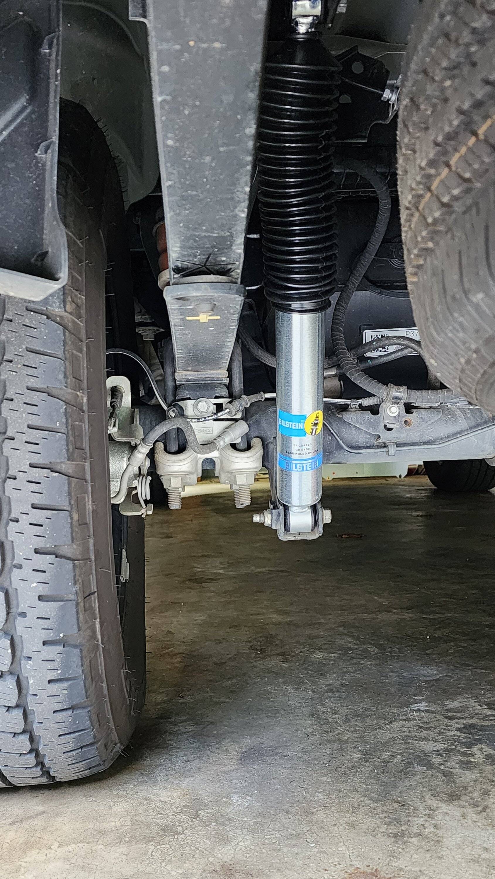

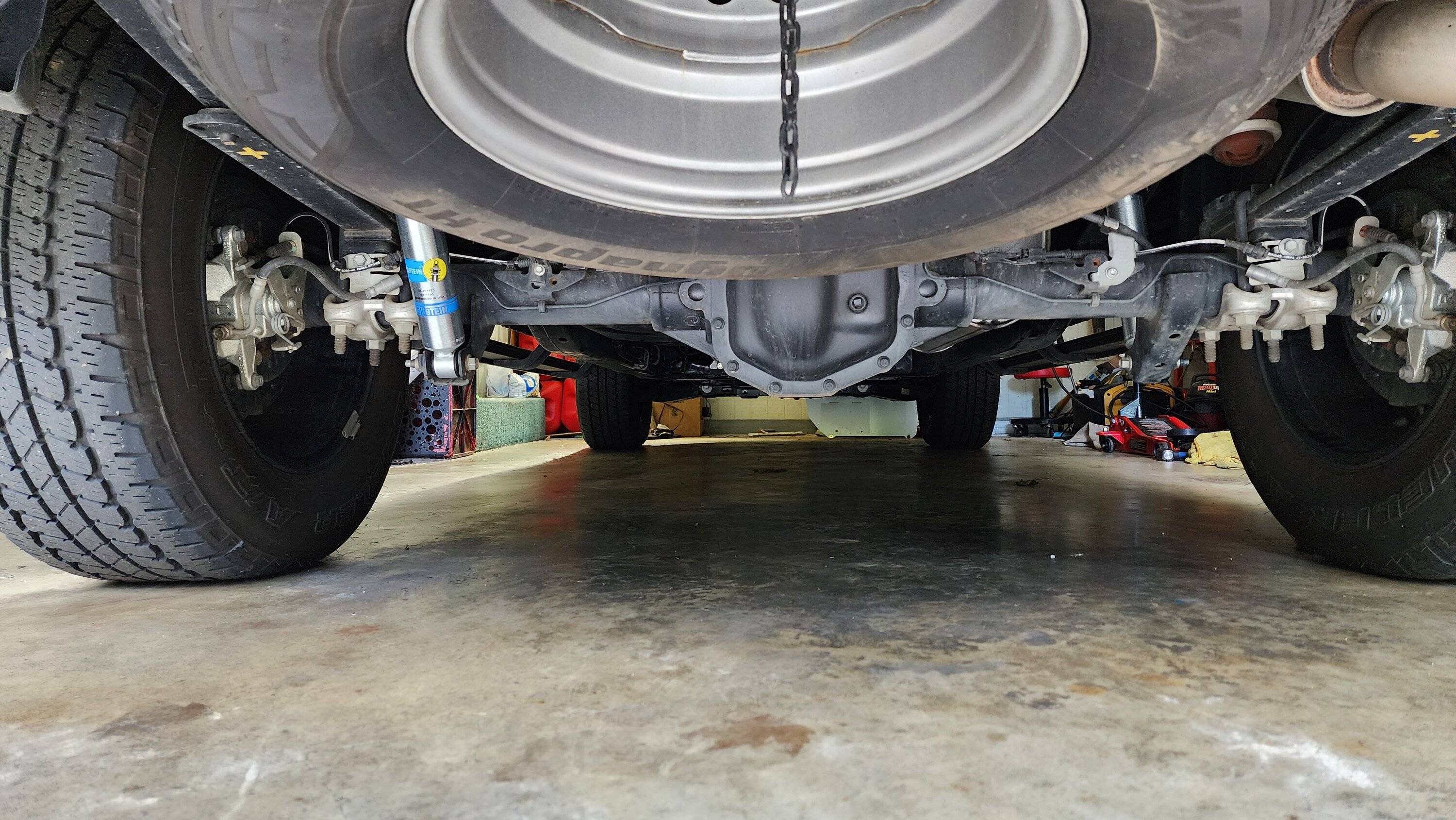

Well, I just did this. Installed rear Bilstein 5100's. Sits strangely high in the back now. Will this settle down a bit??
As for the ride, this makes such a big difference. I think the transmission is even smoother.. somehow. Firmer, but most of the harshness is gone but I suppose I'm preaching to the choir here.
How much higher is the rear? If I recall correct, when I installed Fox rear shocks, my rear went up about 0.25"-0.5". The blisteins are stiffer, so may increase the height more? It may settle. I can't recall if mine did...
I would estimate it went up by at least an inch. Since I wasn't expecting it I didn't measure before hand.
I guess this height change means I'll be forking over a bunch more money to do the fronts. I hear it's a tough job so I'll pay someone to do it.
