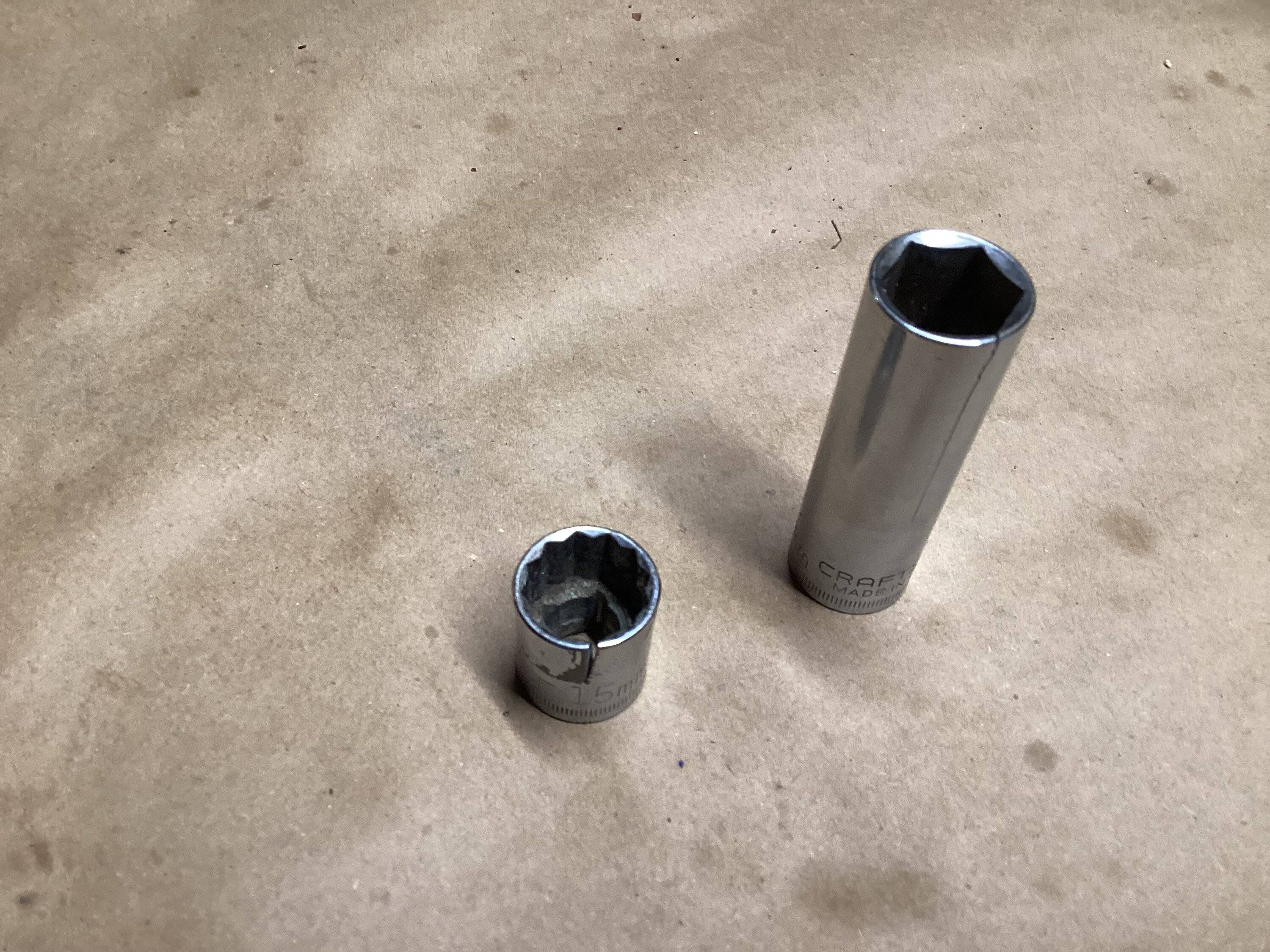

I got them out , heated with propane torch 3/8 ratchet and cheater bar, one 15 mm socket flew off impact yet to be found. Booth clamp was loose from factory so reused and re -crimped .
A little was on blue slip plastic, but glad I did it.
No concrete or level driveway, 77 yr old
under truck in Fl grass and sand.
This years oil change, tire rotation, and this done.
Never ends seal that leaks on 40 yr old floor jack.
two broken 15 mm sockets to show for effort before heat was used.
contact Stanley tools for replacement, Ace Hardware would not honor Craftsman warranty.
