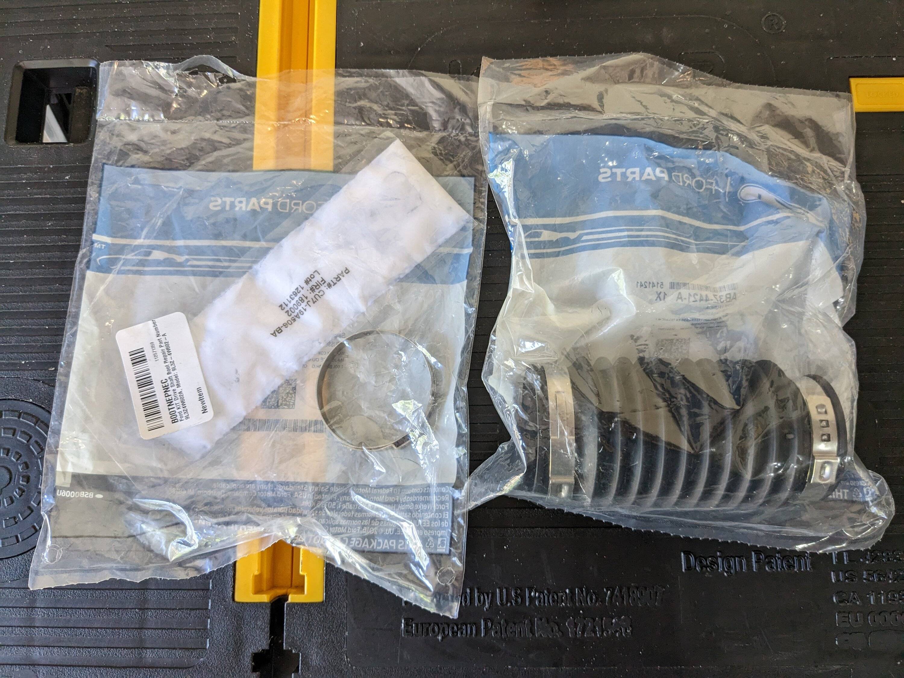

Parts I ordered:
Ford KIT Drive Shaft Boot Repair Part Number 9L3Z4W602A, Model: 9L3Z-4W602-A
FORD OEM 19-20 Ranger Rear Suspension Drive Shaft-Boot Kit AB3Z4421A

I was not able to get the band clamp with the Boot repair kit to fit. Perhaps that kit is specific to F-150s and they have a different, slightly smaller size clamp. I used the clamp from the boot kit, even though I was able to reuse my boot.

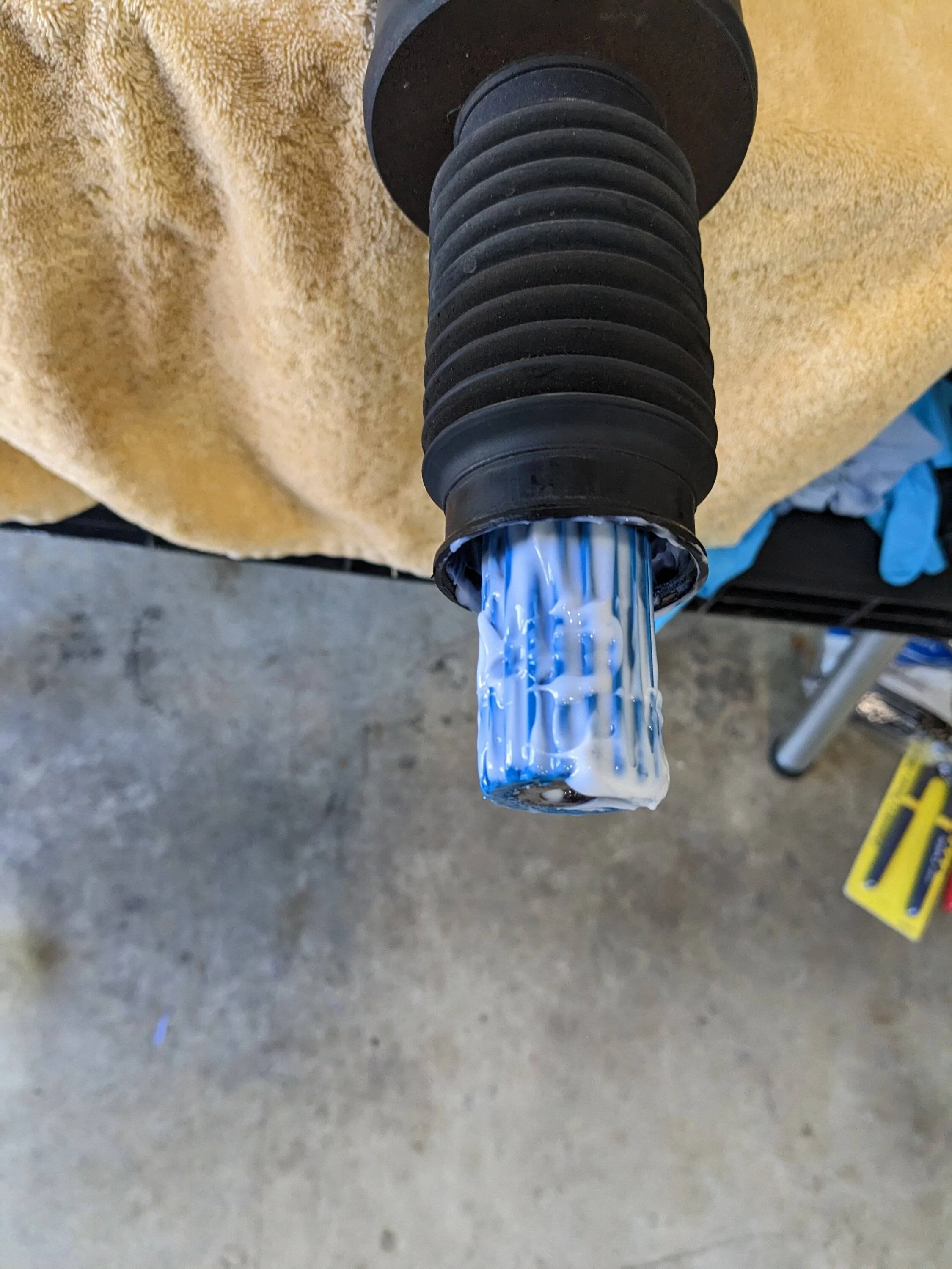

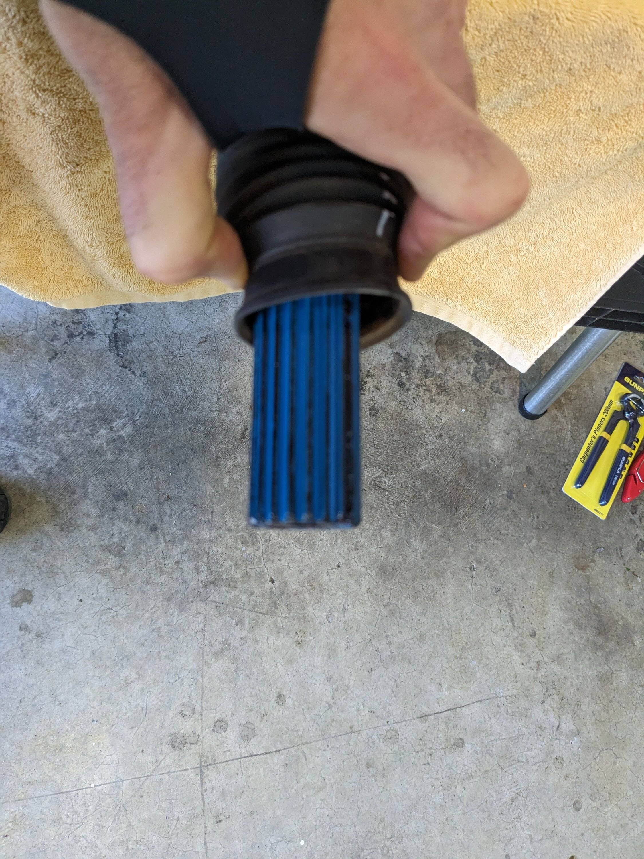

The repair kit I used had the white lube, in contrast to the blue lube Quangdog used. If I ended up needing this repair again, I will try the other lube.
My bump is still present about half the time it was before. However, it is significantly less violent and much harder to notice. It is possible what still remains could be something else like the suspension settling, brakes, transmission, etc. I am 100% happy with the result and really don't notice it where before it was all I noticed on the truck.

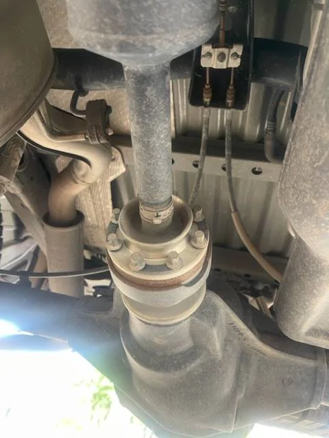

Preparing to lubricate this slip joint, I’ve looked over this and other related threads, looked for pics and videos and I have not seen anyone with the same driveshaft set up that mine seems to have. Instead of a few larger bolts attached to the rear diff, it has 8 little 11/32 bolts holding the driveshaft. I’m hesitant to take it off as it looks like there are a series of what look like spacers between the two, Any input would be appreciated, anyone else with this setup?

That is the same setup that mine has, I believe it is a Tremor thing. What you were expecting to see was a universal at the rear differential. What you have is a CV joint.
That the Tremor. I have not heard of anyone lubing the spline on a Tremor, but maybe some have.
I have not taken one of those apart, but I would not be afraid of it: mark the outside of the joint with a mark that runs through everything you'll be taking apart, then pull the bolts and drop it. If the individual bolts are shimmed, keep track of which shims go with which bolts. When you re-assemble, just make sure everything goes back exactly where it came off.
Good luck!
Interesting, I thought it might be Tremor specific, not sure about taking this loose, lol. It closely resembles a can of worms. ?

TLDR: The Ford grease sucks, bump came back. I re-lubed with CS Moly and the truck is amazingly buttery smooth on stops and starts. Time will tell if this grease lasts.
The Ford grease in the above repair kit reduced my bump on stop and start by about half or a little more. It never cured it. Based on the white appearance of the Ford grease, I'm assuming it is lithium based. Over the summer, the bump slowly got worse again. When I removed my RTT in August (no more weight controlling the rear of the truck), the bump really got worse.
I took the truck to the dealer a month ago. See my post here where they blamed the rear suspension helper spring pads, anything but the spline joint or driveshaft. They refused to lube anything for me.
At the suggestion of some folks in the One Piece Driveshaft thread, I re-greased my spline joint last night with "CS Moly". The recommendation was to use a calcium Sulfate based grease. Another forum member in my geographic area had good luck with CS Moly, so I used that brand.
Result: Wow. My truck was never this smooth. No hint of a bump on stop or start. Also, driving around more this afternoon, I noticed the transmission is smoother when coming to a stop. It is way less clunky when slowing down. The Ford grease never got it this good. The bump is gone.
I did clean out the female end of the spline joint very thorough this time. There was a lot of sticky red grease in there, I assume from the factory. I also put a crap ton of the CS Moly grease inside the female end, and all over the male spline joint grooves. So much grease I had to kind of 'burp' the joint when inserting it due to the grease sealing it up so well.
I'm curious on longevity. However, it is way more promising than the Ford branded grease in the driveshaft repair kit. I can stomach doing this every year or so, but more than that and it is a real PITA without a grease fitting on the spline joint and without access to a lift. I can do the repair in 1.0-1.5 hours myself in my garage. Most of the time is getting in and out from under the truck.
If you have the bump, like was noted in the One Piece Driveshaft thread, the grease type really does matter.
