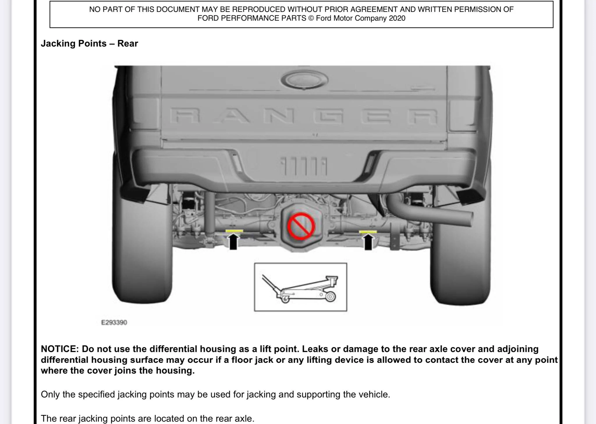

I used a hydraulic floor jack to lift right at the center of the bottom of the rear diff, then placed jack stands under the rear axle out near the wheel on each side, then lowered the jack.
Ford doesn’t like that:
