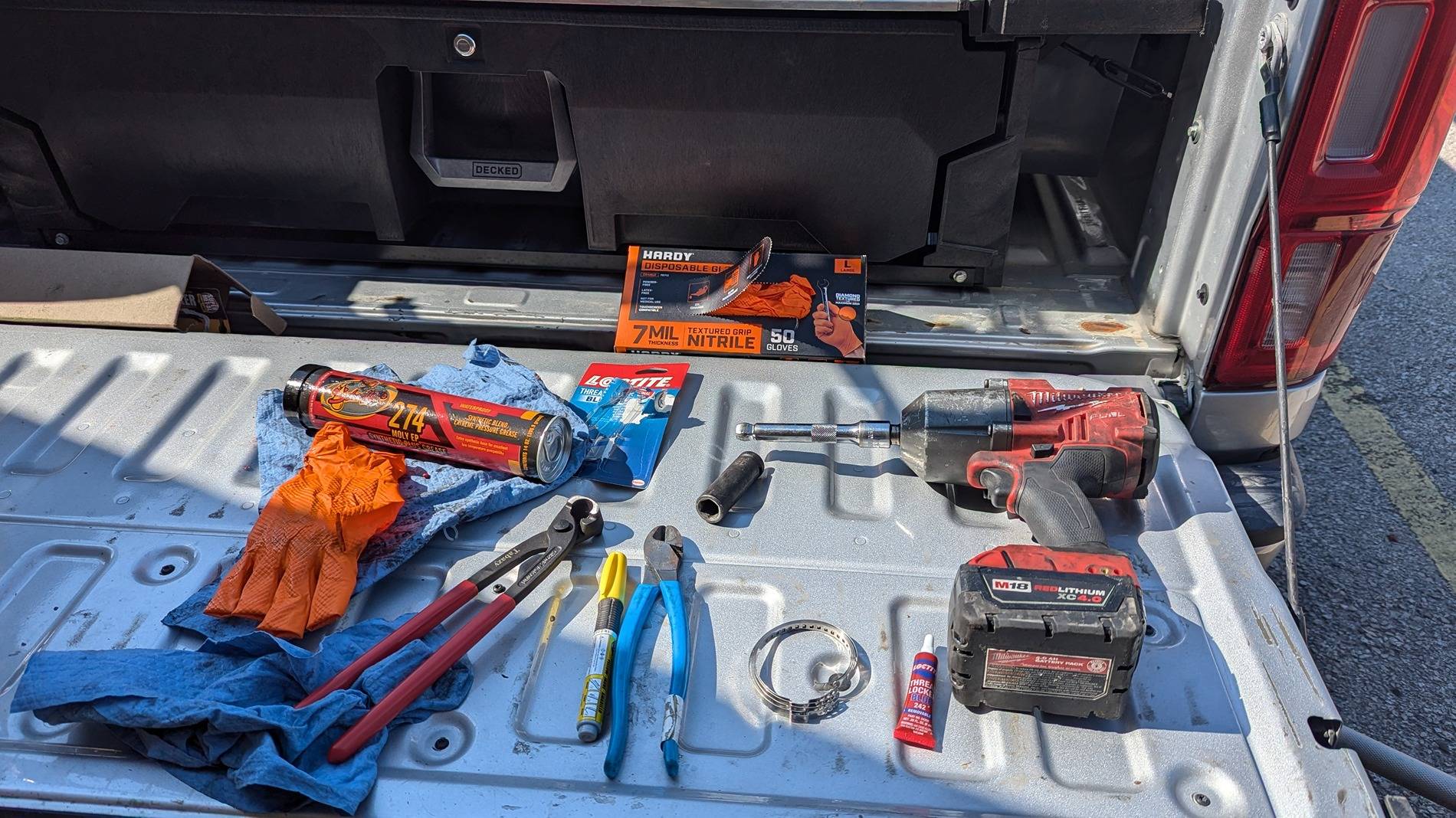

This eventually led me to this forum, and eventually to this thread. Thank you so much for sharing this fix. It is VERY easy if you have the right tools. Here is a picture of everything I used. I did not use a torque wrench, just set the impact to #2 setting and used the German method of gutten-tight.
Honestly this was easier than changing the oil. Seriously. I did not set the parking brake because I just used an impact, the secret here is using a wobble extension to be able to use it. Also I did not have an ear clamp tool/clamps but if you get a CV kit from Amazon the small bands are perfect.
Amazon ear band kit.
https://www.amazon.com/dp/B09NDD3TNQ?ref=ppx_yo2ov_dt_b_fed_asin_title
I could not get the blue Ford official grease soon enough and it was nowhere to be found locally so I got some of this.
https://www.amazon.com/gp/product/B00JF2LBQ6/ref=ppx_yo_dt_b_asin_title_o01_s01?ie=UTF8&th=1
Bump/thump SOLVED.
Here is everything I needed for the job. Took less than an hour.
**** Tip for getting the splines correct, once you pull out the shaft you will notice a single valley in between splines is all black instead of blue, you'll notice on the female part that there is a couple of spots that have space for two splines, you'll notice it when you take it out even though this may sound confusing.****
Bump/thump SOLVED.

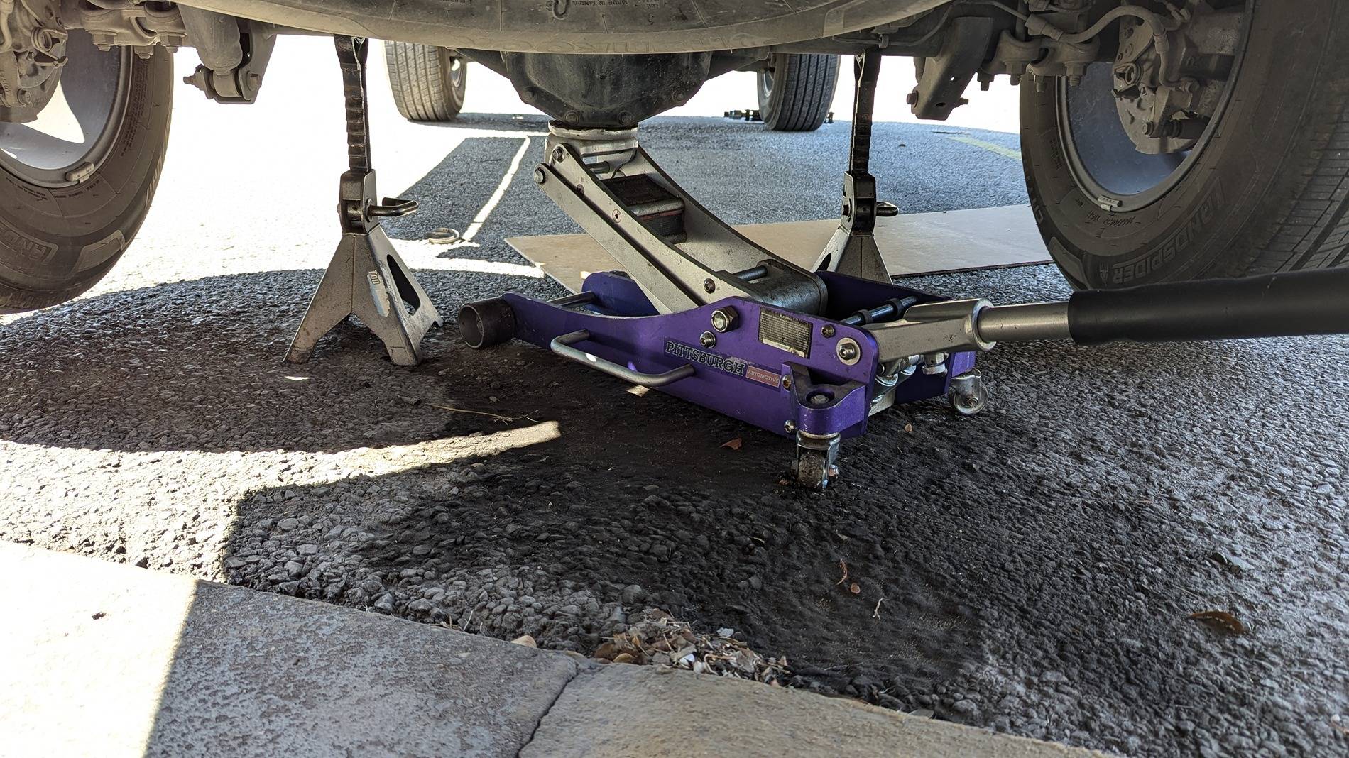

I might be wrong, but have always been told not to jack up rear using the bottom of the pumpkin. Please someone correct me if this is bad info.
