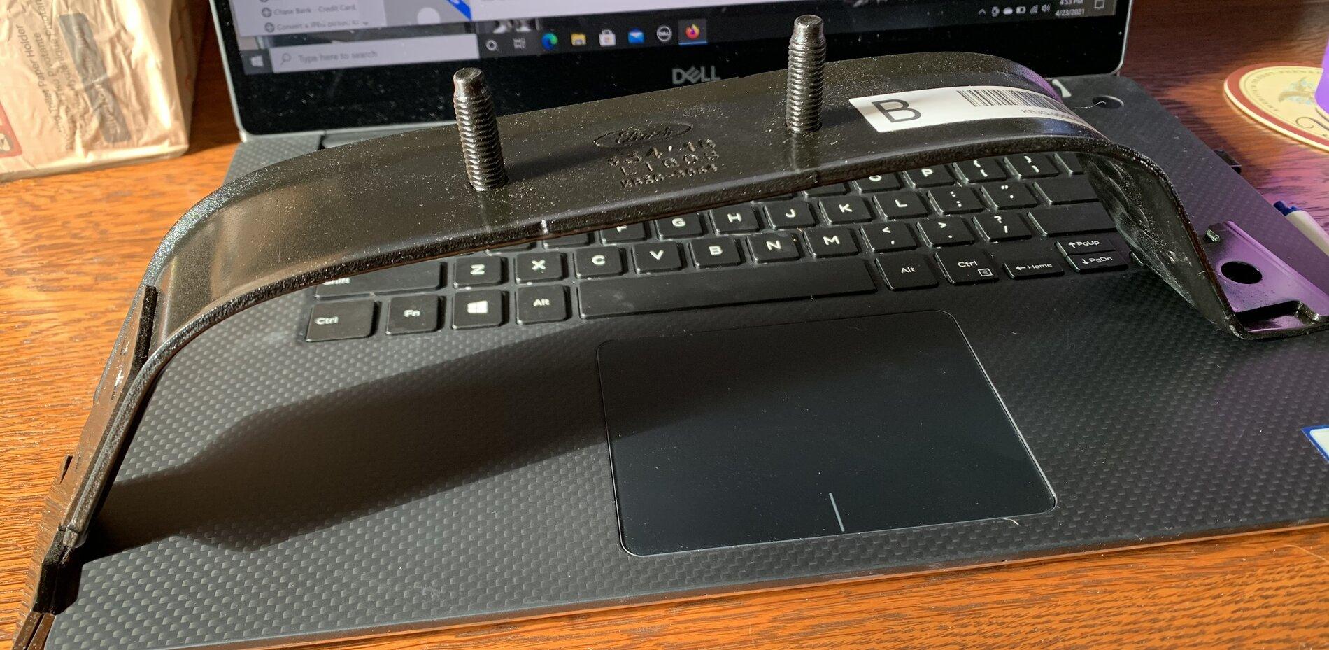

Based on some concerns raised on this forum on crash safety, I ended up getting the proper fuel tank brackets, with integrated studs: I didn't want to risk a normal hardware store bolt pushing up and through the fuel tank, causing a rupture/explosion/etc.
Presumably they designed the fuel-tank skid plate straps with crash safety in mind, and I didn't want to risk anything.

this is the front bracket
KB3Z-9054-B
I am unable to locate the rear bracket.
I think maybe I have found it.... going to order and let ya know....
Presently, I'm looking for the OEM Nuts...
I know i can go to LOWE's and get nuts & washers.... and they would work... but I want OEM....
KB3Z-9054-B​

I wasn't able to find OEM nuts...and stores didn't know either. But, they're not holding a large load anyway, so I think anything would work. I used M8 locknuts with fender washers, and they work fine (at least, it seems like they do :) ).
