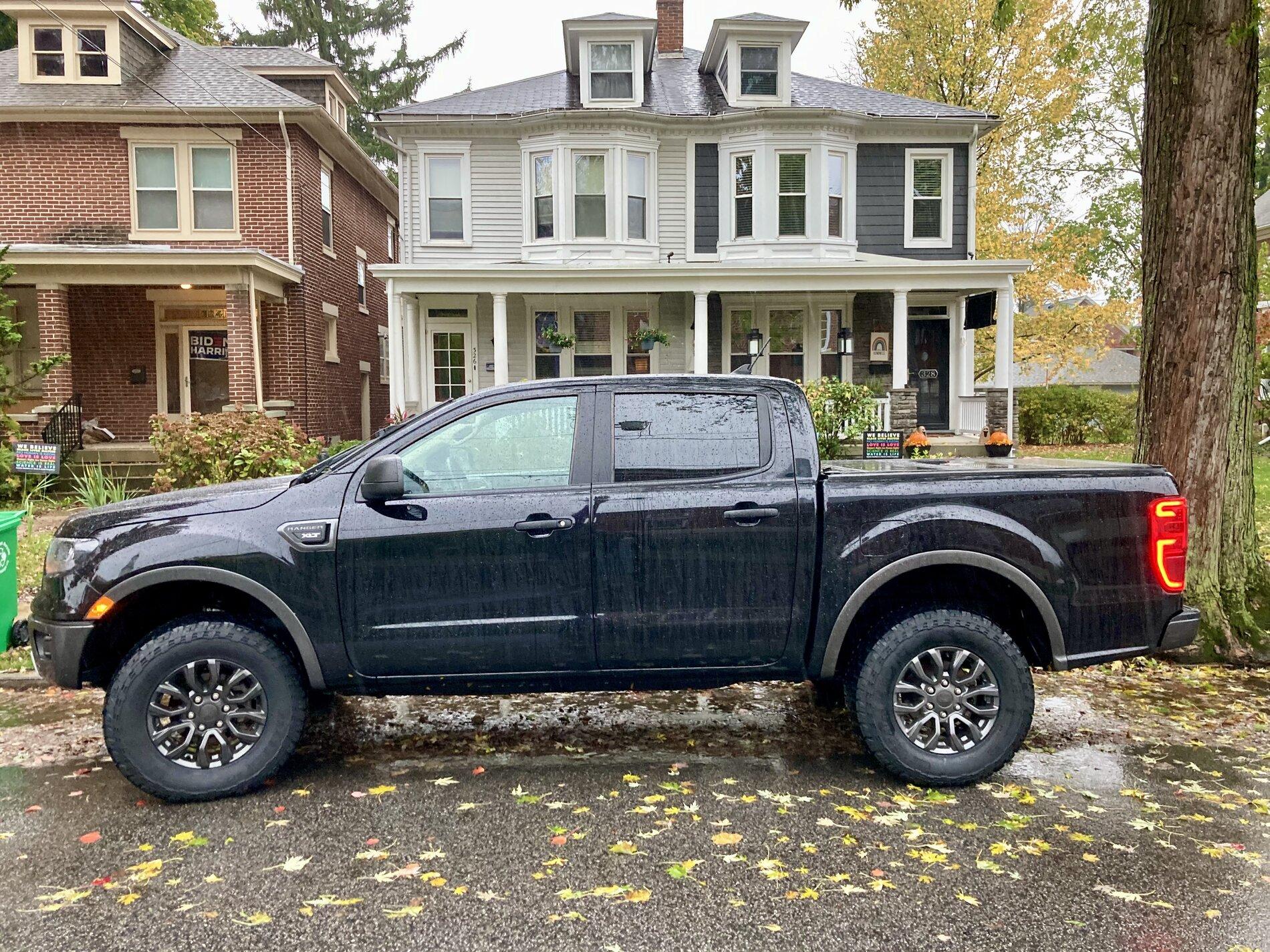

wnt w/ the fox 2.0 kit front and rear with 2.5 lift and grabber ATX in 265-70r17.
it's like a brand new truck from sport package (non fx4) to this!
wow, i'm in love w/ it all over again, lol.
