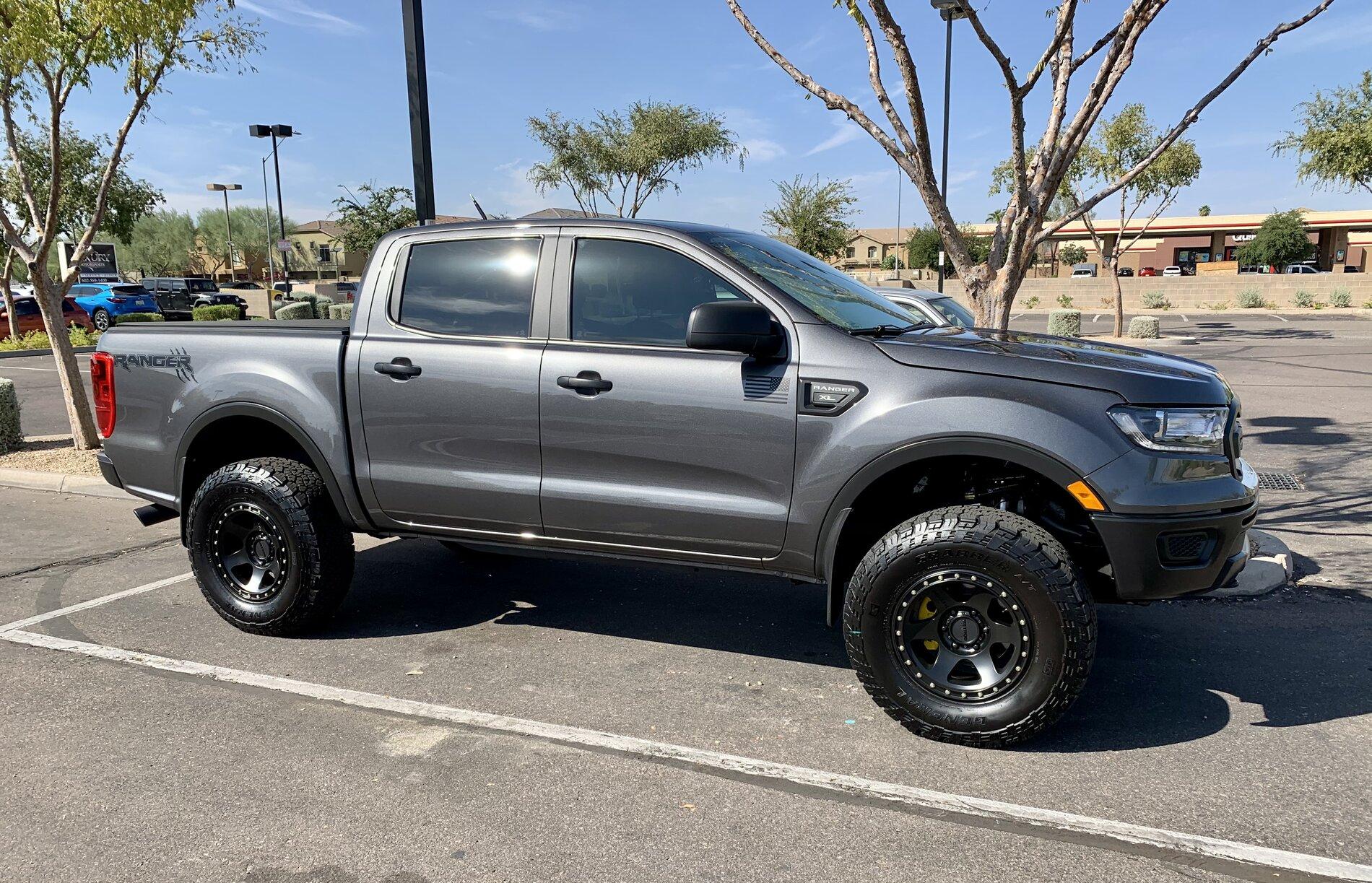

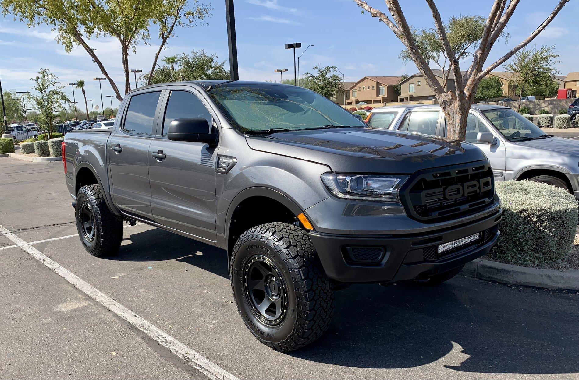

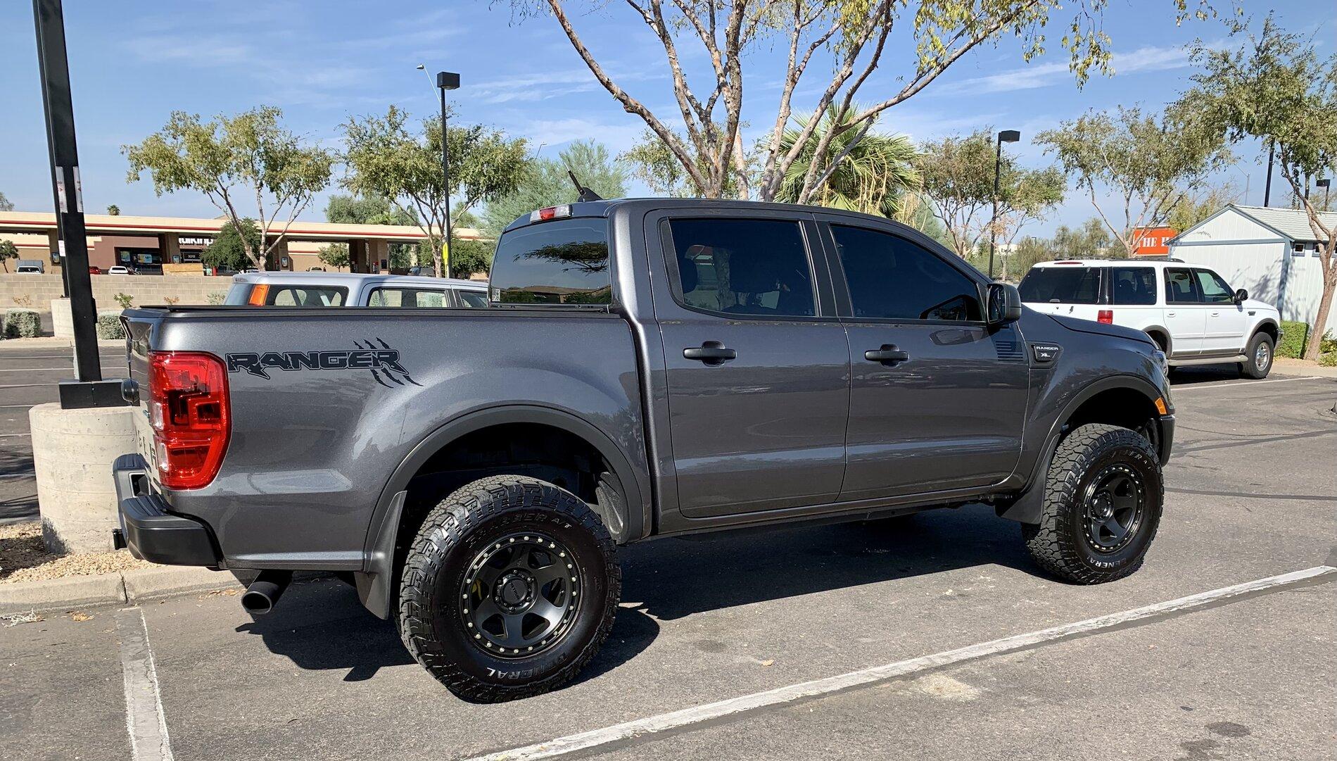

They do not lift,but allow you to later if you need.
‘Worked out perfect for me since I installed the Icon stage 2 suspension,and the rear shocks are on back order till late November.......it allowed me to set the front,and add an eibach 1” block to bring the back up,all while still running the rough country shocks which still ride and work amazing!
Now the truck sit with the stance I wanted.
