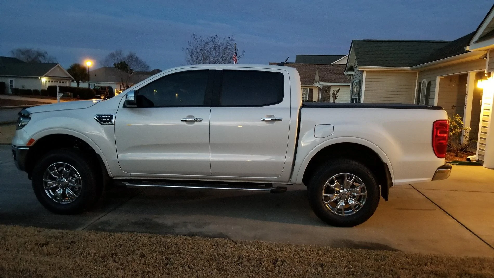

Same here Eibach Kit using stock springs. Lift 2.25 front None in back. The back is one inch higher than the front, Rake I can live with, I would install the Eibach again.
60
7,702
22,450
Look great! Did you add a block at the rear? Mine's pretty level (1/2 higher than front) with stock front springs set at the highest perch...I wanted to leave some rake so I don't go nose high when I'm weighted down on the bed or towing...

I did not install a block in the rear. IF I wanted to go three inches I would have installed a 1" block lift in the rear.
I used stock springs instead of the Eibach Springs. I did not want to raise the back another inch,
love your wheel and tire set up. I was going to install a more aggressive-looking tire but it's only a 2WD. I don't want it mistaken for a 4x4. Also I like that your Sport trim pieces are the exact match to the body paint as well the wheels. On any other color, I would prefer BLACK trim pieces rather than grey.,
