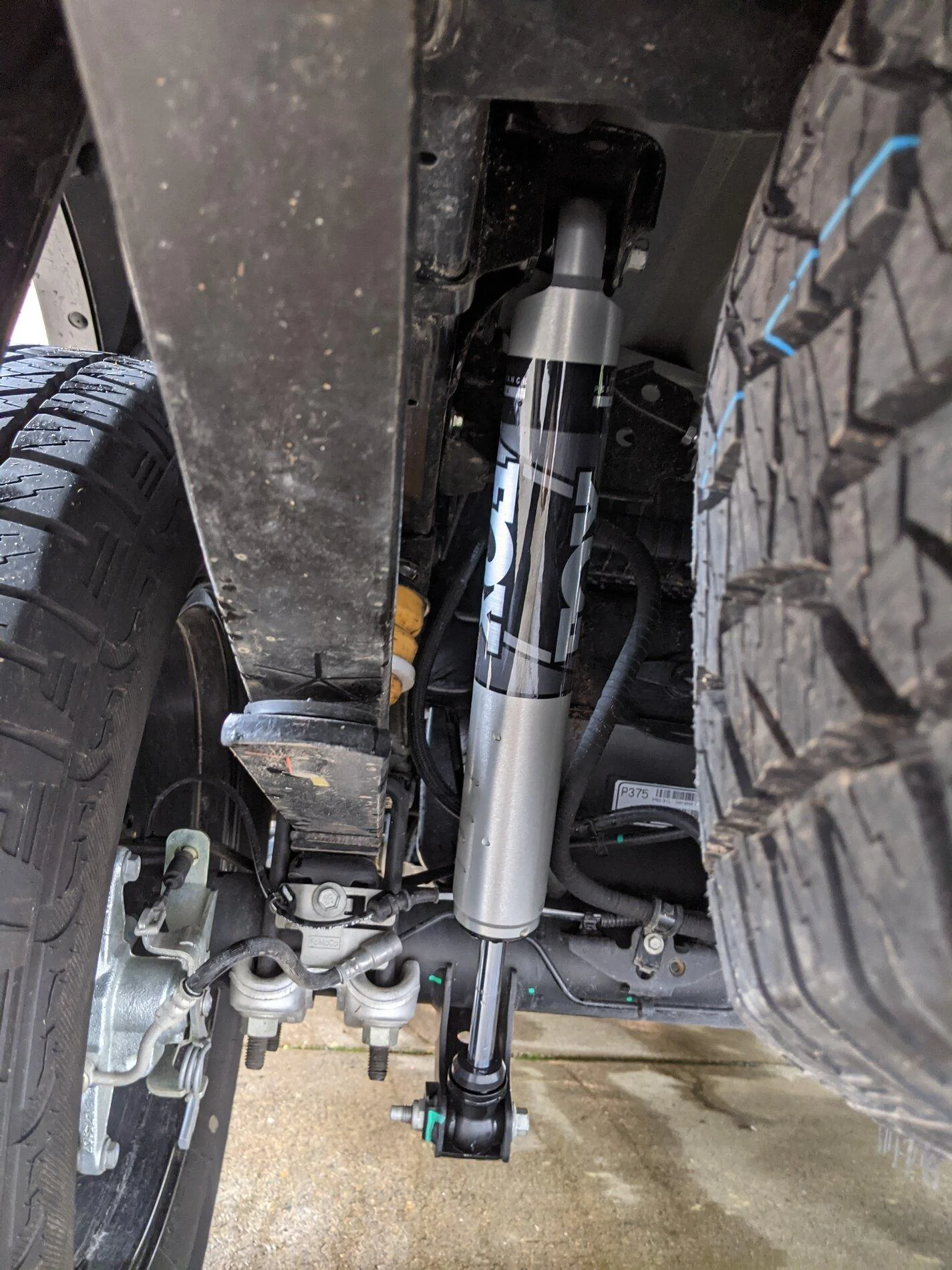

I installed Fox 2.0s on the rear of my FX4 today. Wow. I liked this truck before, but now I love it. The boaty floating and bounce are taken care of. I feel the truck should have come this way. The Foxes still provide a soft suspension, but the wallow and unsettledness are gone. The truck is more confident to drive. I went with the Foxes over the Eibachs because I do a lot of dirt forest road driving. The Bilsteins were a close option also. Easily the best bang for $300 on an vehicle upgrade I can recall. If you are on the fence, or feel your Ranger's handing could be better, do this. At $200-300 (depending on which shocks you get) this upgrade isn't something that your wife should get too upset about, lol ?
