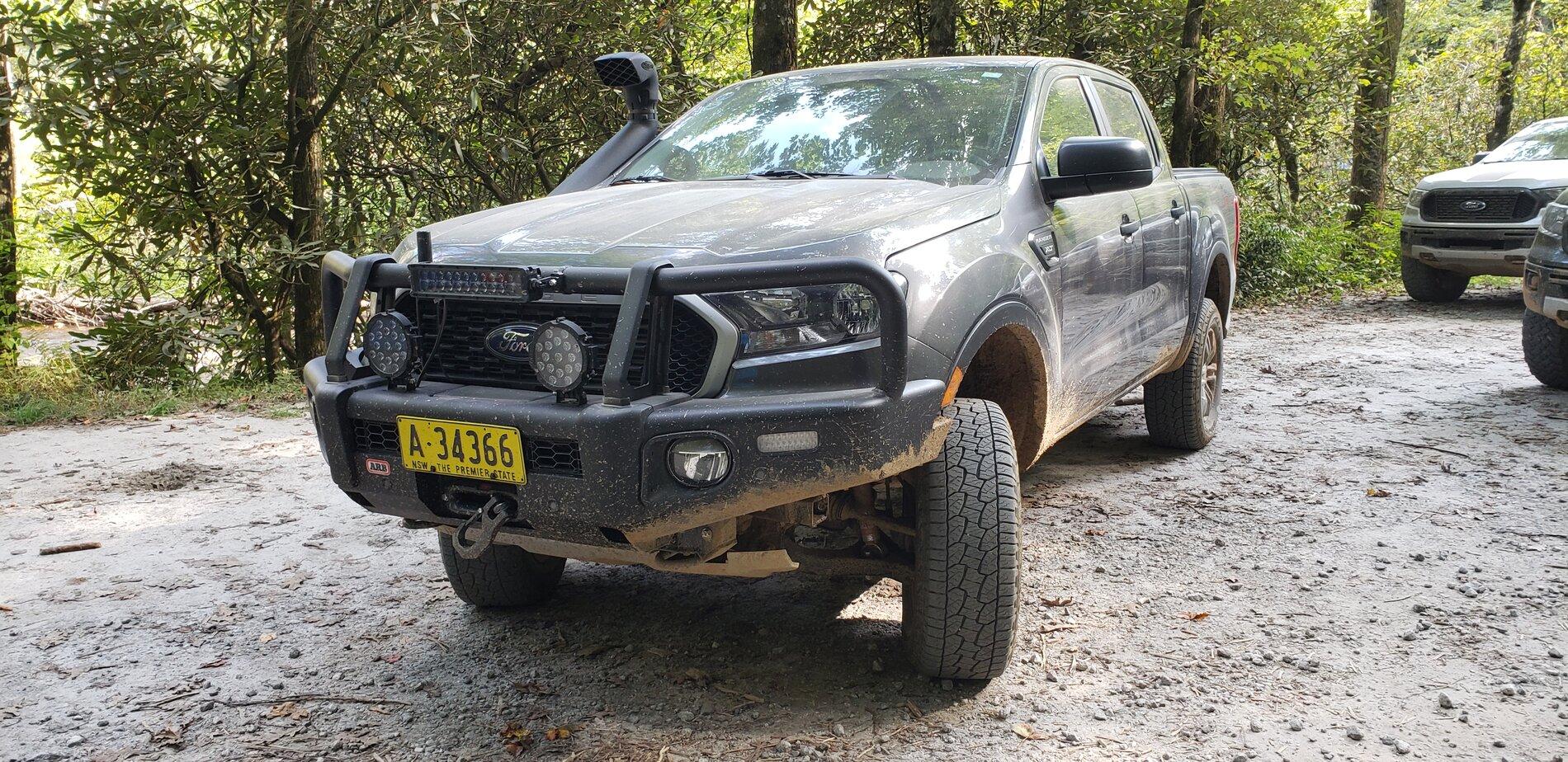

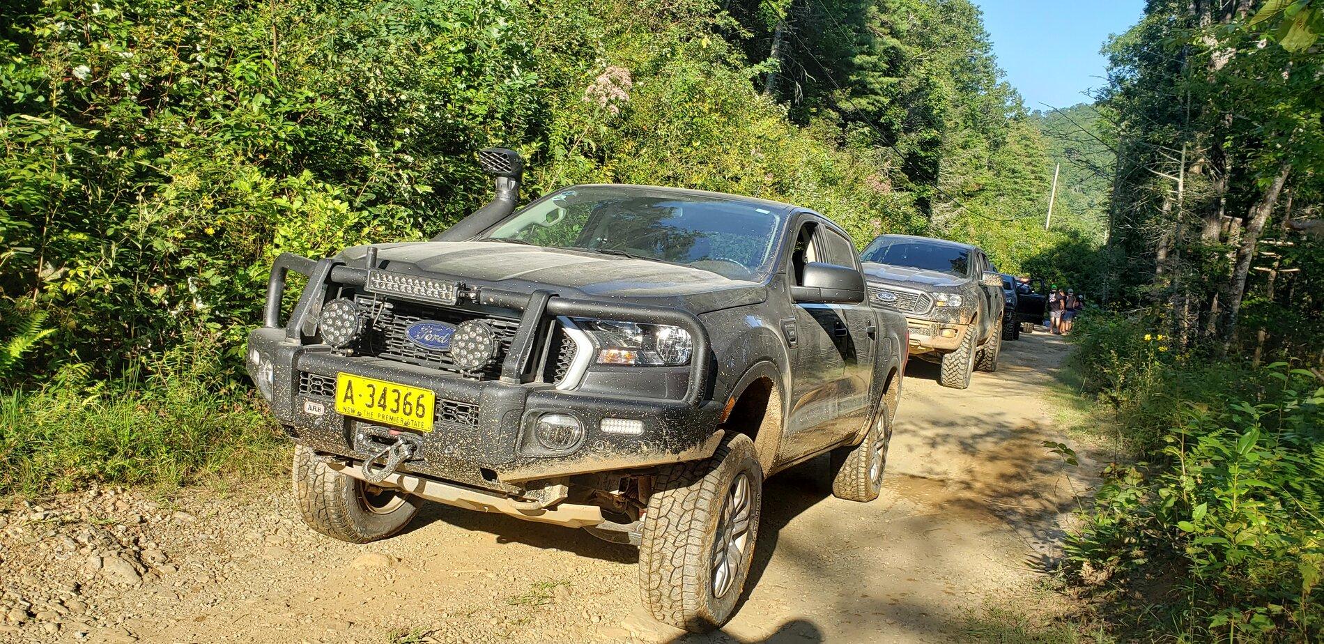

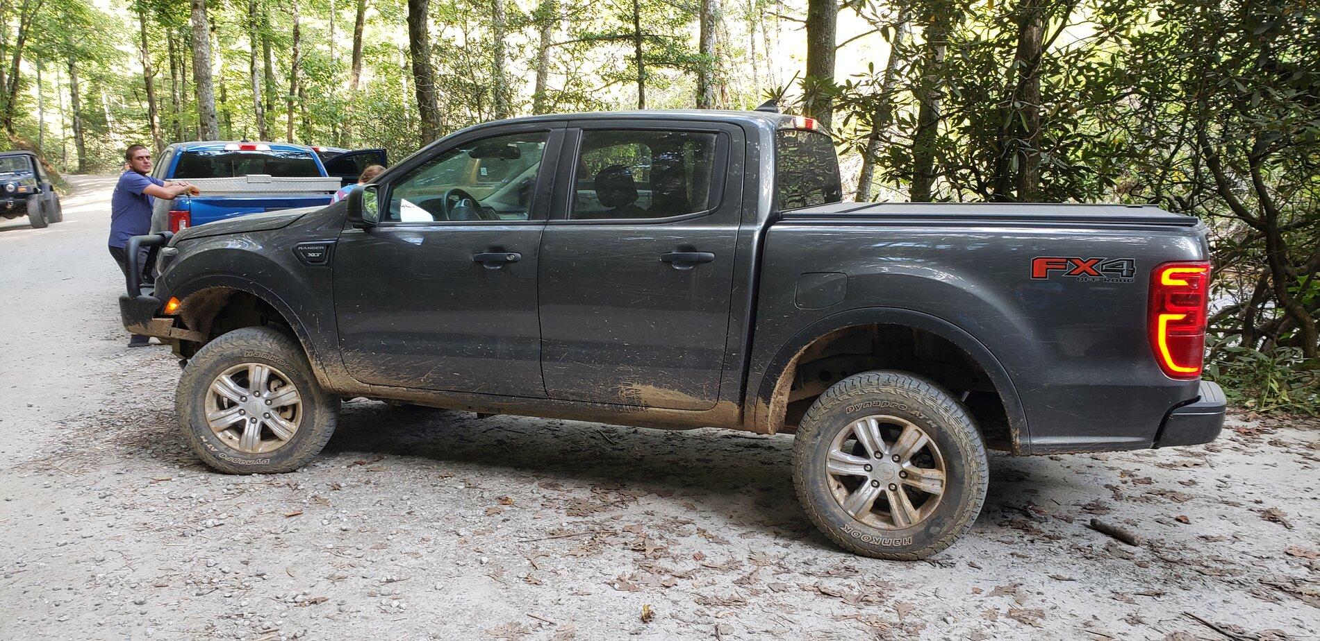

I put an Eibach kit on my truck set to 3.75" of lift on stock control arms. I have a heavy winch bumper installed, and it squashed it down about 1/4" to 1/2". I've been out on one off-road trip so far and everything worked flawlessly. But, I wasn't running high speed over obstacles. All the stuff we did was slow with spotters.

The Eibachs firmed up the ride PERFECTLY. With the stock FX4 shocks and struts, I actually hit an expansion strip on the interstate that caused some wild gyrations in my truck. On the same interstate, NOTHING. It feels sportscar firm when I need it to, and it's comfortable for cruising. The only thing I'm really lacking is bigger tires.
