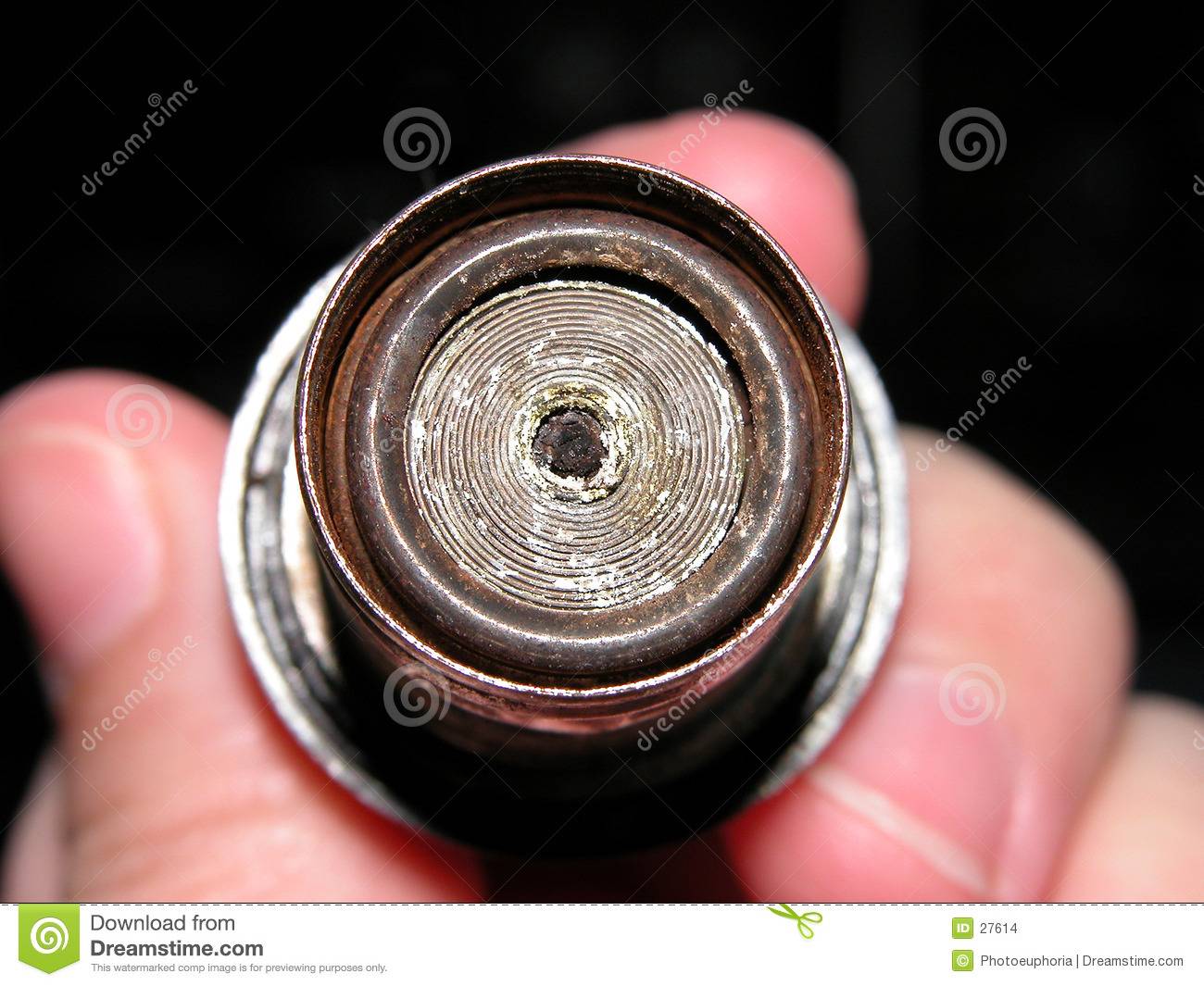

Hi Folks,
To throw out a couple more.... Wheel House... Folks call it a Wheel Well...nope...Wheel House. In the day, it was a Cigar Lighter. Not Cigarette Lighter. How about B&CPS? Brake and Clutch Pedal Support. Dash Panel...Not Firewall. Backlite...not Rear Window. Sidelite...not side window. Many more that may surface, but on my first Scotch tonight...
