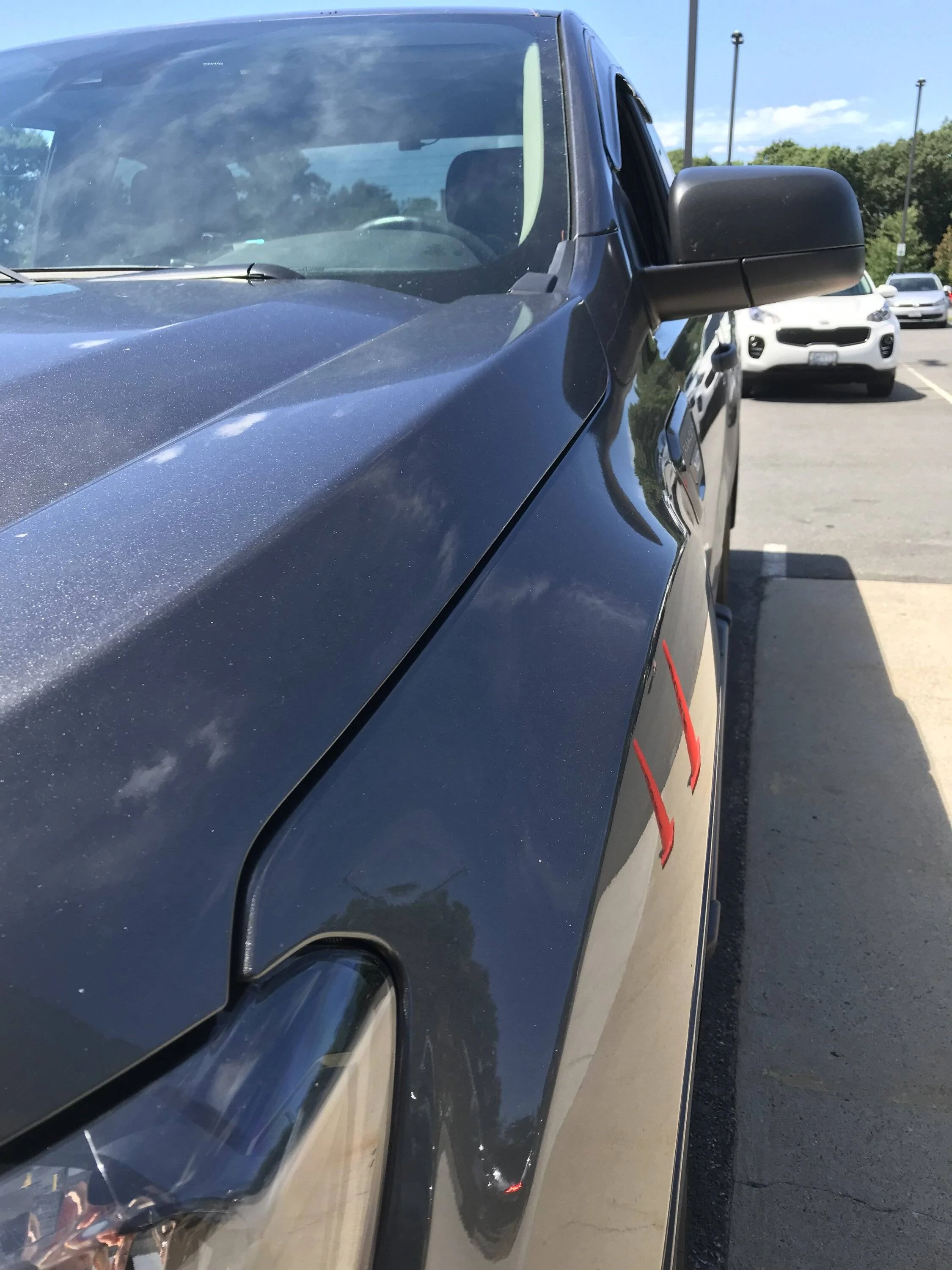

I searched the forum for "hood alignment" but nothing really came up but if it's been discussed, I apologize for asking here.
When eye balling my hood, I kinda thought the hood has a gap left and right sides where it overhangs just a tad. Didn't really bother me though, still doesn't, thought maybe I was being a tad critical. I work with my brother (we have a company manufacturing aluminum truck caps) so lots of new trucks in and out. I park my truck out front at work and my brother just came in and commented, "Did you ever notice the hood on your truck? Doesn't look like it fits right, looks like they made the hood too big." Has anyone else noticed that about their truck? Like I said, doesn't bother me to where I'd ever even ask the Ford service department about it, just curious.

Mine seems to overlap the fender by a small, but noticeable, amount on the passenger side. looks fine on the driver's side. Not worth taking back to have some service dept newbie really mess it up.

Many of us had the hood overhang fenders issue. They all come from the factory like that. Our fix is to loosen the bolts along the hood line. Have someone pull out on fender so you’re at the extreme of travel and then reseat the fasteners. Both sides and you get the two flush to each other or just a tad of overhang.

Great detective work! I will say that after the adjustment you can clearly see the paint mask from where the original fasten points were to where they are now! 3/8 to 1/2 an inch difference ?

Both of mine are the same way. Its hard to notice on the black Ranger. On my wifes cactus grey, it sticks out like sore thumb.

Mine does at times. I will see it in different light when looking at one side and it will appear to be a little to a lot on that side. Then go out in the garage the next day and check it out and it looks perfectly aligned. I quit doing the check, recheck routine after maybe 6-7 times.

Mine looked off on the driver side.
Told the dealer.
Now it’s off on the passenger side.
I gave up
I know what you mean, now that my brother mentioned it, I keep looking at the hood every time I walk by the truck. I do believe my passenger side looks more flush than the driver's side. I now see the front of the hood on the driver's side sits a little lower. I'm going to twist that little hood bumper and see if it improves.
