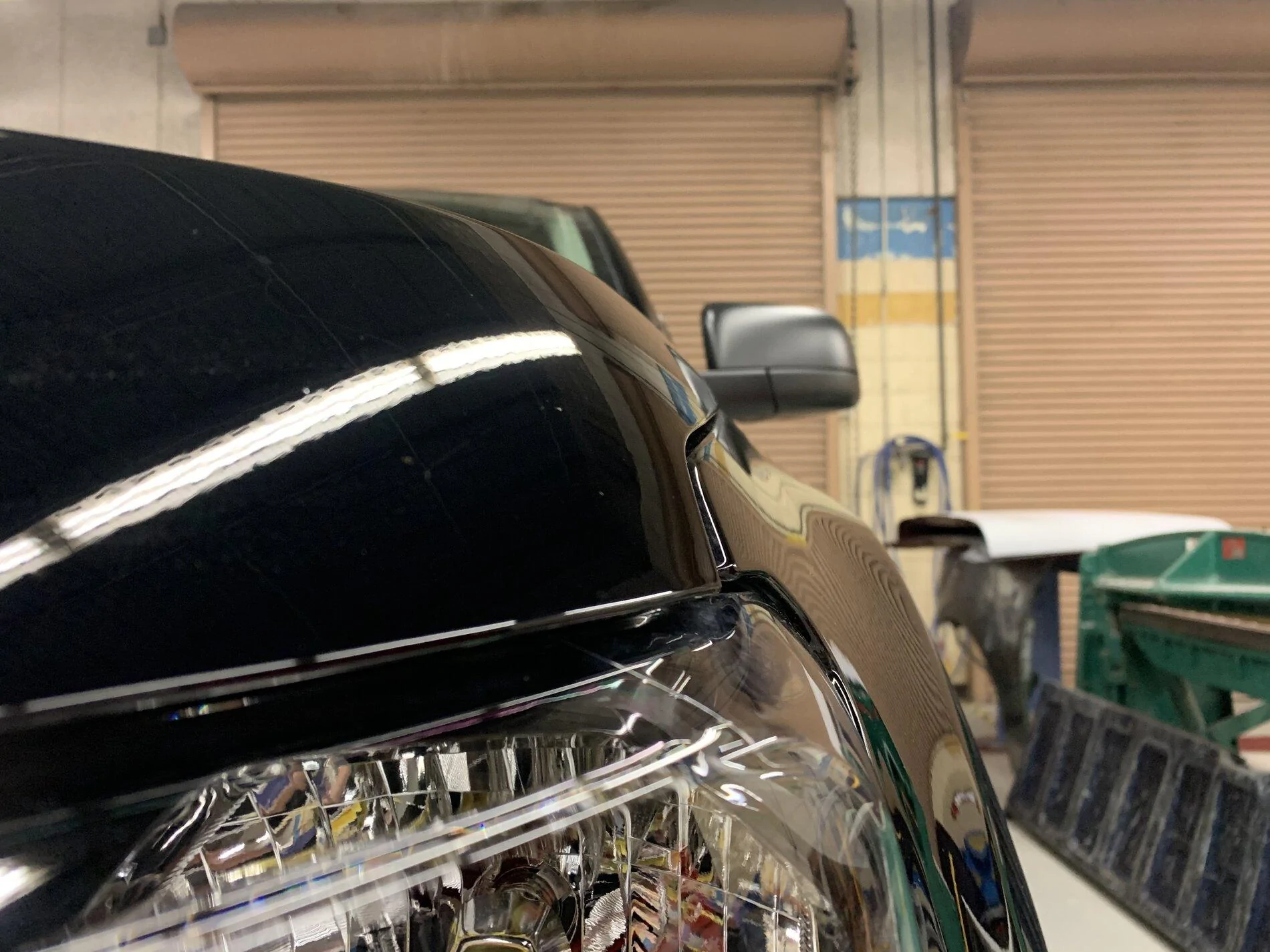

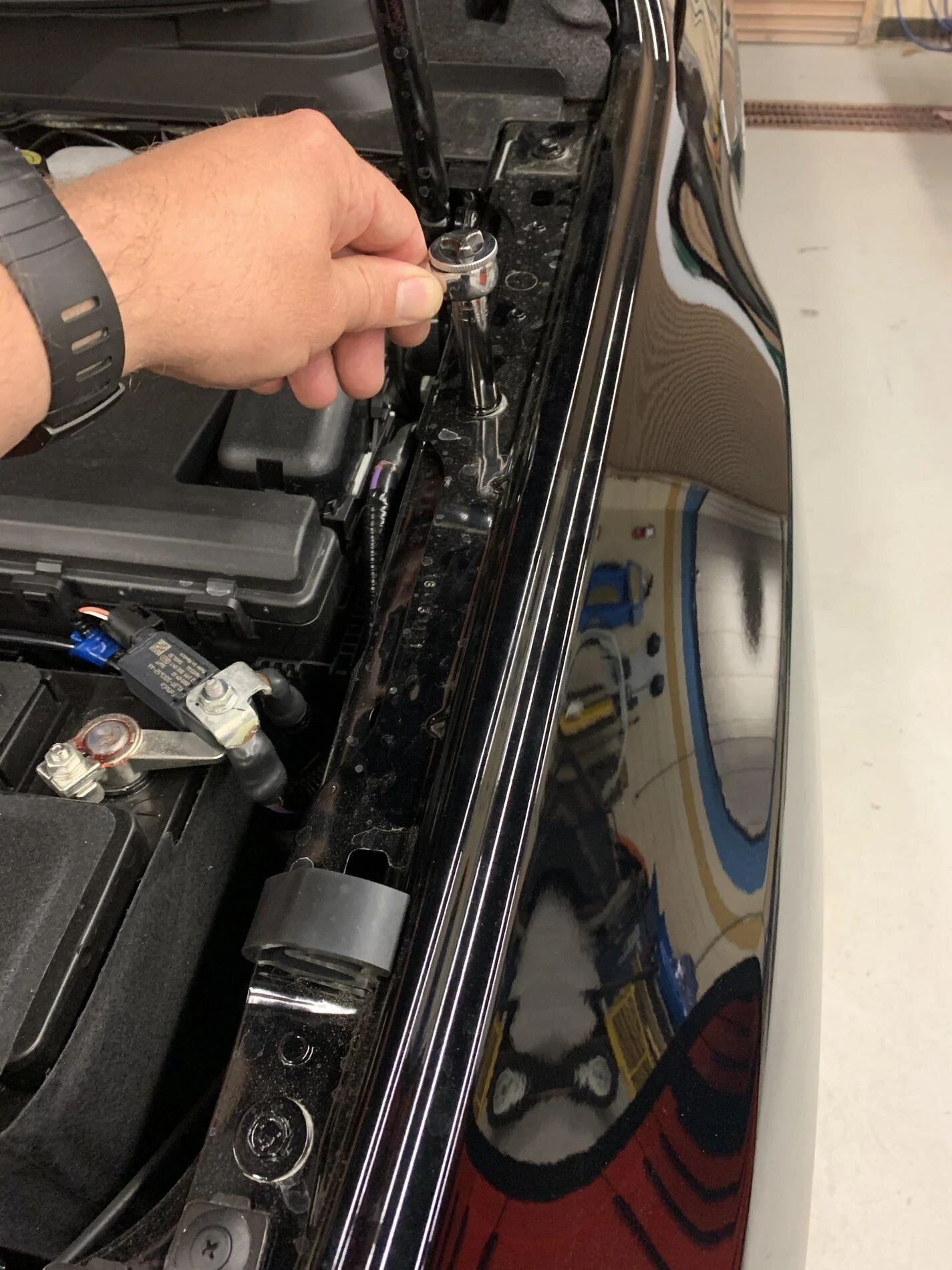

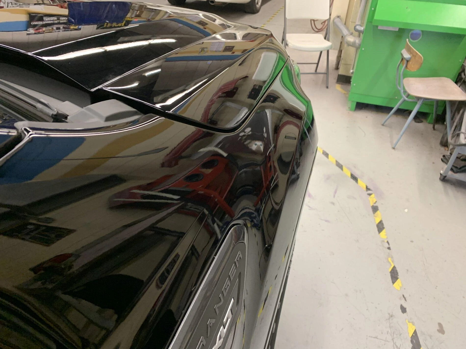

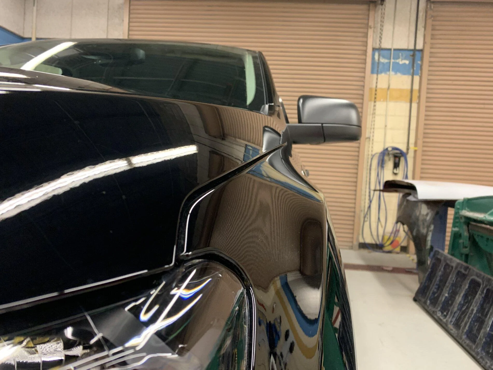

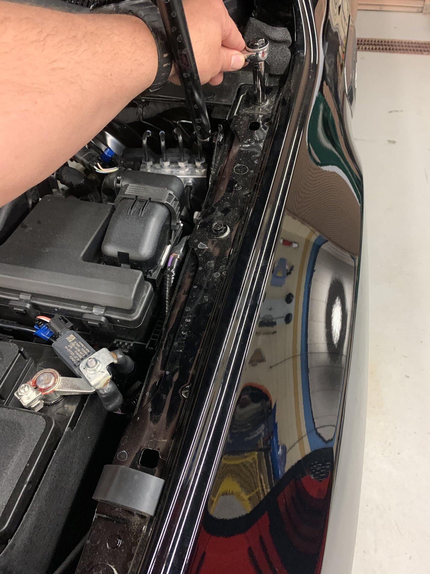

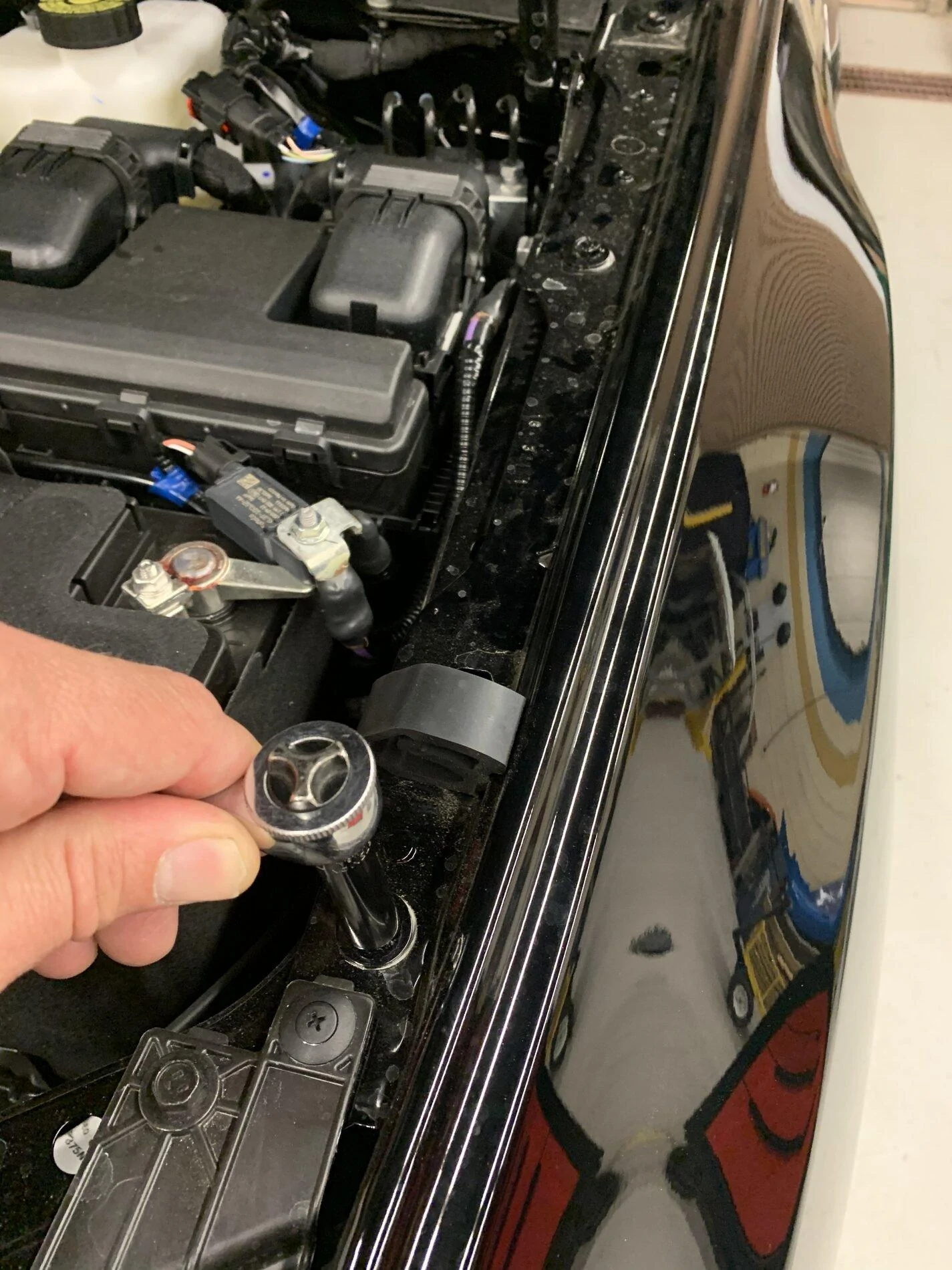

So I plunged today and adjusted both mine. They’re both pulled full out except slight amount on nose and hood still overhangs slightly but a far improvement over what it was.
My drivers side hood bumper has 1/4 hard felt furniture pad as a shim to get that true.
I know, I know...

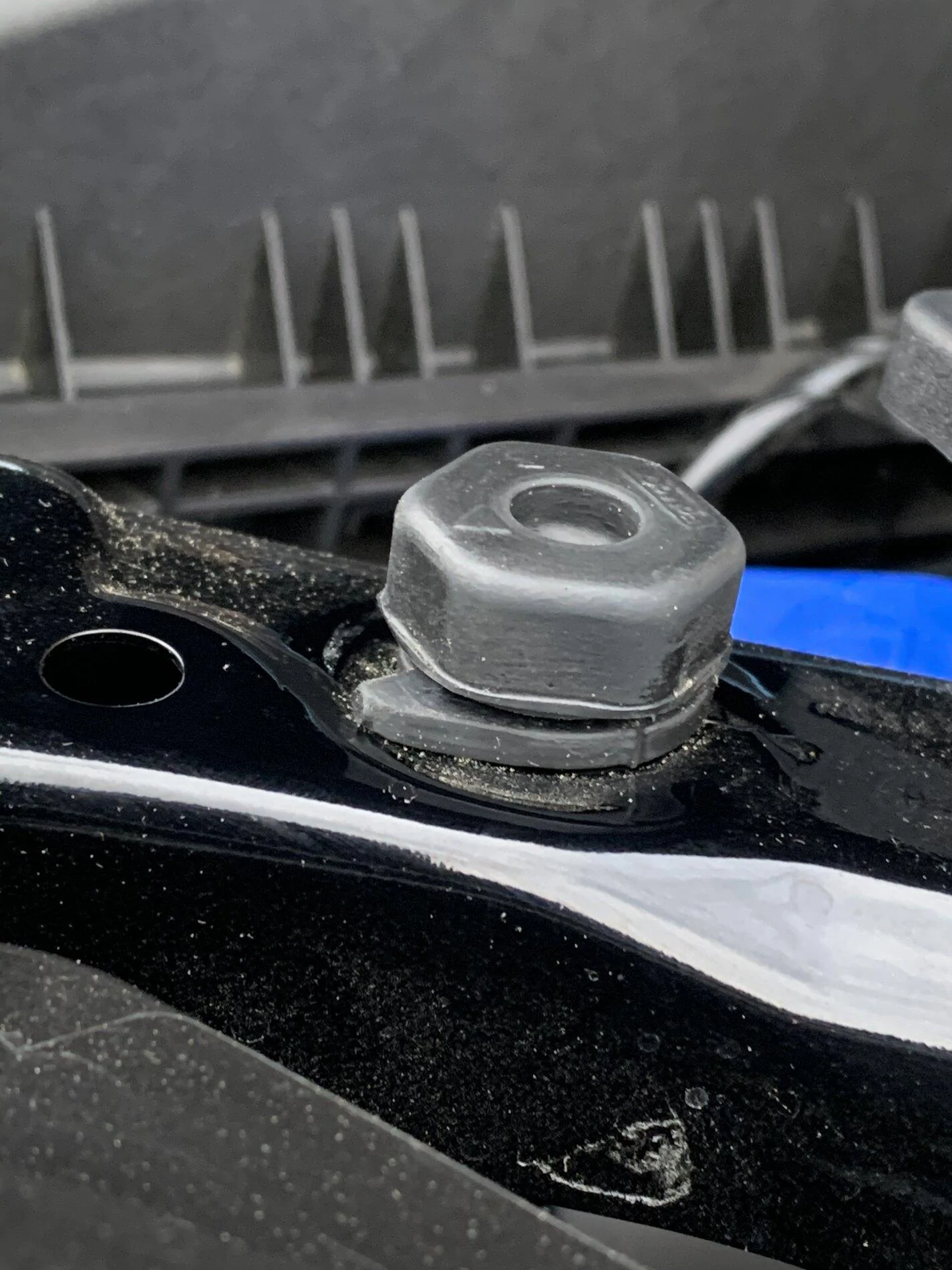

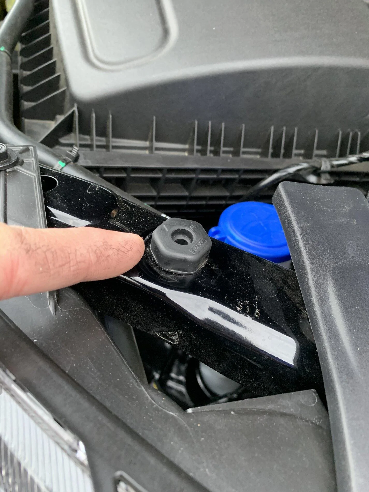

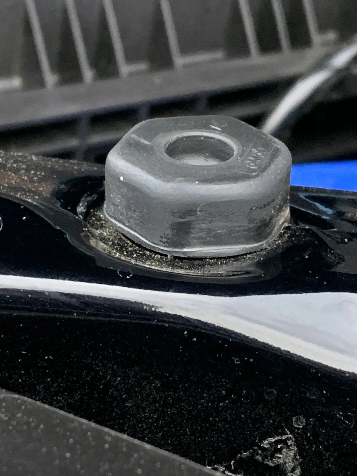

Good deal. Is the hood bumper unscrewed all the way? If you don’t know, lefty loosie raises it up and righty tighty lowers it down.
Not like the days of old. Non adjustable and haven’t figured how to get it apart.
Seriously? Egg on my face then. I assumed they adjusted lol.
