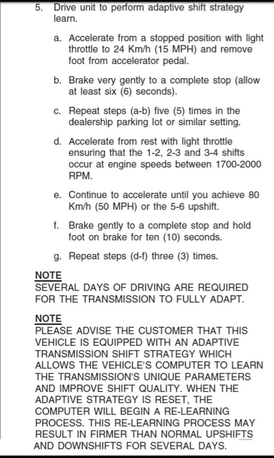

FWIW, the 10 speed tranny DOES NOT adapt to the drivers driving style. It adapts to how to it's own unique characteristics. Most automatics since the early 2000s have had this type adapting algorithm.
Below is the learn process for the tranny in the FSM.

I have seen this, and although what it says make sense and would be great, you WILL notice a difference even after it has a few miles on it if your driving style changes significantly. Such as stop and go traffic, etc. and it will cause it to have fits again when you go back to your normal driving style and often take a very long time to correct and may even need a TCU adaptive reset to correct. Many people can attest to this and if you are cognizant of how you drive while it is learning it will help. Some people can even see a reduction in shift quality if they go back and forth between the different modes such as sport, etc. I have never had that issue since tuning, but I can imagine it is frustrating.
Disagree if you want, but I have tested it and it does.
