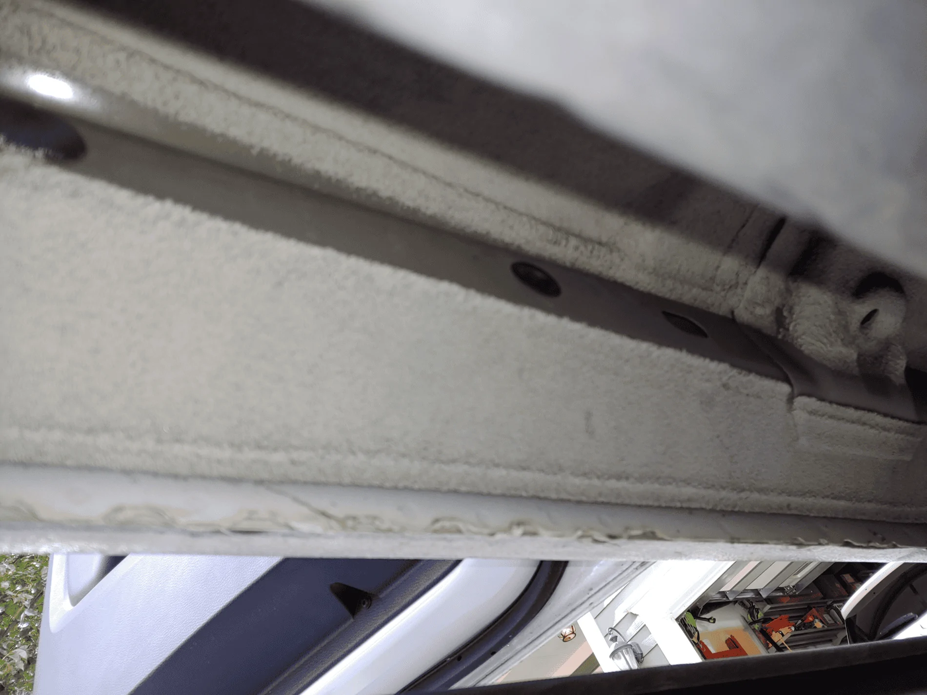

Nice hot day here in the Central Valley (CA) so while parked in the driveway nose down I squirted water in the rocker panel holes with a syringe. Water drips out small holes at the front. Park nose up and it drip out small holes at the rear.
Also seems to be a large opening to the rocker panel area where the front fender meets the Lower door opening…easy to see when the front door is open.
I crawled under the rig and guess what I found…even more holes. Some seem to lead to the rocker panel area so I’m not sure if they are also missing plugs or if plugs were left off intentionally to facilitate drainage or airflow of some sort.

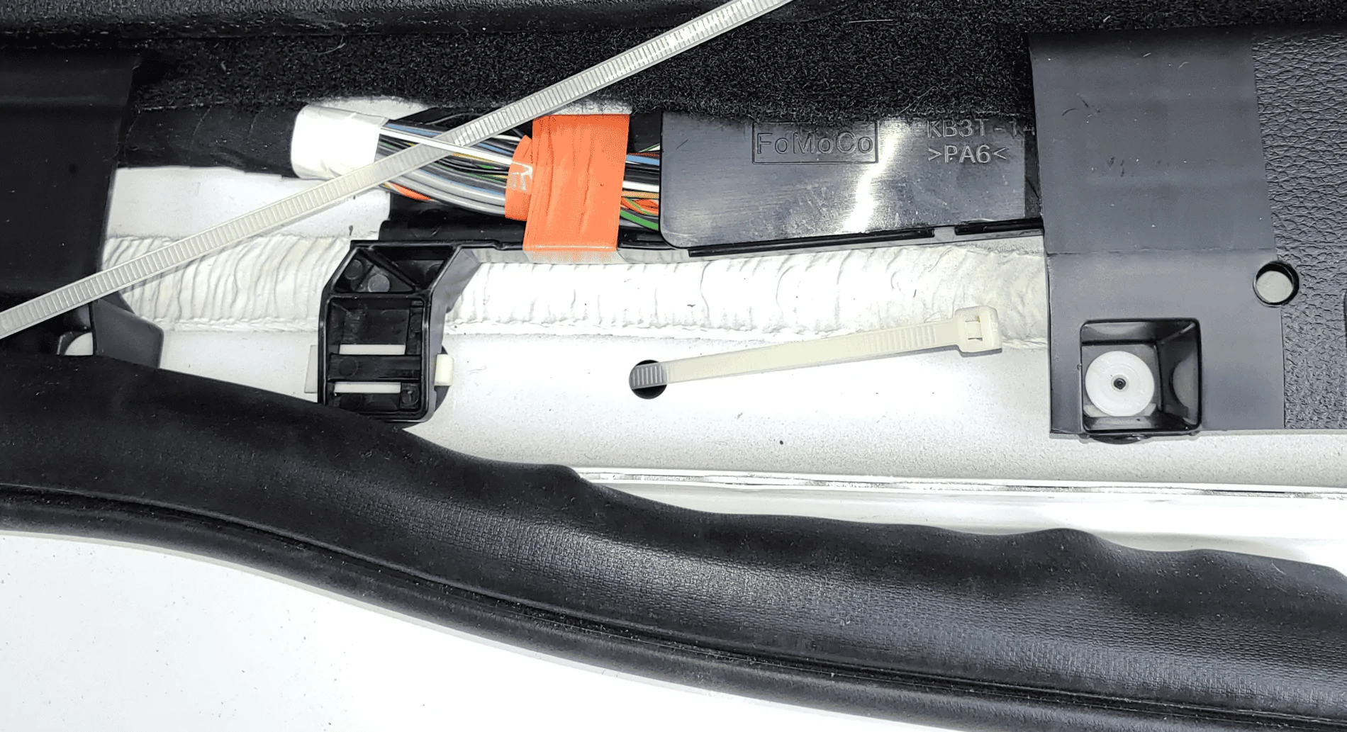

I was going to add a cargo light trigger wire to turn my bed lights on and pulled off the rear door floor trim to get a look at the harness and possible routing paths. What I found was that the clips(white with a black seal) that break really easily on the trim piece are a direct path to the rocker cavity. So heads up if you broke one you should replace or at least tape over the hole!
Back to the holes - when I looked under the truck I notice the holes above on the inner vertical wall of the rocker panel and the fact that is has quite a few holes! Again see above pic and below are the ones I took. So even if you do have the plugs in the bottom of on the rocker panel (oh - yes I do - 2019) there are a ton of other places for water to get in (and out). I would almost say (for the holes in question) that,as this is a horizontal surface, it would be better w/o. Water is going to get in so why not make it easier to get out. Yeah I know mud may be an issue, but could periodically clean the area. Its seems that cavity has a lot of holes, even what appear to be drainage holes - squarish cut outs on either end (also pointed out by ksuds49) so its probably not possible to plug them all.

Here are the pics I took.
Looking fwd under LH side, an oval cap and round cap followed by a round hole. IRCC, there were more unplugged than plugged in other areas, I was mainly looking here for the wire I want to run.
From inside
lower ti-wrap is in the clip hole, direct path to the rocker cavity

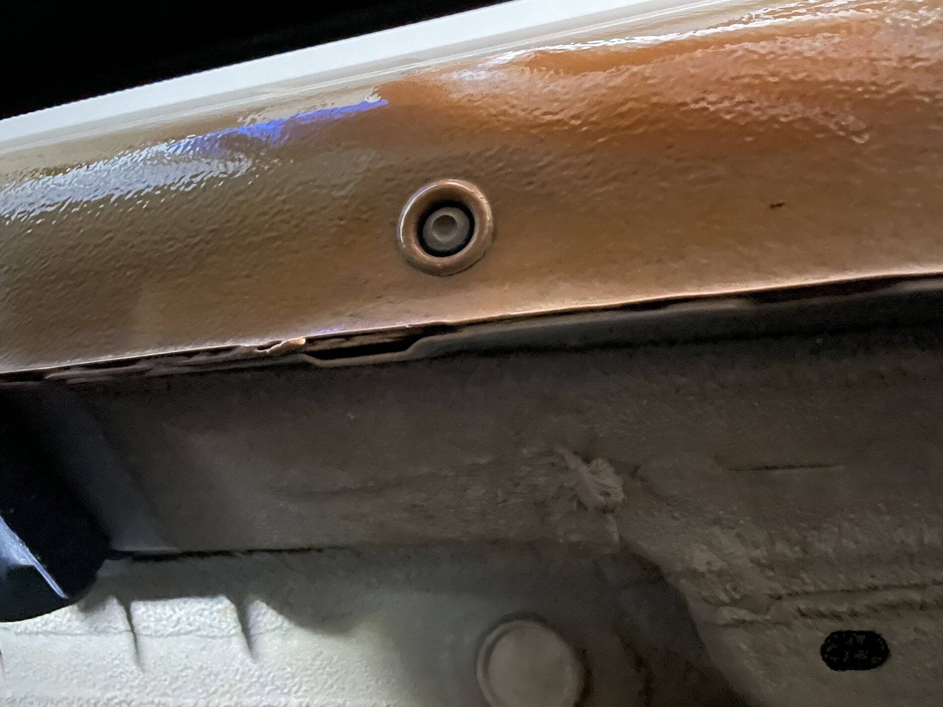

This is the size someone on the forum who had plugged the holes on his rocker panels said to use. I ordered yesterday, but haven't received yet.
Plastic Plugs
Rubber Plugs
Note the plastic plugs are less expensive. Rubber version only has 10 in a pack, so you would need to buy 2 packs. Plastic has 25 in a pack.
