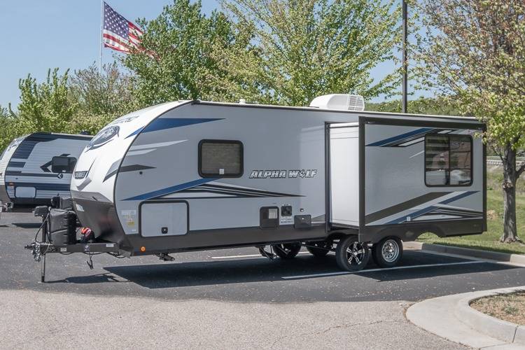

Now, my better half found this which she likes alot, which is traditional, and weighs in at 5700 lbs.
So, even loaded it shouldn't max out the 7500 lb limit.
Whatever makes her happy.

No trying to start a fight or piss in your Wheaties but it might help to take a look at your numbers a little better. Mainly the GCWR which for your truck is 12,150. That being said with the curb weight of 4,232 that only leaves 418 pounds to play with before you are overweight. Just because they say that you can tow 7500 does not mean that you should. Also keep in mind it isn't about what the truck can move, it is about what the load does to the truck when you go to stop. These trucks do not have much weight behind them to safely tow heavy weights. Also Sway is going to be a major issue with cross winds. You would do better to tow the truck with a motorhome before you attempt to tow a RV with this truck.

Your figures are off...
Figures and ### rough average...
Empty weight of Ranger.....4145 lbs
Payload for my ranger (what it can carry)...1860 lbs
Total Gross Vehicle Weight Rating....6005 lbs
Empty weight of 4145, plus maybe 600 lbs for me, wife, 2 dogs, some add ons, trailer hitch, comes to 4745 lbs.
Add 650 lbs for hitch weight of trailer...5395 lbs...round it off to 5400 and throw in 100 lbs for some "stuff", comes to 5500 lbs.
Gross combined Weight Rating is 12,150. So, subtract 5500 lbs from that and it leaves me with 6600 lbs that I can tow under Ford's weight rating.
Trailers wife is looking at run 5500-5800 lbs, so I'm still on the plus side.

The numbers I provided are directly from the FORD specifications and Towing Guides for the 2020 Ranger. Obviously there will be slight variation based on specific vehicles and how they are optioned out. I was just bringing to light the fact that if you go up to the quoted 7500 pound trailer weight it is incredibly easy to be overweight and not realize it.

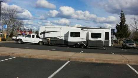

I'm thinking about something along the lines as this....figure as long as the rear bumper doesn't drag I'll be OK....
But maybe the rear bumper dragging wouldn't be a bad idea....added friction will help me stop !!!
