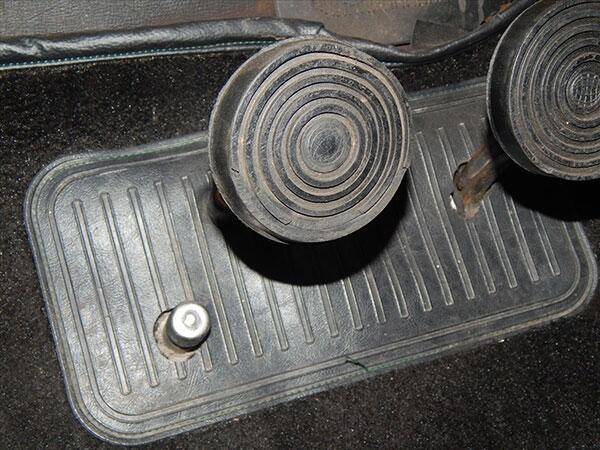

When I built my 33 Hot Rod the Ididit column I used didn't have a high/low switch in the column and they didn't offer a retrofit. I wound up picking up a floor switch at O'Reilly's. The foot box is small in the 33 and I had to mount it under the clutch pedal. That was really inconvenient so I put a switch on the dash but I really wish I could get an integrated switch for the column.
The foot switch on my 68 Barracuda works well but you don't have the flash option.

It's not a simple switch - Power & Ground to switch Low to High Beams.
It's an input signal on the Can Bus; it's looking for a momentary pulse (signal) along the bus
SCCM to GWM via (HS-Can 2) then GWM to BCM via (HS-Can 1)
It is wired this way due to Auto (High-Beam) feature & Auto-Lamps
Not a problem... just go old school and put a foot switch on the floor to the far left of the brake peddle... step on it, it sends the required pulse, everybody lives happily ever after... :>)
Foot switch was standard on US cars till... humm late '70s/early '80s

My 68 Barracuda has two buttons on the floor; one for high/low beams and the other for the windshield washer.
