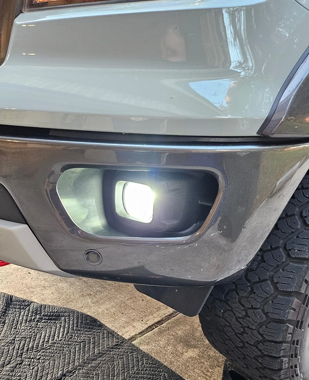

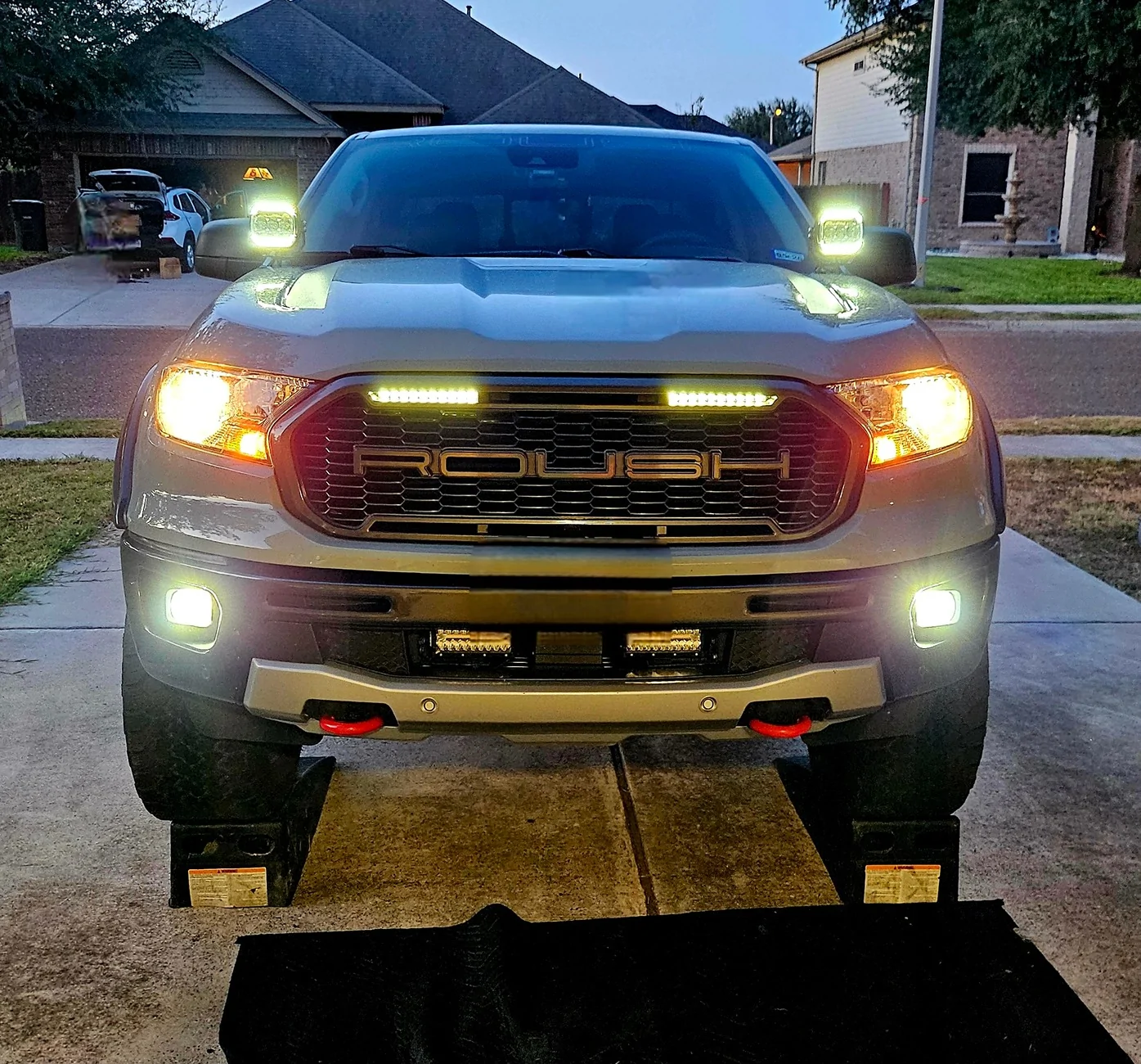

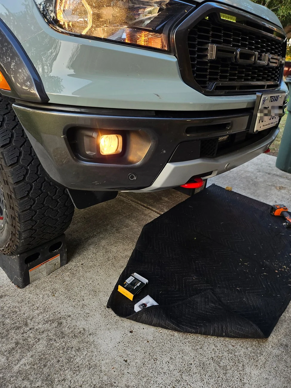

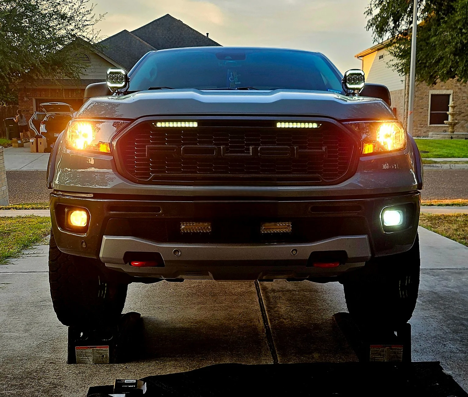

I would have swapped out my headlight bulbs too but,,, I have other plans for my headlights...
I'm trying to get this model installed today. I currently have nicer adjustable LED bulbs in the halogen housing today(aimed lower for other drivers), but I noticed a issue where low beam on one side occasionally cutting out on long roadtrip when used with the high beam. Hoping everything goes smoothly, as it was a open box buy from that Headlight Revolution store.
