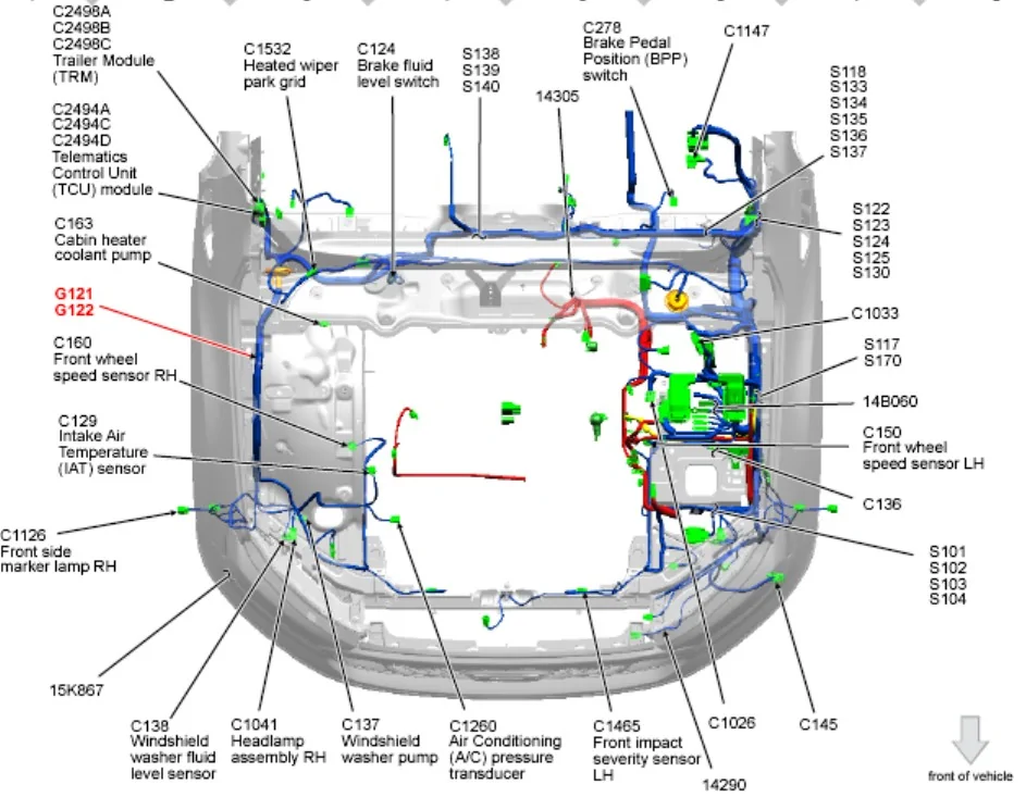

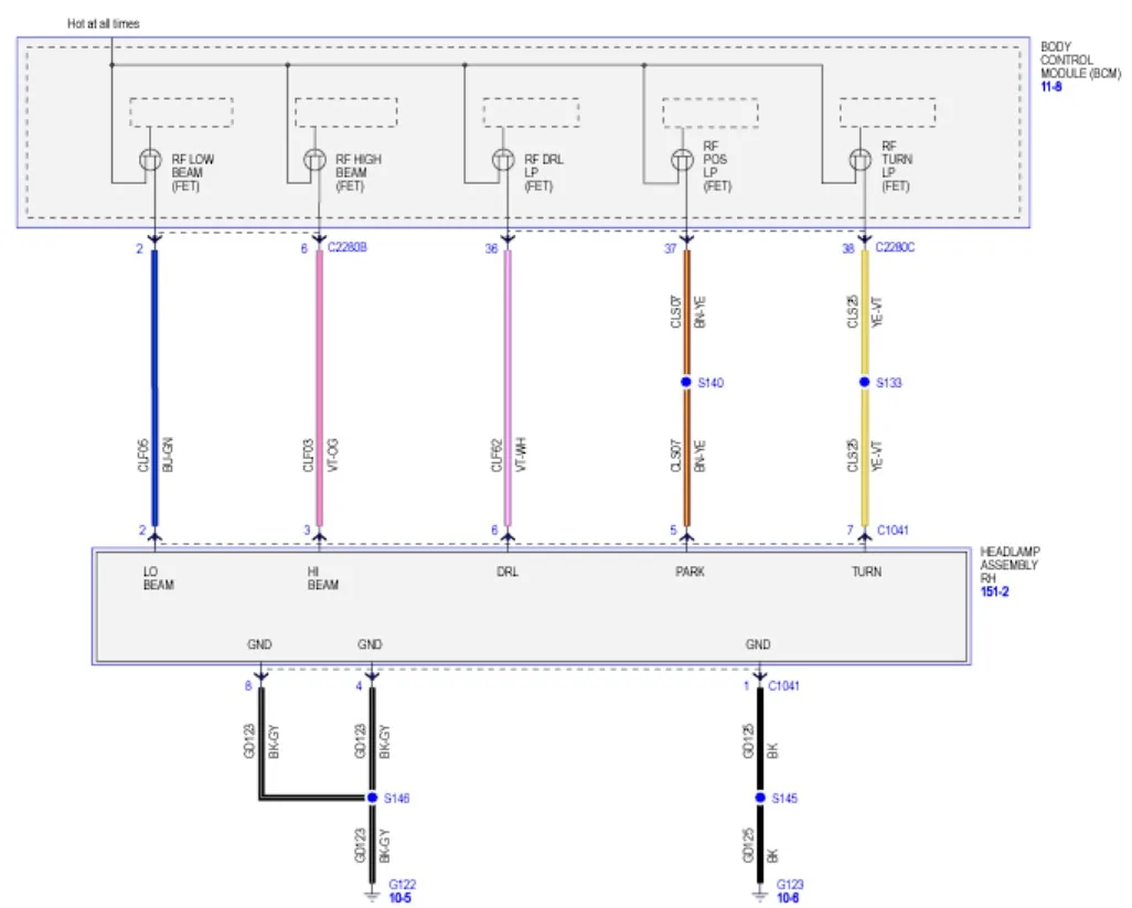

Here is the wiring diagram for the right side headlight. Check ground G122 for a good connection. Check connector C1041 at the headlight. Also check for any DTCs with a code scanner.

Thks. Found a broke ground wire. Hopefully this will fix it. Started to repair but had dead battery.

Good find - G123 is for the Low / High Beams
