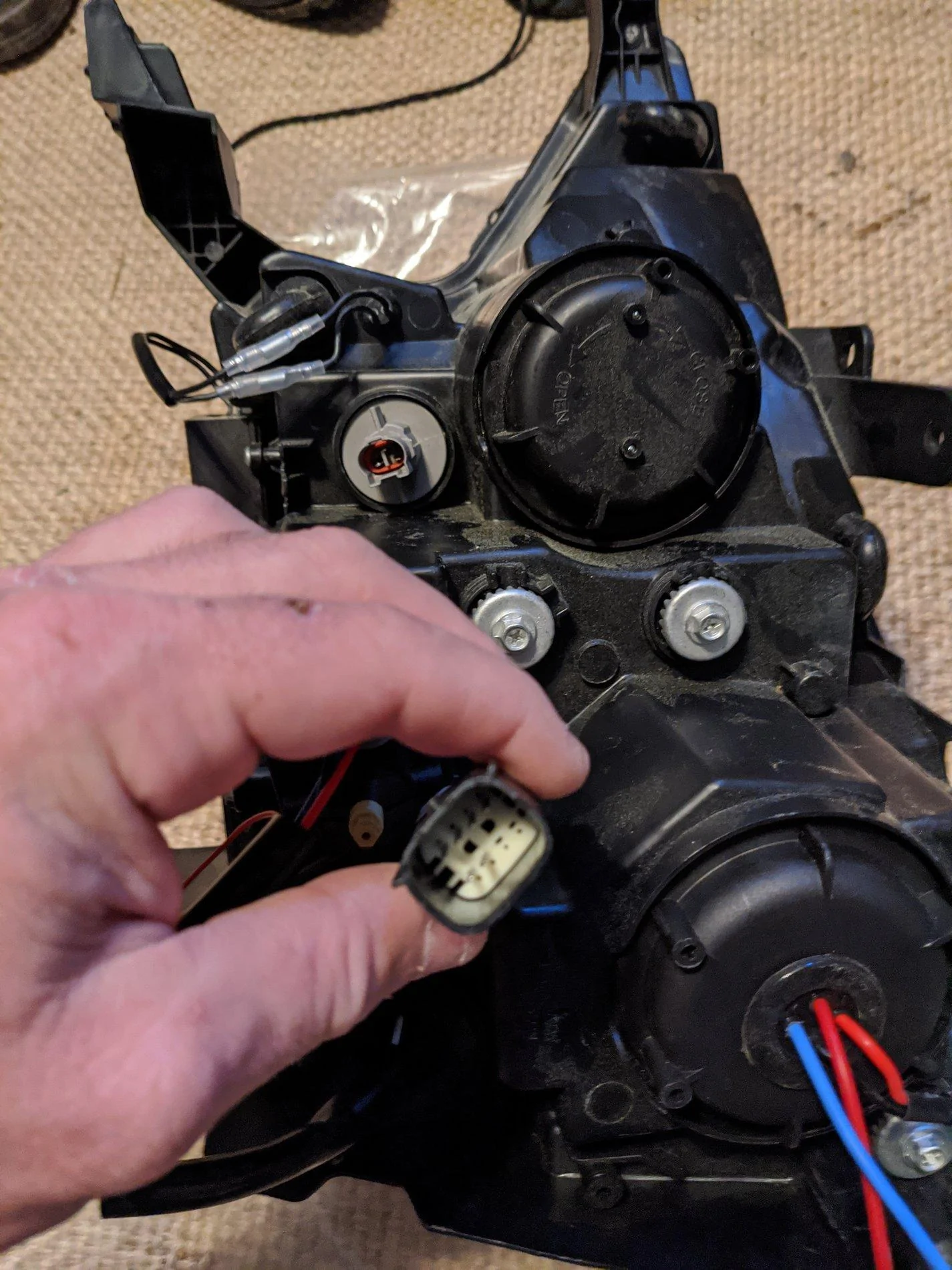

These are not made by ford and are aftermarket so a mustang wiring diagram will not help. I have requested that info from the manufacturing but to no avail .

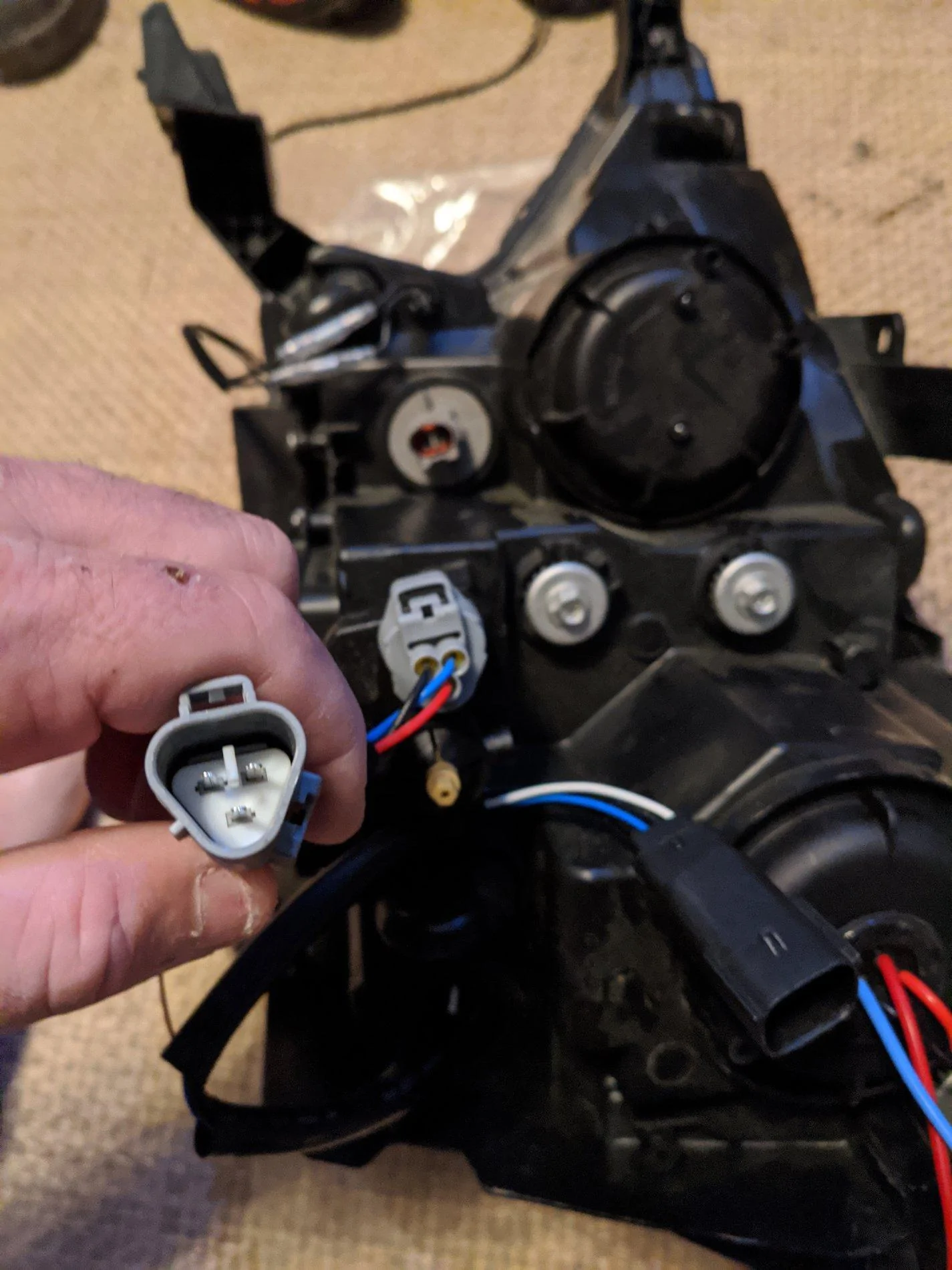

No sir they are made for the ranger. just mimicking the mustangs headlights. they have the right square connector but have 2 additional ones . One is a 3 pin triangle and the other is a 2 pin oval

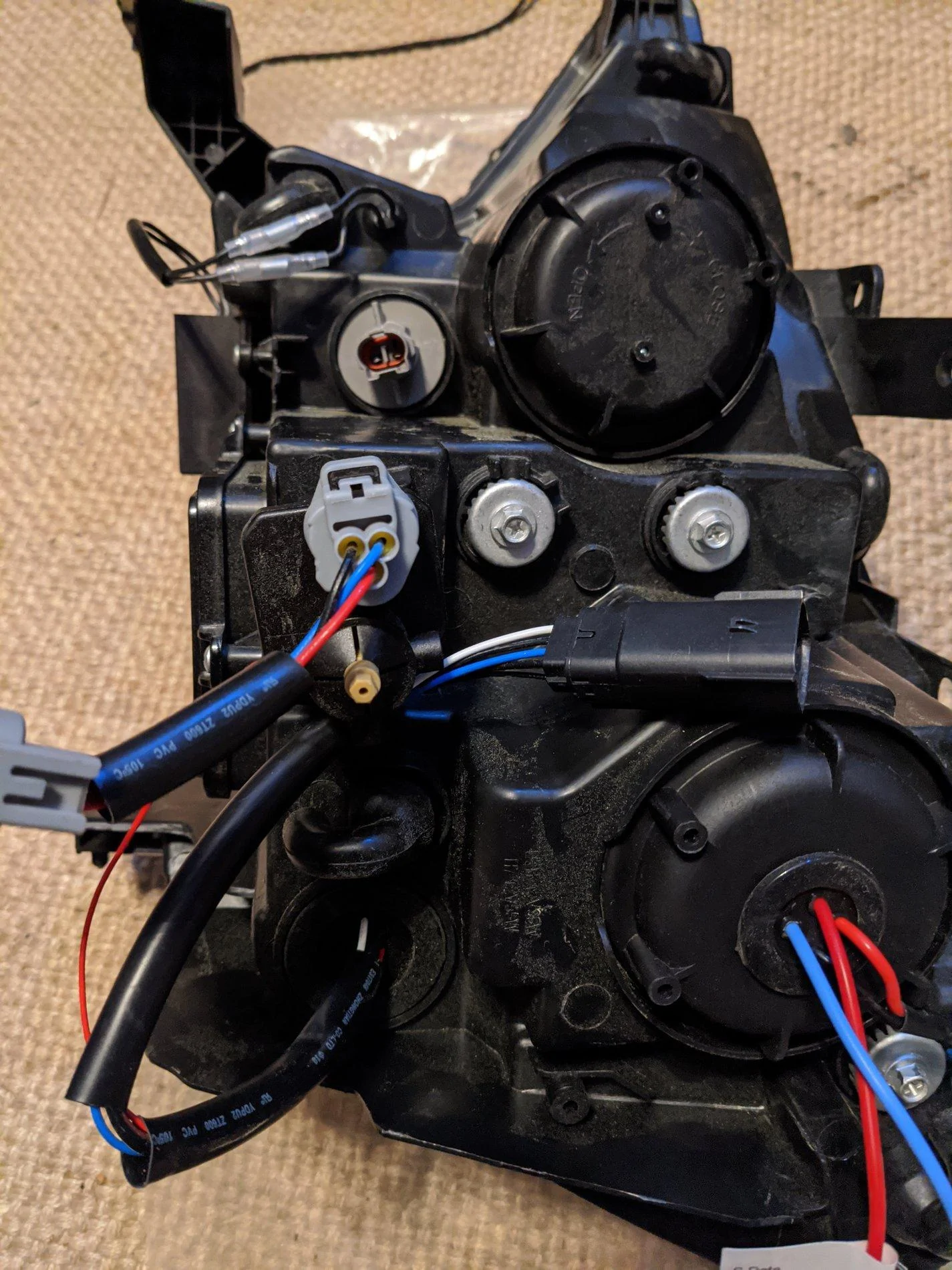

I see, so it seems one connector is for the the DRLs, one is for the turn signal and the other is the headlight low/high beam.
Do you mind sharing where you got them from? I maybe inclined to obtain a set and find out how to get them to work. It would be a matter of bench testing them to see what each wire is and then determining which wires need to be tapped from the Ranger.

I have the "wiring" diagram from the mustang style lights I bought from Australia. It might be helpful to your situation. Off the vehicle, I would hook it to a 12vdc power source to confirm the wiring.
