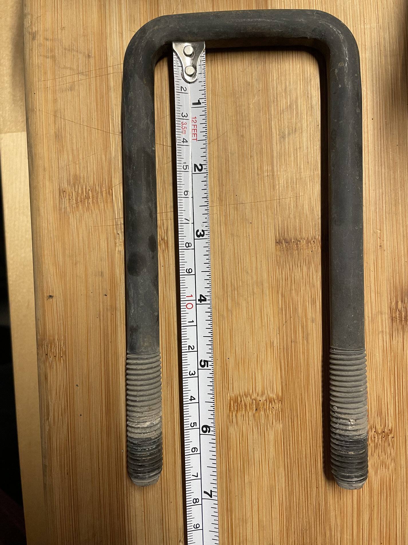

I used the stock bump stop, I did shorten it a little bit, but my truck is 1.5" lower in the back, the Tremor bump stop did not have the white plastic ring though.

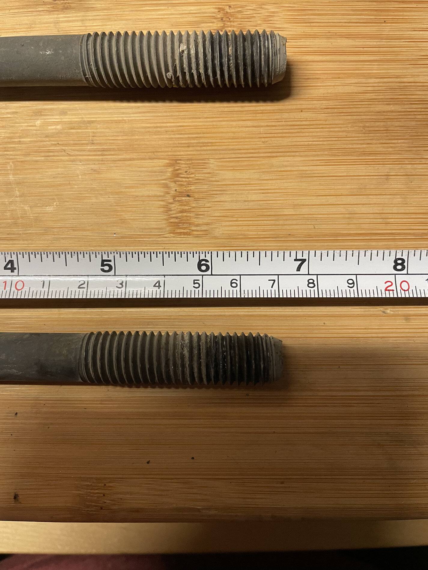

Hey Doug,
Here is the link for the U-bolts i bought and used.
https://www.roughcountry.com/u-bolt-kit-7609.html
I just noticed they sell a 7.75 inch length. I can't garentee that they will fit. Fitzmotor measured his Tremor U-bolts at 7 3/8 inch. He was able to use his u-bolts but i know he removed a leaf from the global set. I'm not sure if he tried installing the full 5 leafs with the stock u-bolts. If he did. then the 7.75 u-bolt should work.
https://www.roughcountry.com/u-bolt-kit-7604.html
As for the bushing kit. If you go into ebay and search SuperPro 2019 ford ranger. You will see a listing that reads New *SuperPro* Leaf Spring Bush Kit for Ford Australia Ranger PX ll-Rear. For some reason the part number does not show in the post. But if you google SuperPro plus the part number you will see it. Also its cheaper to buy from Austrailia then the UK.
Part number kit168K-1. SuperPro Also sells a kit that comes with grease-able shackles. It is a little more expensive.
Just for reference, the stock u-bolts measure in at 6 3/4 inch.

Hey Doug,
Perfect. Obviously some UBolts will be needed. I'll look into the bushings and decide on them.
@Fitzmotor did the Tremor U bolts work on the full spring pack, or only with one leaf removed??

The Tremor U bolts will work with the full spring pack with at least 1/2 of an inch to spare maybe more and that's with a 2* shim in there.
Excellent. I'll order the 7.75 inch ones.
