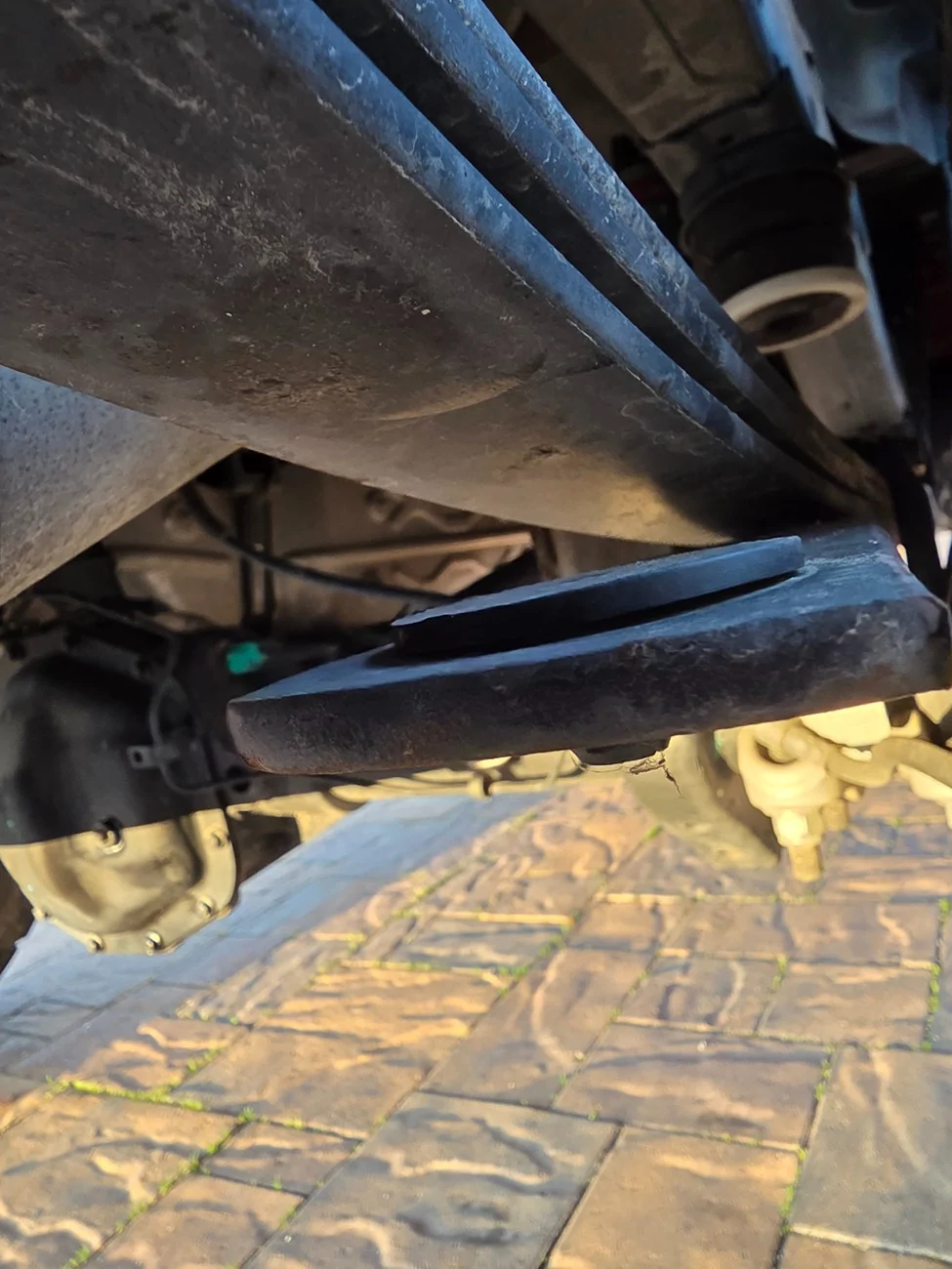

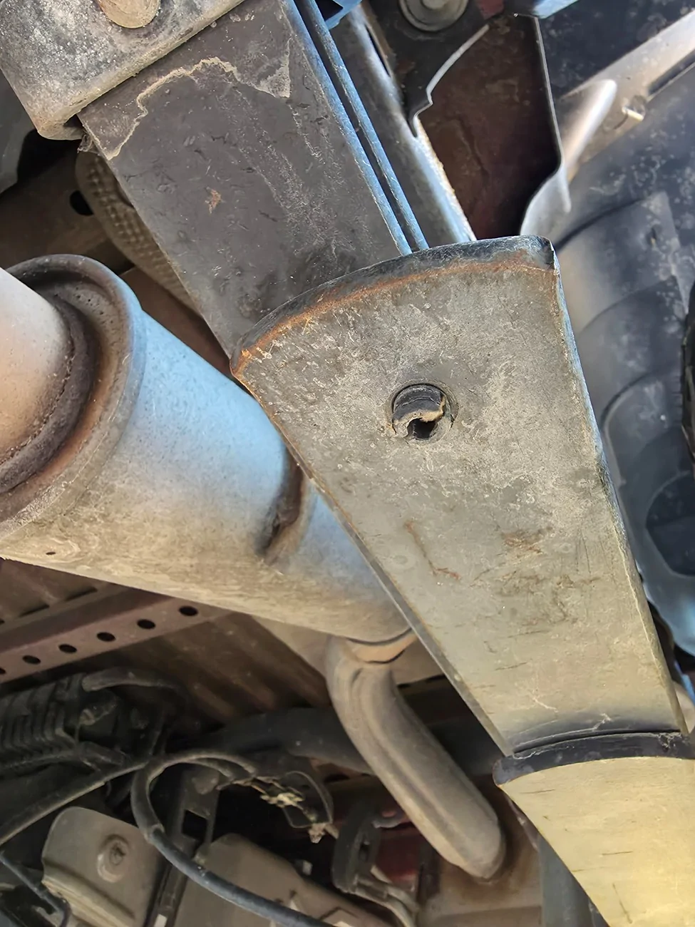

Hey everyone. A couple of years back, I changed out the stock leaf springs on my Sport XLT 4x4 for the more compliant Global leaf springs. Along with the Eibach Pro-Truck-Lift Stage 2R, the Global leafs made a huge difference in the ride and lifted the rear of my truck another 3/4".
Lately, I've been doing more off-road excursions in our local desert and mountains, which have included some max flexing in the rear. I was under the truck this weekend, changing out the differential and transfer case fluids, when I noticed that the lower two overload leafs on both sides were misaligned. Pics below.
Has anyone encountered this before with the Global leaf springs? When I initially installed them, the alignment pins fit in place as they should and all was well.
I checked the torque on the U-bolts, thinking something might have loosened, but they are at spec. I'm heading out to the desert again this weekend, so I'm going to loosen them to straighten the springs and retorque them. Other than that, any suggestions or ideas to keep them aligned properly with each other? Or is this to be expected with extreme flexing?

Is the other end of that leaf off alignment in the other direction?? (meaning the leaf is not broken in the middle)

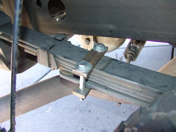

LOL... here we see in the wild, the factory style (to the left) and the home made, get the job done edition...
Here is the link to the home made edition:
https://grassrootsmotorsports.com/forum/grm/leaf-spring-clamps/280488/page1/

Yes, the other end is out of alignment in the other direction. It's the same for both springs. The Global Leafs have a type of U-shaped alignment guide in the front, but they aren't very snug and allow the lower two springs to misalign.

The springs on my wife’s ranger are like this too. We had the dealership look at them when they rebuilt the transmission. They didn’t say anything was wrong so I assume it’s not an issue. Never called to 100% verify but I’d think they would’ve replaced them or said something if it was a problem.
Just searching online, it seems this is a fairly common thing with rangers. As long as they aren’t completely misaligned and still make contact with the leaf above, I wouldn’t lose sleep over it. Double check to make sure your tire alignment is good. If so, leaf it be… lol

I know folks on here tap them back into alignment using a small hammer. I looked at my Icons last week and noticed a small amount of movement as well, but they have robust alignment brackets on them so I'm not too worried

Keep in mind, everyone, these are not the US factory Ranger mono leaf springs. These are the Global multi-leaf springs off the Rangers from Australia.

Spring splay as you are experiencing is common with aftermarket springs but is also present in OEM.. You have nothing out of normal and should not worry about the slight splay your springs show. I have seen this many times on many vehicles, but there are aftermarket offerings that I have seen where the splay is excessive as there are no splay U shaped retainers as a cost saving move. You might inspect the spring center bolt for tightness and possible damage...the center bolt has a tough life...
