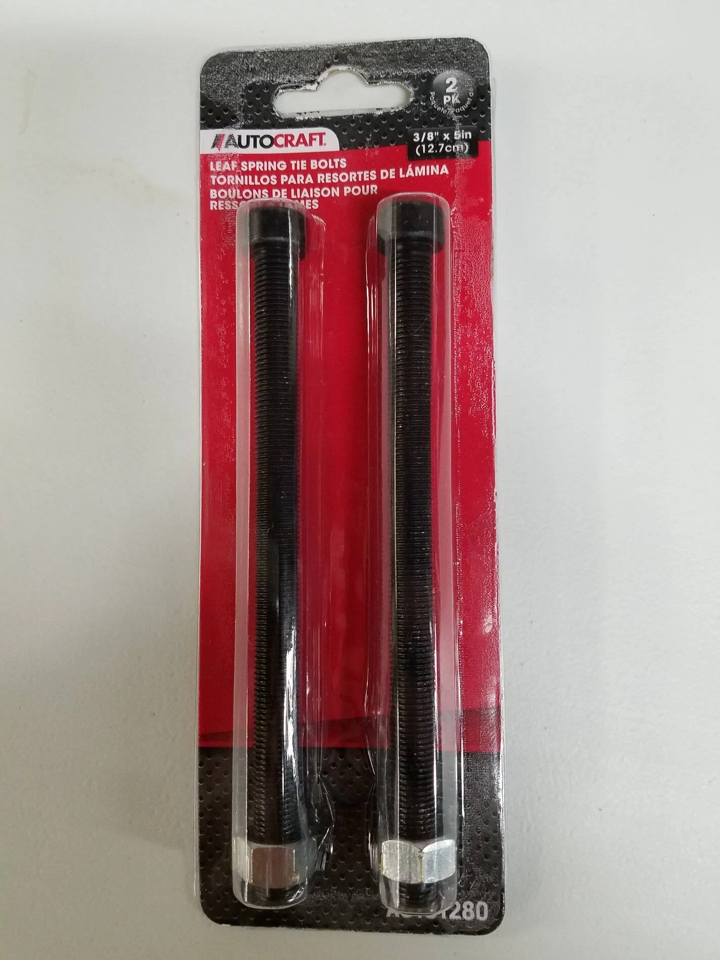

I am aware of the bolt design. Here's what I picked up at a local shop. Trim to fit.
