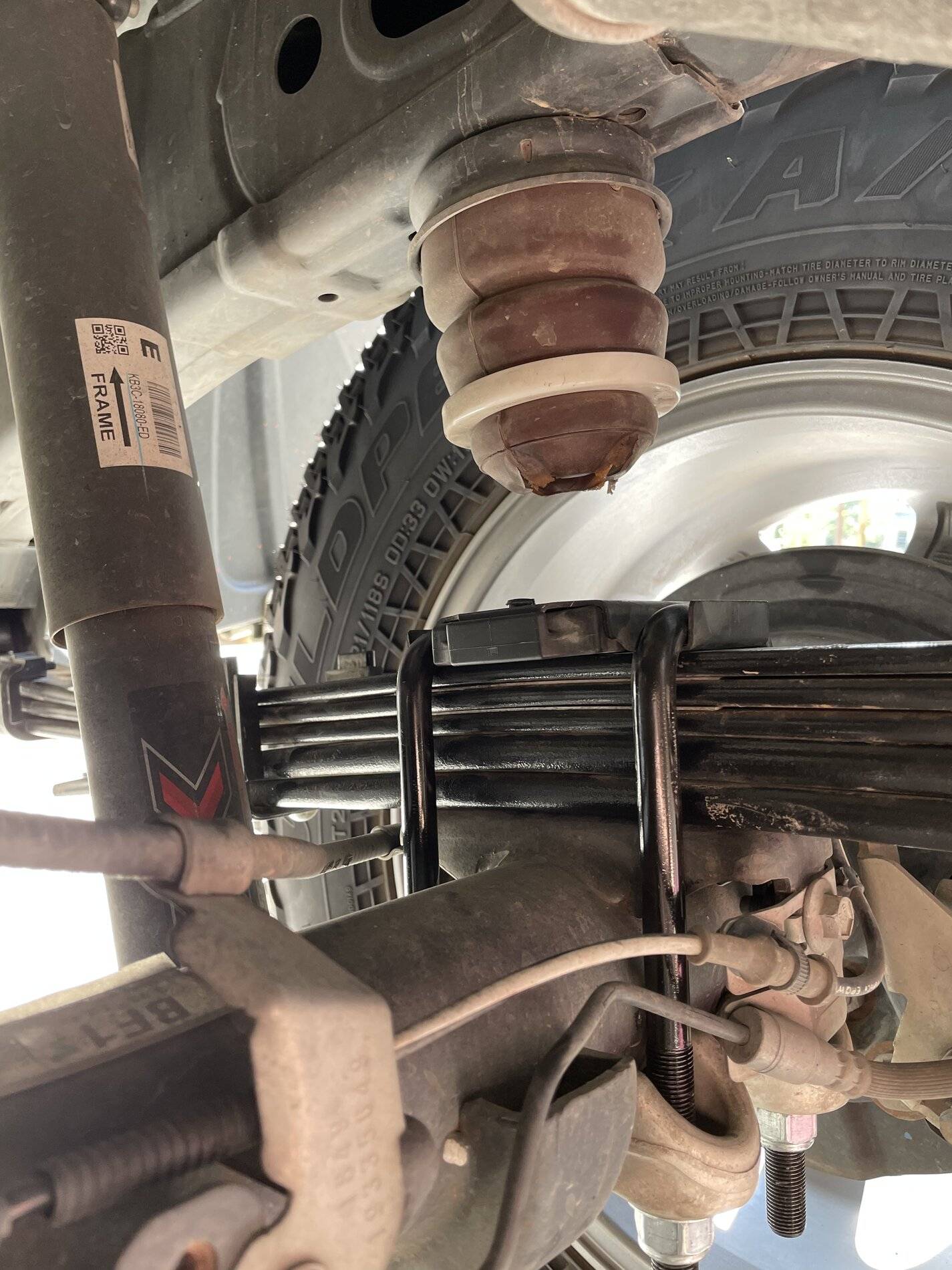

I'm still running the stock bump stops. Maybe Cmar or onobeka can take pictures of their stock bump stops to see if they are any different.

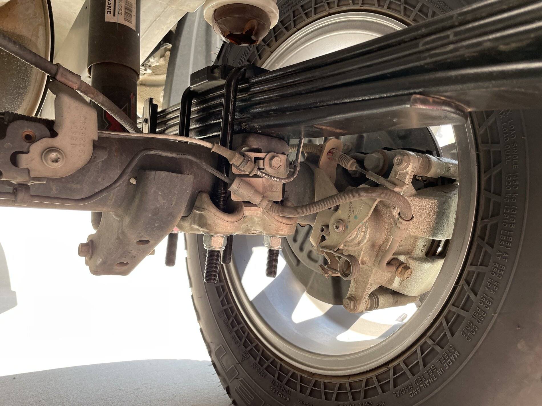

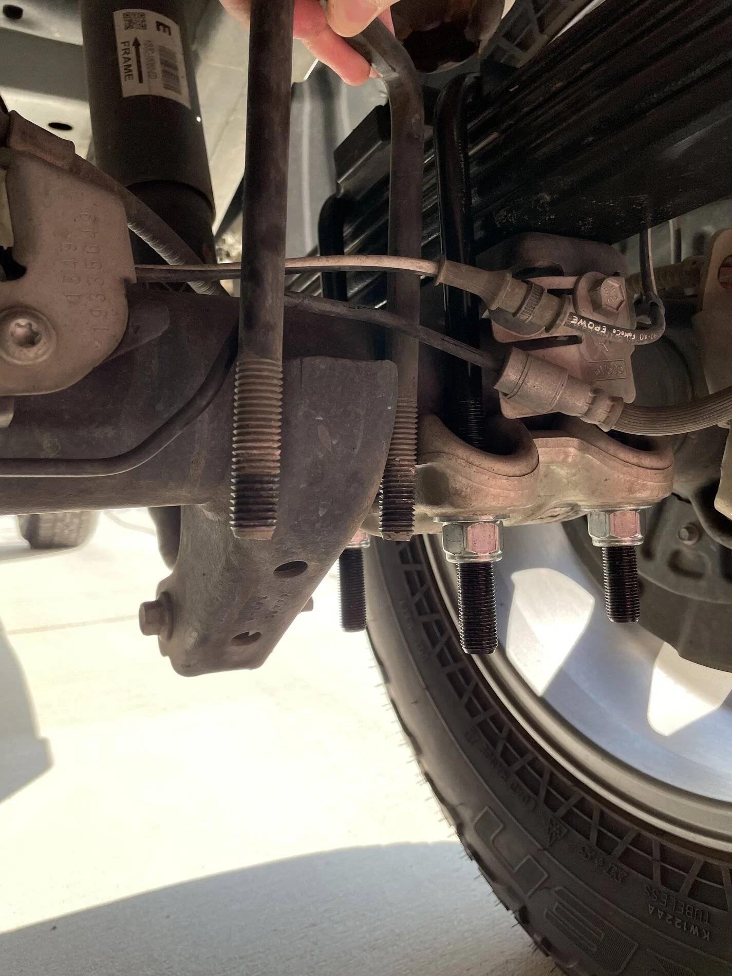

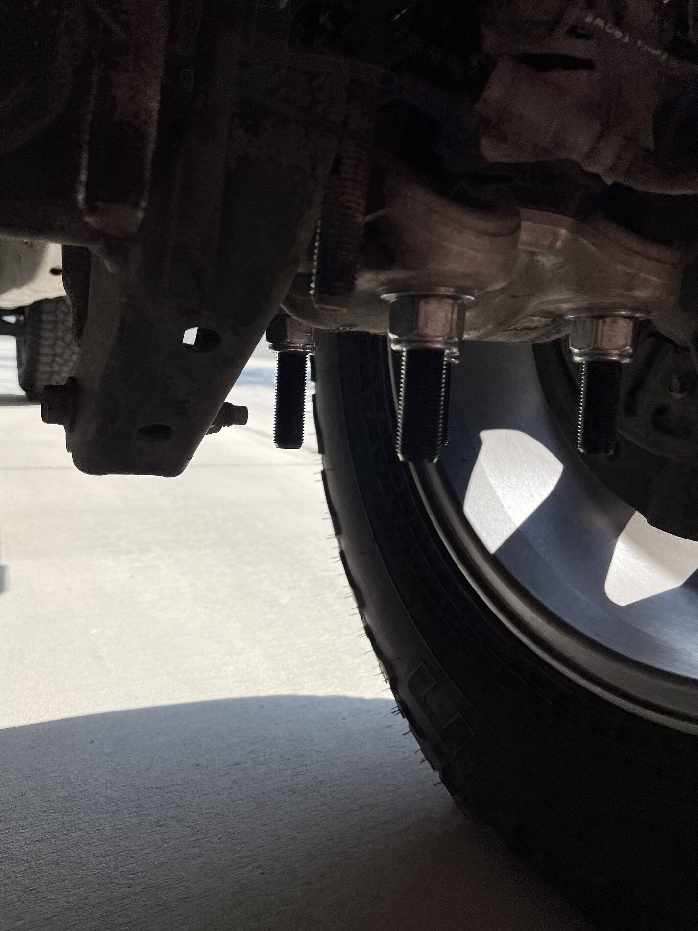

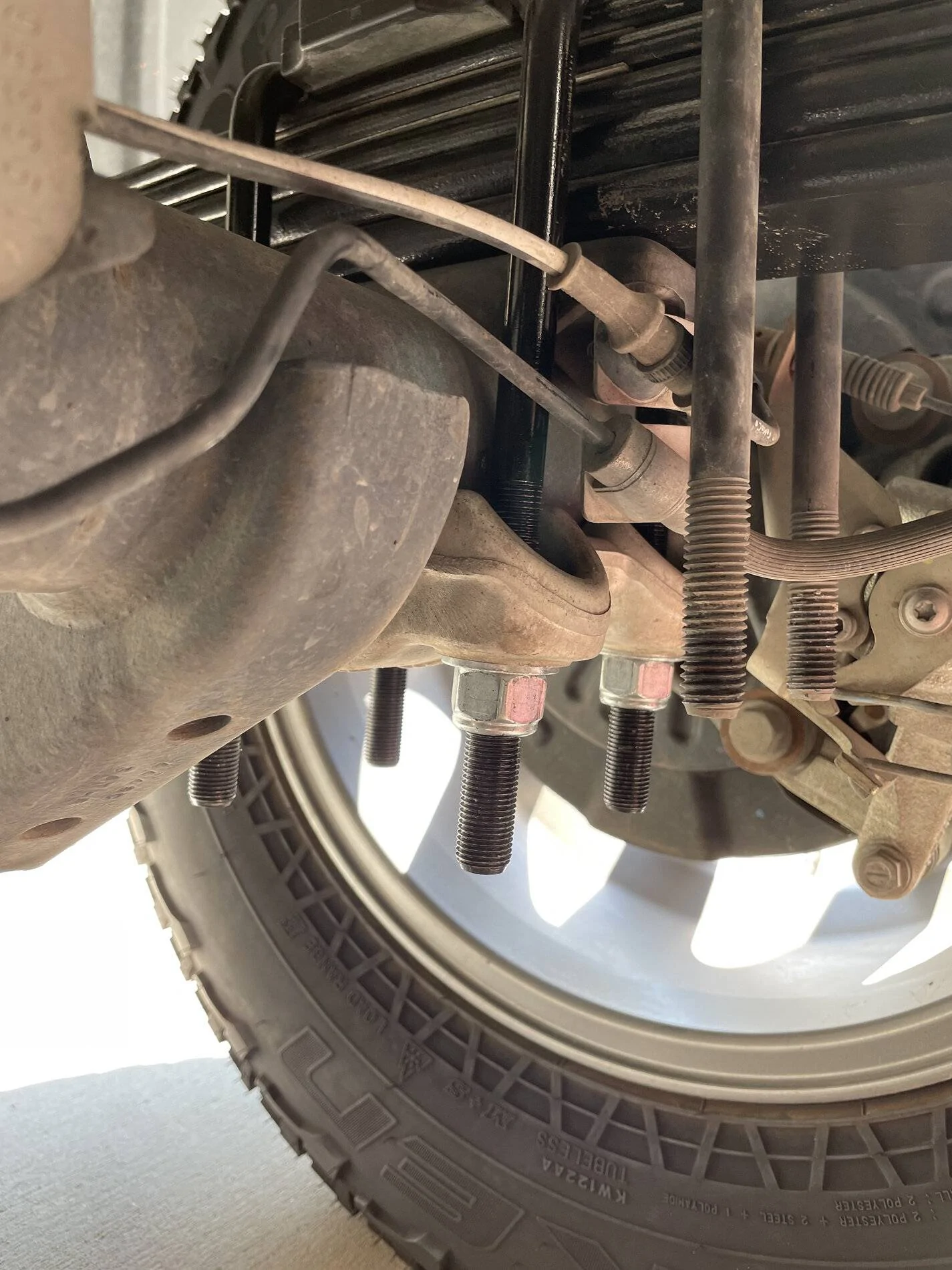

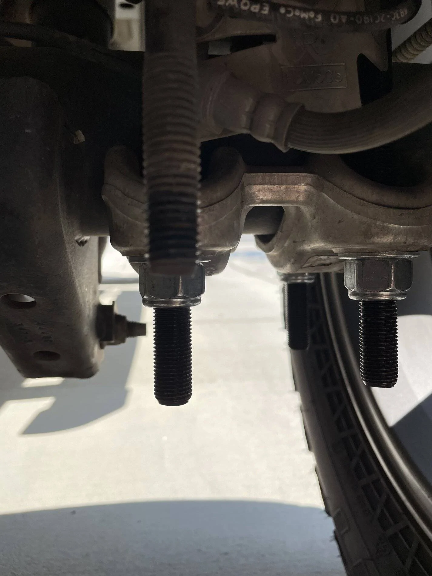

I don’t think the stock u-bolts will be long enough. Heres a couple pics underneath. You can see, the u-bolt won’t go past the nut, you can probable get a couple threads, if that.
Also added a couple pics of the bump stop and you can see how much clearance there is between the springs and bump stop.

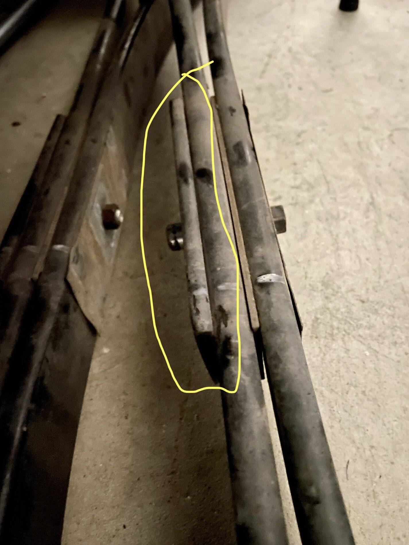

My truck didn’t have that bad of a lean, I believe one side was less then a 1/4 inch of a difference. I had two plates/shims on the driver side and one on the passenger.
When I installed the new springs, I took out the passenger side completely and added one shim to the driver side.
After measuring both sides, if I would of left both plates in the driver side, it might have been level. I can’t really notice it so I’ll leave it how it is. Below is a pic of the plate I’m talking about. The plate I installed was slightly thinner then the one below.
