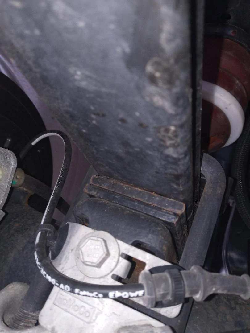

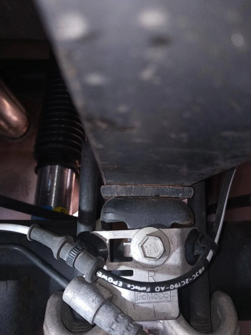

You could try switching them left to right.
Land Rover Discovery had that problem and that’s how we fixed them.
that is what the +/- marks on our springs do. Tell you if they are positive on height. Nothing for neutral and the - sign for negative of nominal.
If they’re both + then that’s what the factory had to slap on. It does seem using a positive on passenger side and a negative on drivers side would give you a level truck. I know, crazy engineering ?

Not sure if I want to make any changes after reading this about correcting a shudder by using shims to adjust pinion angle, and page 3 talks about only one shim per side and they have to go be installed with the thicker end facing forward, seems like swapping out the factory shim for a squared on both sides 1” shim might cause another issue.

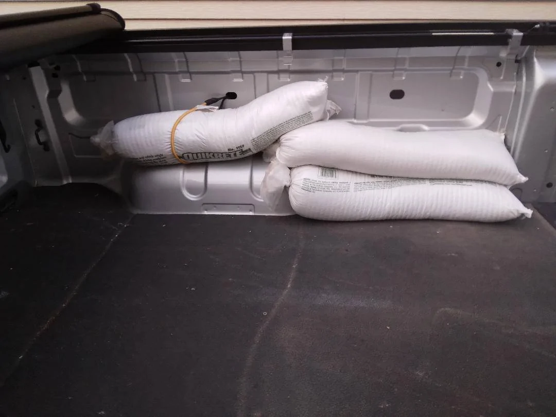

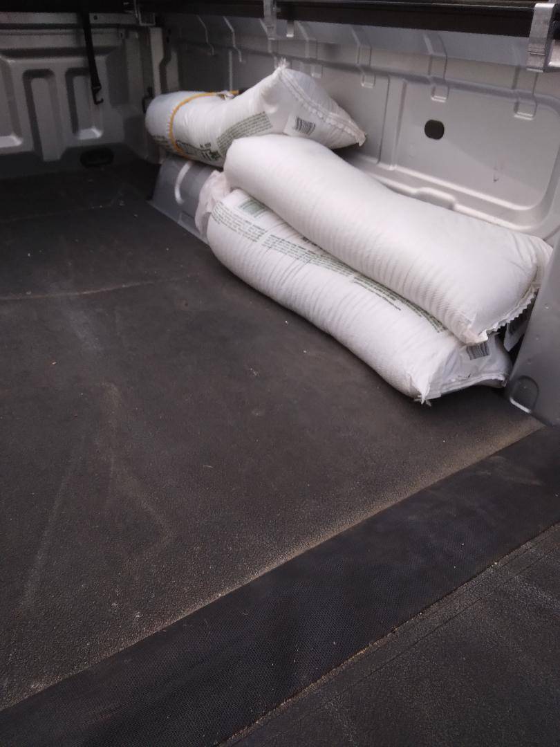

So i was able to locate the tube sand or traction sand, my towns Ace Hardware had them,
they were not in stock at either HD or Lowes around me, guess out of season as winter traction purposes, $6.97 X3 and tax was $21.30 so far the cheapest mod I've done so far :)
They are 60lbs each and got me 3/4'' lower so that leaves a 1/4 diff compared to the drivers side,
so that is great and for all intents this issue is now fixed and am happy how its sitting now.. .
