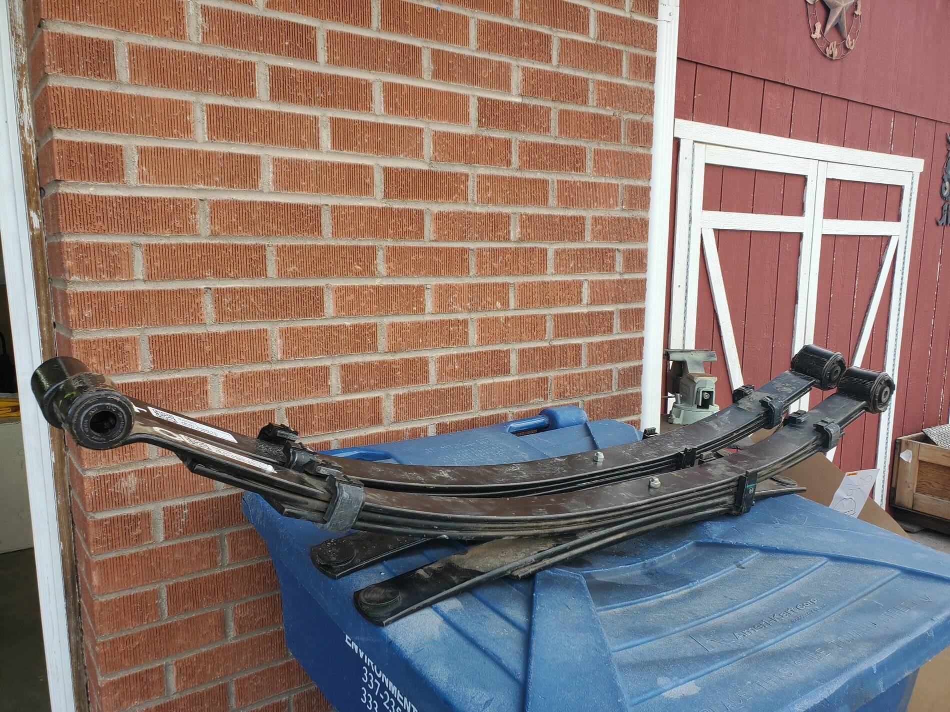

Got a chance to put them in this morning before it got too hot, it's already cracking on 100 at 1 pm.
Observations. They do not change the height of your truck, I measured before and after and it's exactly the same height now that it was before.
The 7 3/4" U-bolt package is just about perfect, my truck has a 3/8' spacer on the drivers side under the spring pack and I have about 1/2" of thread hanging past the nut, passenger side has almost 3/4" with no spacer. A tiny bit less would be ideal but you have to have about 1/4" hanging out for safety.
When you install them put the spring pack on the axle first, get it lined up put the U bolts on and snug them down evenly and THEN put the spring back in the front pivot, then the rear shackle. Archimedes is your buddy here. Try and fight the axle back into place after putting the spring in the truck will scare your neighbors.
They appear to be quite a bit " softer " than the single spring. I need to go run around a bit, double check everything is tight and then go drive off a few curbs and hit a few speed bumps.
I'll post up any thoughts on how they ride after I get a couple of miles on them.
