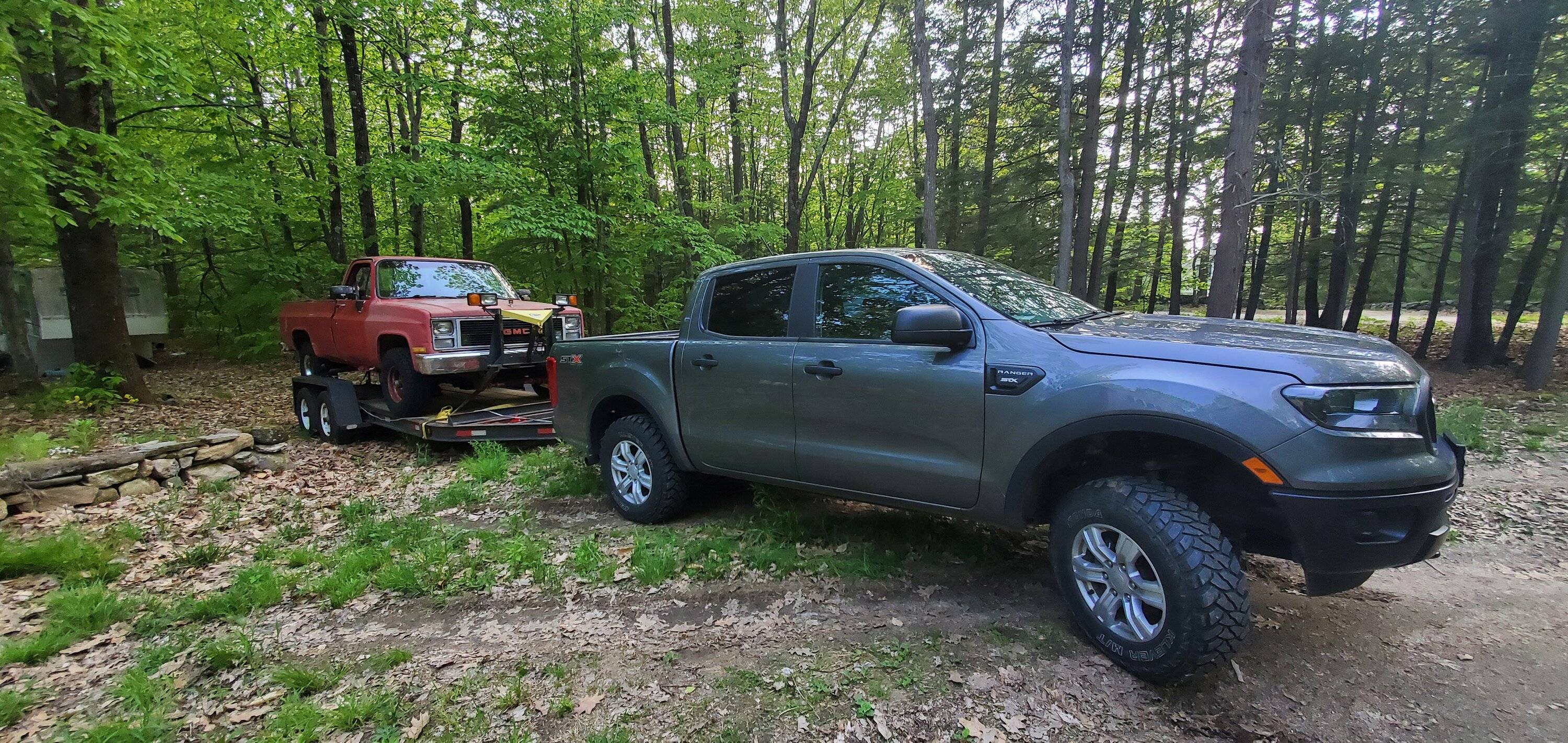

Leveled, dog-squatted, 8k lbs easy.. had to take twisty bumpy haggard ass back roads the whole way home... it's a wonder how I survived!?
Not.
It's fine.

The moment you start to dog squat you are taking weight off the front tires and making the vehicle more unstable. So no it is not within legal limits anymore.
The moment you put anything behind the axle you are taking weight off the front tires. You just don't get a visual indicator if your springs are too stiff to squat.
If you had no suspension at all, you could only have 1 pound of weight on the front and be horrifically unsafe, but it would look normal.
Here is something you are also missing. Once you start to squat you bring a big wind factor into play. How so you ask? Well the air/wind is now going to push the fro t of the truck off the ground as you go down the road. This will lift the tires off the ground even more. That makes it worse
Nope, wasn't missing that. Just pointing out that getting your truck not to squat doesn't mean it's got plenty of weight over the front.
Yep, although I'm curious by how much- truck undersides aren't exactly a wing, and lots of people out there run the squat look on purpose- even unloaded. Probably be a significant issue at speed, but I've been wrong before.
