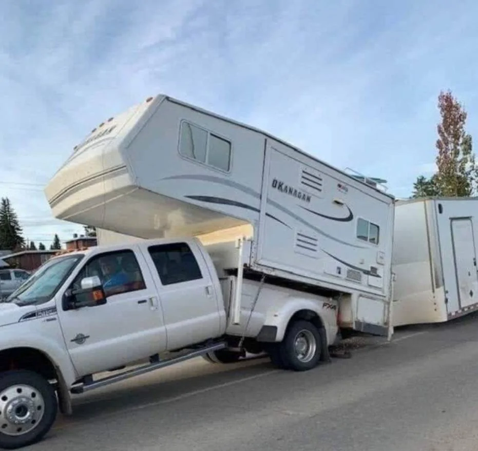

Honestly it still holds the same legal rating no matter how dumb it looks.
The moment you start to dog squat you are taking weight off the front tires and making the vehicle more unstable. So no it is not within legal limits anymore.

This guys springs were within capacity, but....
