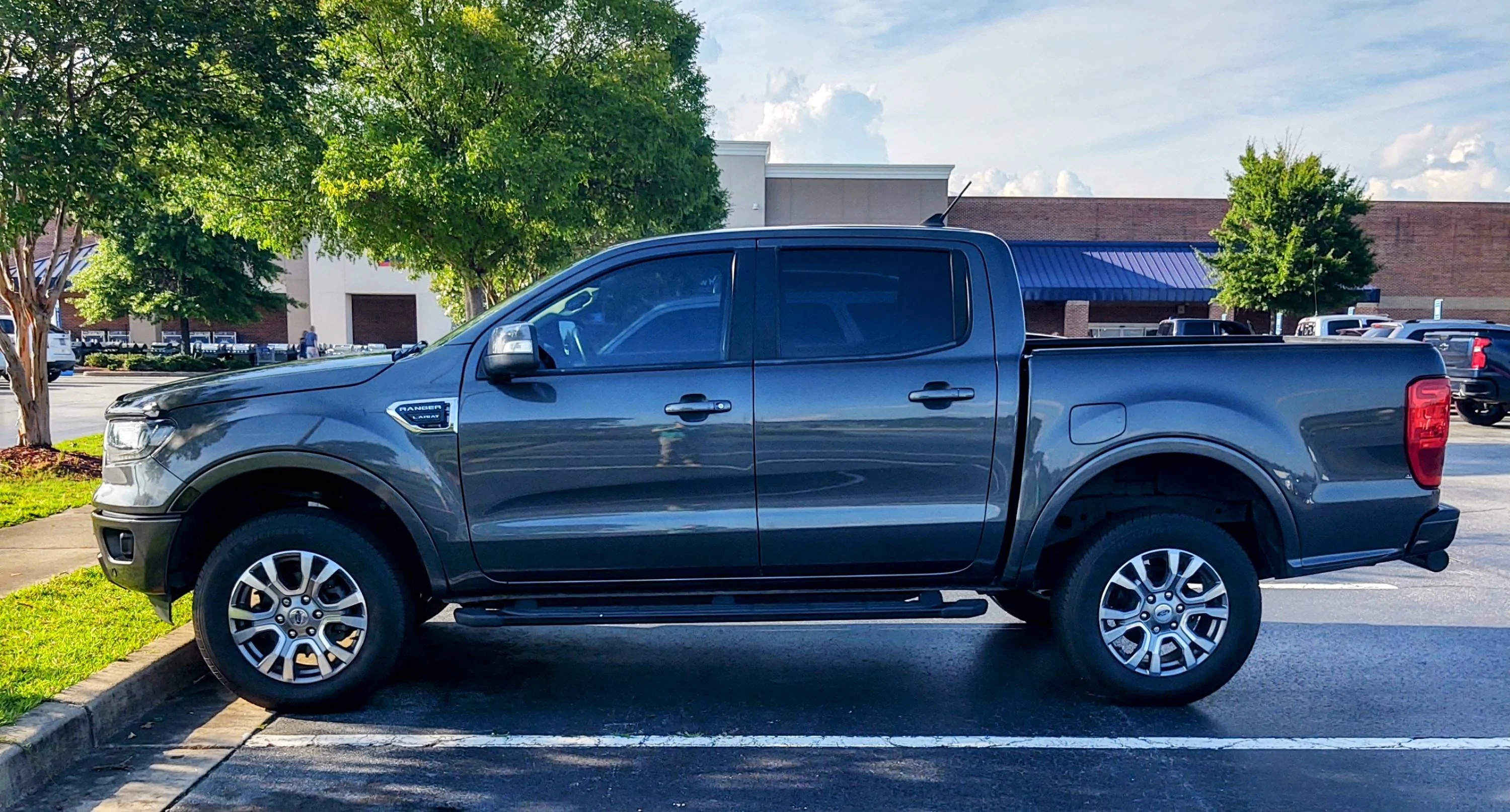

Finally snapped a picture showing the current stance. It's not as pronounced as the stock one although with the Eibach adjustable front struts set halfway it's gotten some rake back after the multi leafs.

Still happy with mine.
Same here. As for the 'W' I presume that was existent in the ROW models unless the position of the spring was different in relation to the axle?
I don't know of any anecdotal way to determine if the pinion angle has been affected but having had the truck at the um, upper limits of speed I'm willing to go it's very smooth and stable. No vibration that I can detect.
I seem to recall images that the pack was below the axle on some foreign models, which suggests a potential to level the truck without raising the front. Maybe I'm mistaken ? as that would suggest the U bolts would be all that's keeping the rear suspension together. I'll have to look for those images again.
Odd thing is the truck is rated for more weight carrying capacity overseas than USA.
