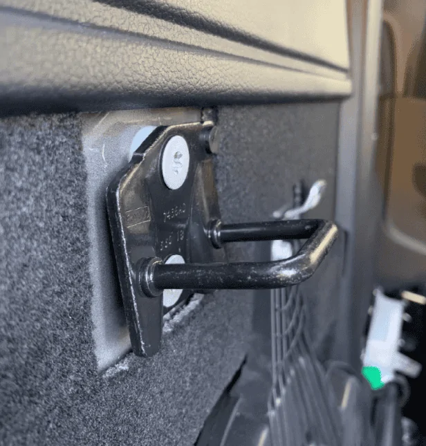

back frame on the truck wall. It simple moves the bracket out 1/8th inch so the seat latch can engage and lock as expected.
Awesome. Thanks again. Makes total sense - sounds like it's exactly what it needs. Just to be nudged a bit outward.

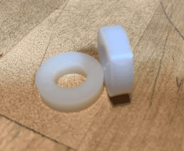

No, big gap there. The seat has rubber bumpers which is what is slamming into the back of the cabin wall. Moving the latch out 1/8th inch means the bumpers don't make contact too soon.
I used these 1/8th hard plastic spacers:
Installed:
Works perfect now and no need t slam it closed.
You'll need a T-30 torx
