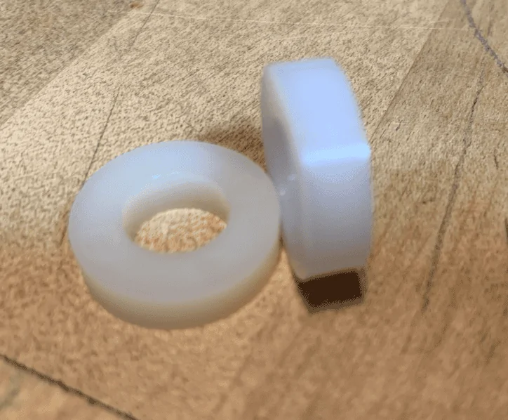

I tried washers, after 3 on each bolt, it was just starting to touch the latch. I went to Ace and got some plastic 1/8" spacers and it now shuts normal, mild slam. I did not have to mess with the bumpers.
