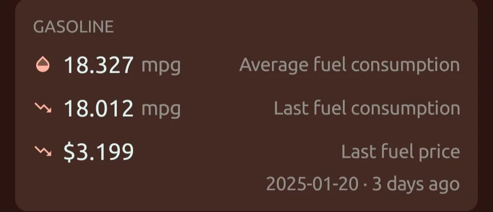

I had the same experience running 33s/lift. I’m now running 35s on a 3” lift and I’m getting 18.3MPG after tuning with HP Tuner but with simply adjusting for larger tire size through Forscan, I was getting 17mpg. That’s the first thing I’d do and if tuning isn’t an option then slow down to 70-75mpg ?
