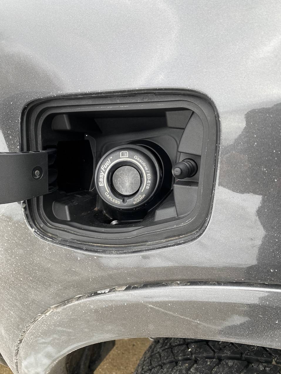

Look at the top edges of your fuel Nozzle Opening-
There are small/thin "slits" right below the words "Easy" & "EO-E15"... roughly the 9 & 3 o' clock positions.
You can barely place your finger nails in these slits...

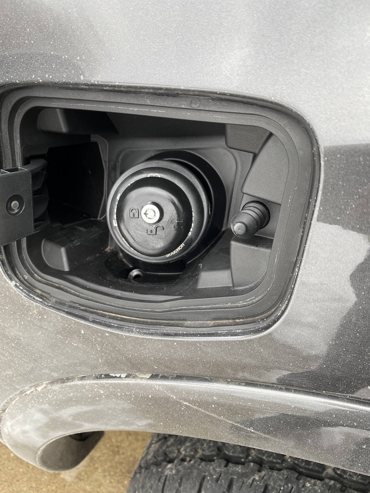

My key-lock came in a Ford bag with the part number BU5Z-9C268-A 1X
Ironically I discovered this key-lock is for S550-Mustang/GT500 and I did some pic searches...
Based on internet pics, I figured the S550 Mustang/GT500 is using the same filler neck as the gen-5 Ranger.
So I took the "50 dollar" challenge...
BU5Z-9C268-B part number, using Levitowns Parts site, the pics are the exact same as mine [A version]. In the third pic, you can see the fixed-slit [or thin tab] on the plastic cover portion and the silver slit/tab is the open/lock mechanism to keep the cover in place.
It's like the other Ford OE style locking caps, once you twist the key on the lock to the open position; the key stays attached to locking cap... until you place the locking-cap back on the nozzle & twist the key back to the lock position.

Forgot to mention:
Using Levitown Parts Pics... The B version is using the exact same keys as my A version.
The only issue with the key is it's a mini version of a typical bike lock key and the opening to place/hold the lock-key to your key ring is TOO small.
I was barely able to get it on my key-ring.
I'm looking for an extra "mini" key ring that were given/installed on the old style Ford FOBs....
