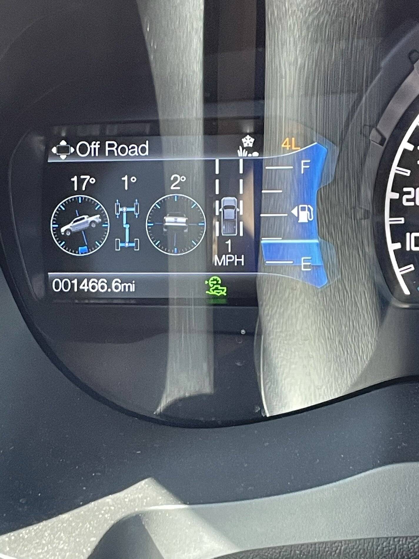

I got to try out the Off Road display today. It’s pretty cool.

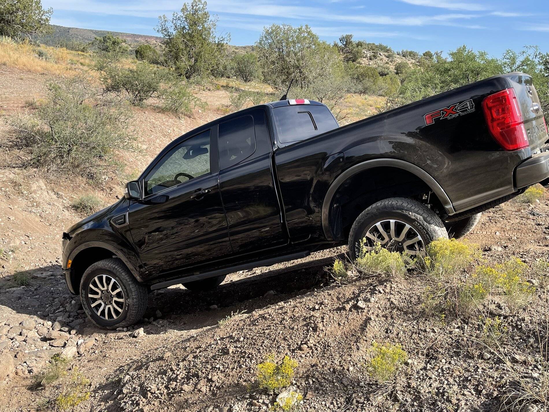

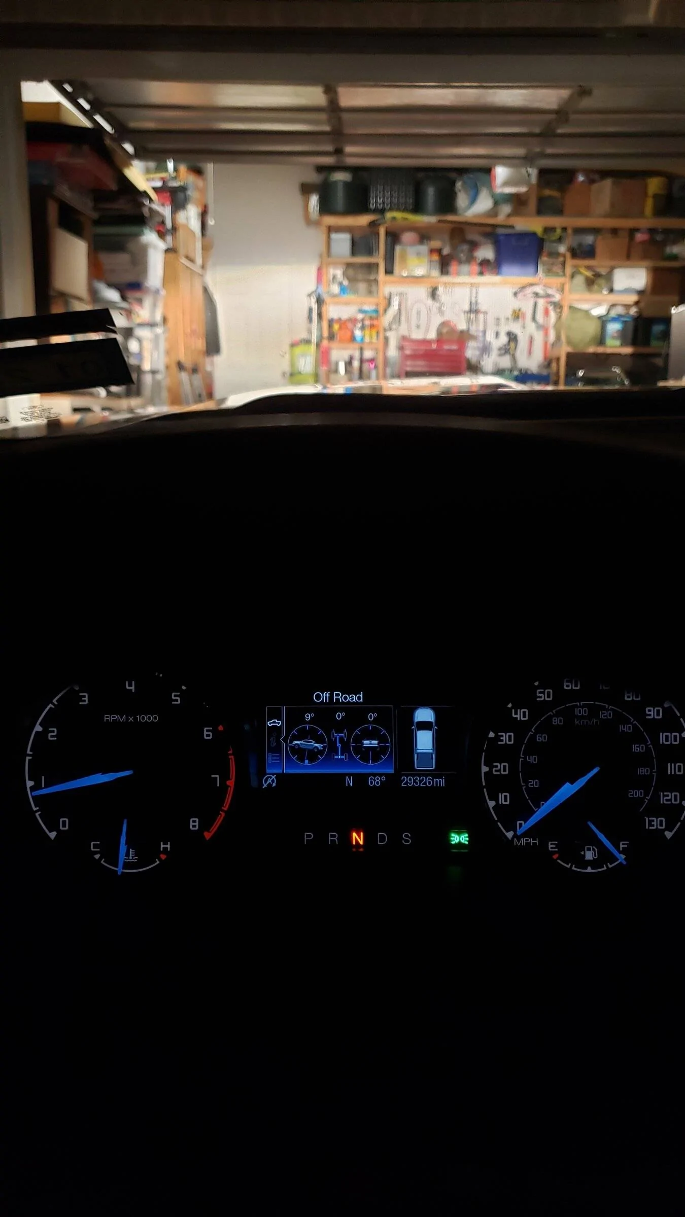

I have this on my drive way every day! Mine says 9 degrees, and i can get a tire in the air! Haha
Look at my prifile pic, thats my drive way

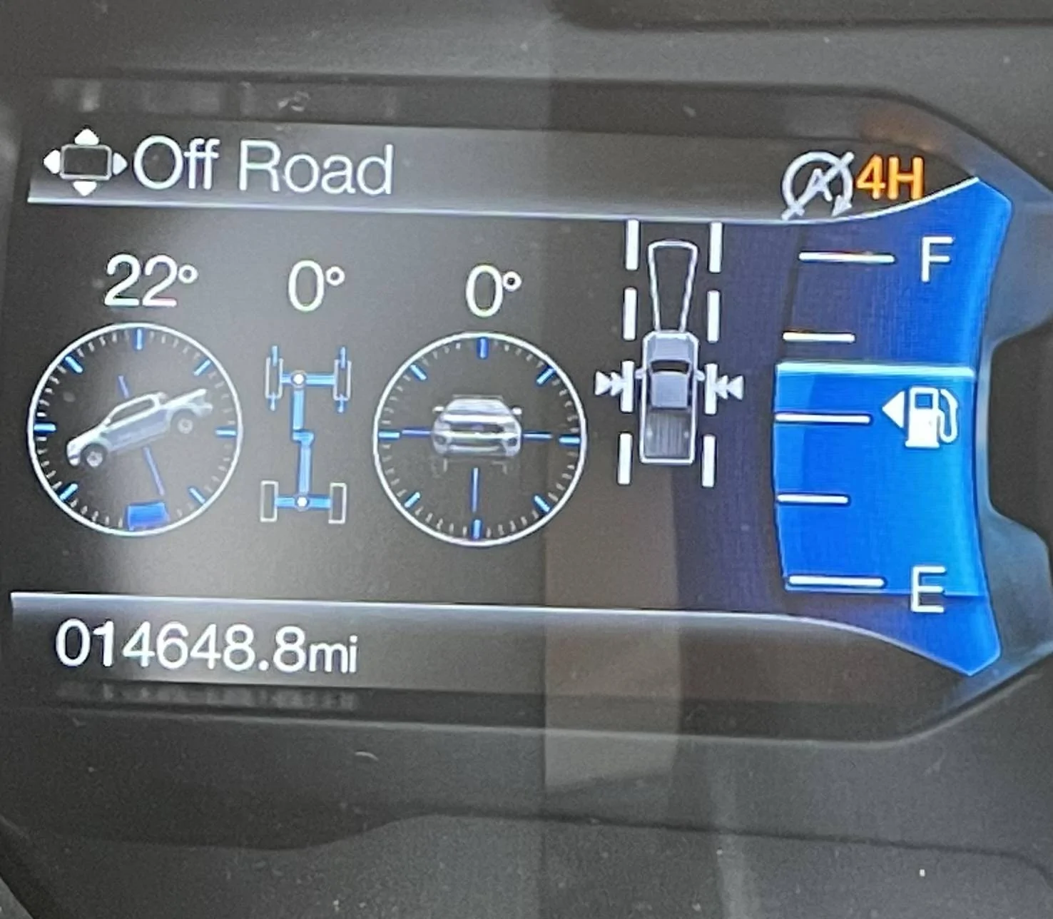

Late to the game, and haven’t received my truck yet, but can some one clarify the graphic to the right of the “Angle” display. I saw in one follow up pic, it looks like it displays the crawl control speed, but what we the FasyForward/Reverse symbols indicating?
