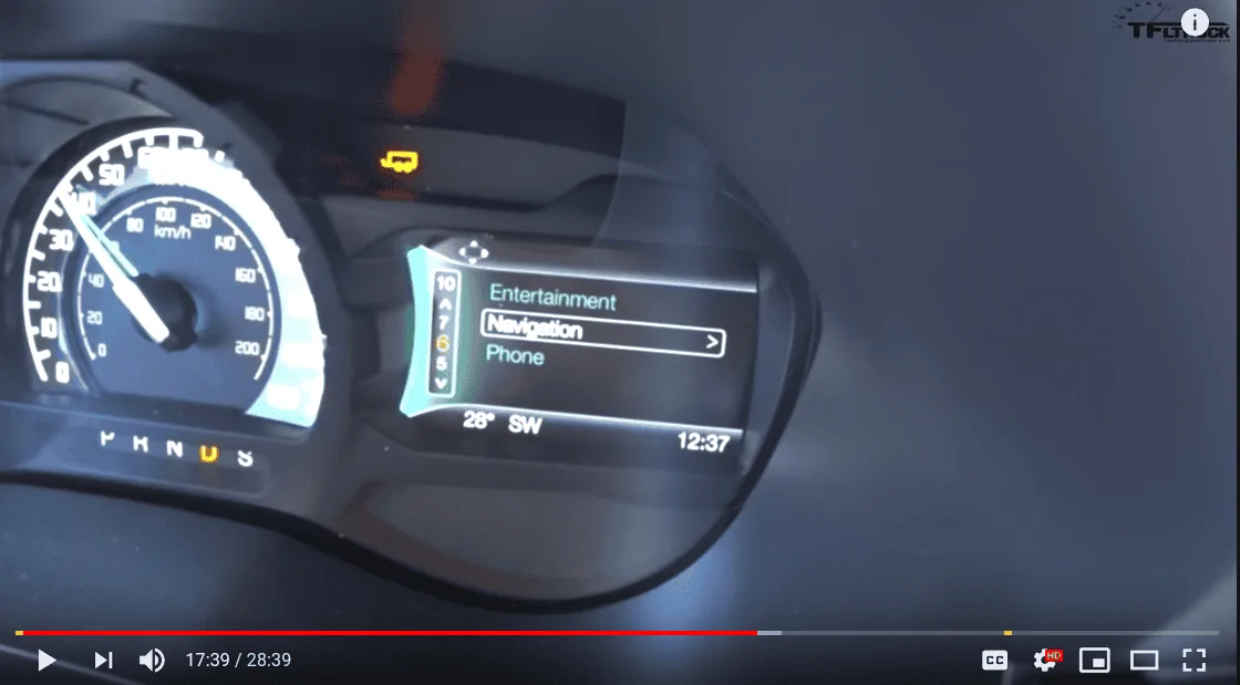

Press the - button on the shift knob, gear display appears in right display screen. Stays up on next start fir me.

All of the Ranger trims show the gears, and can have the display turned on or off. Simply press the + or - gearshift button on the side of the gearshift lever to turn the gear display on or off. Whichever way you have it set when you turn off the vehicle, will be set when you re-start the vehicle. On the Ranger, because the display screen is smaller, you don't see all 10 gears like you do on the larger trucks. Inactive gears show up as white numbers, while the current gear shows up as a yellow number.

I was able to confirm the method @bandit67 suggested. Pushing the + or - buttons on the shifter while in "D" drive, and the transmission gears will display. Here's the XLT display:

This is correct. But make sure you realize, while you are in D, the + - buttons put it in Progressive Range Select mode. If you press the - button, you'll see the upper gears disappear from the display. That means you are locking out the trans from going into those gears. If you just want to see what gear you are in, always just press the + button to be safe and it will stay that way until you turn the vehicle off.
For example, in @rangerdanger 's image above, he locked out 9th and 10th gear. The trans will only shift up to 8th.
