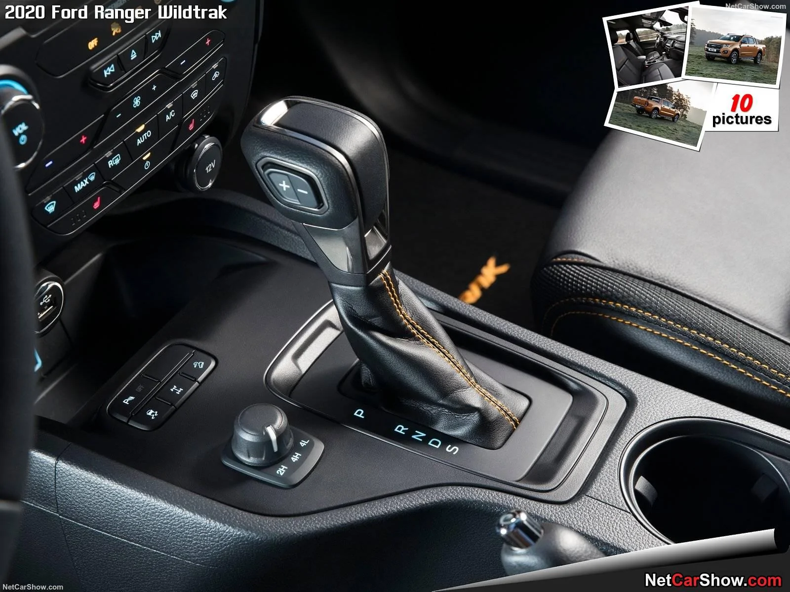

Thank you very much, instead for the terrain menager? Am I obliged to install the button as well, or can I do as the raptor does from the steering wheel?
t4thfavor
Chance
Feb 5, 2019
2,607
2,357
you'll need the buttons in this model.
Stefano187
Stefano
Mar 3, 2021
Italia
Ford Ranger 2.2 limited 4x4 EU
DRIVER
But even if the ranger raptor didn't set them from the flying keyboard in theory I should be able to do it too without changing the 4x4 selector right? also because I don't know if in Europe you find that spare
t4thfavor
Chance
Feb 5, 2019
2,607
2,357
It's a button in the middle of the 4x4 knob. You just have to push it a few times to select the mode.
Stefano187
Stefano
Mar 3, 2021
Italia
DRIVER
Yes yes I know it but I in the European version I have the 4x4 selector as in the photo and I do not have the TM, the raptor is the same but it has the TM that drives the steering wheel through buttons of the on-board computer menu, I wanted to know if it is possible to enable it and make it work like I raptor because it is likely that I do not find it as a replacement in Ford I 4x4 selector that you say
t4thfavor
Chance
Feb 5, 2019
2,607
2,357
The raptor features have not been unlocked as far as I know.
Stefano187
Stefano
Mar 3, 2021
Italia
DRIVER
You thought something was simple! Now ford if it exists as a spare in Europe that button (the selector you have), thank you for everything for the help, I update you as soon as I have news both on the OffRoad menu and on the TM
