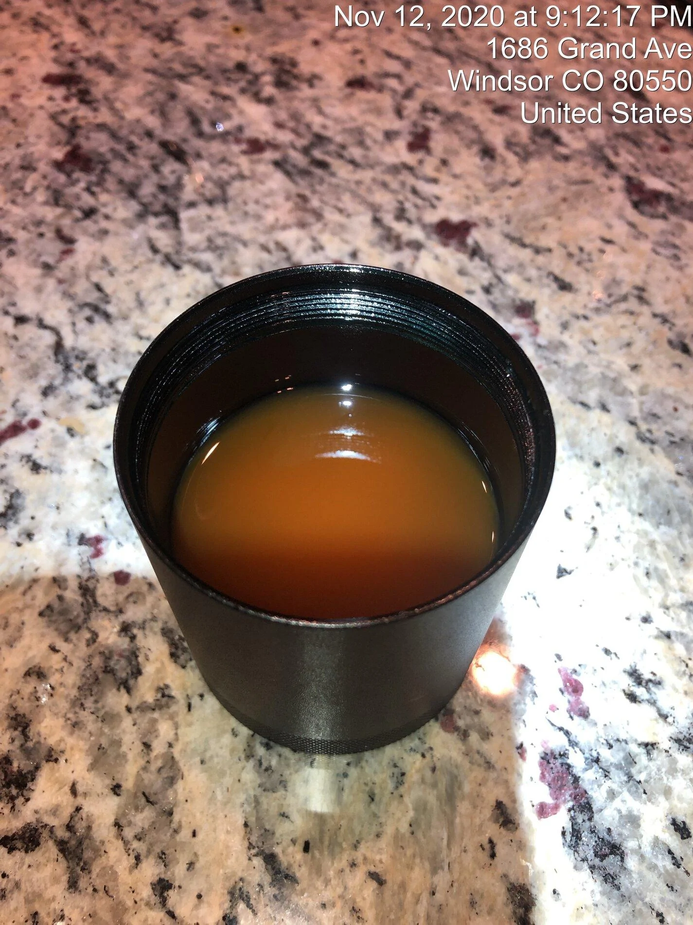

Hmmm....if your having this problem, why not try installing a catch can and see if that fixes the issue? Mind as well, right? I've had mine on for about 20K now and absolutely no fuel issues in the oil....<0.5% last Blackstone. (In all fairness, never had the problem)
Engine Build Date: 10/28/2019...Purchased 02/20/2020.
Just have to make sure and keep it emptied if it is a small can. Would recommend a large can...at least 7.5 oz.
Also, the UPR cans with the continuous vacuum are probably your best bet. I have a Mishimoto catch can and would definitely recommend there products, just get the XL can and the drain kit.....
Also, remember due to the chemistry of fuel when it is cold and wet you will need to empty that small 3.5 oz can every fill up. ;)

Totally understand! Just know that catching the fuel/oil vapor from going back into your motor will not void any warranty. I catch at least .5 to 2 oz per fill up...at least! Much more when it’s cold. If I would have seen the pictures posted of catch can contents earlier, I would have put one on immediately. (Installed mine at 20K) Heck, I didn’t check mine for almost the first month and was shocked to find my catch can full. Now look, I’m NOT saying this will fix anything or is the cause of anything. I just know I do not want the crap I catch in the can going back in my motor! Can’t be good in the long haul....IMHO as always
I know some folks think I’m a nut head with some of the stuff I post but I tell you what...my truck runs better than it did the day I bought it on 02/20/20! I have had no problems with engine or transmission and I’m at 39,633.4, and I run the heck out of her daily. I’m that AH in the Ranger on the street. A chunk of the local college kids know my truck well and I actually have a hard time getting my target audience to play...lol (That would be late model Subaru STI’s and Evo’s) I don’t know what it is but when I hisssss at them on a drive by, they tend to slow down...no kidding, it’s frustrating for an old bugger like me?
