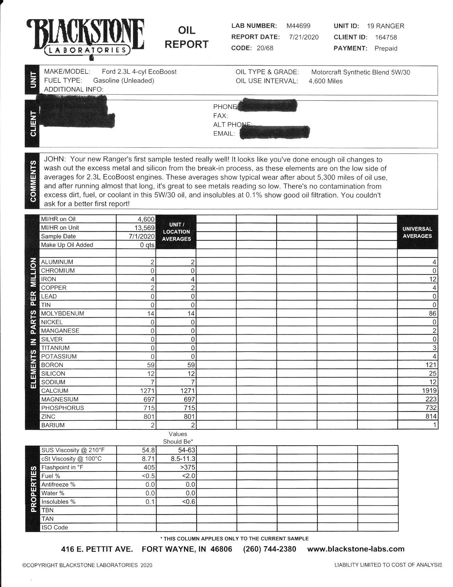

FOLLOW UP-CRANKCASE LEVEL--Ran just short of 5K on this last oil change--Saw/verified no level change, or increase in oil level, up to/including day of oil change. Using Motorcraft synthic blend 5W-30, and just did the six quart dump to set level. Sent in sample, so report attached. Current mileage is almost 15K now. Hope this report provides a "baseline", for all.

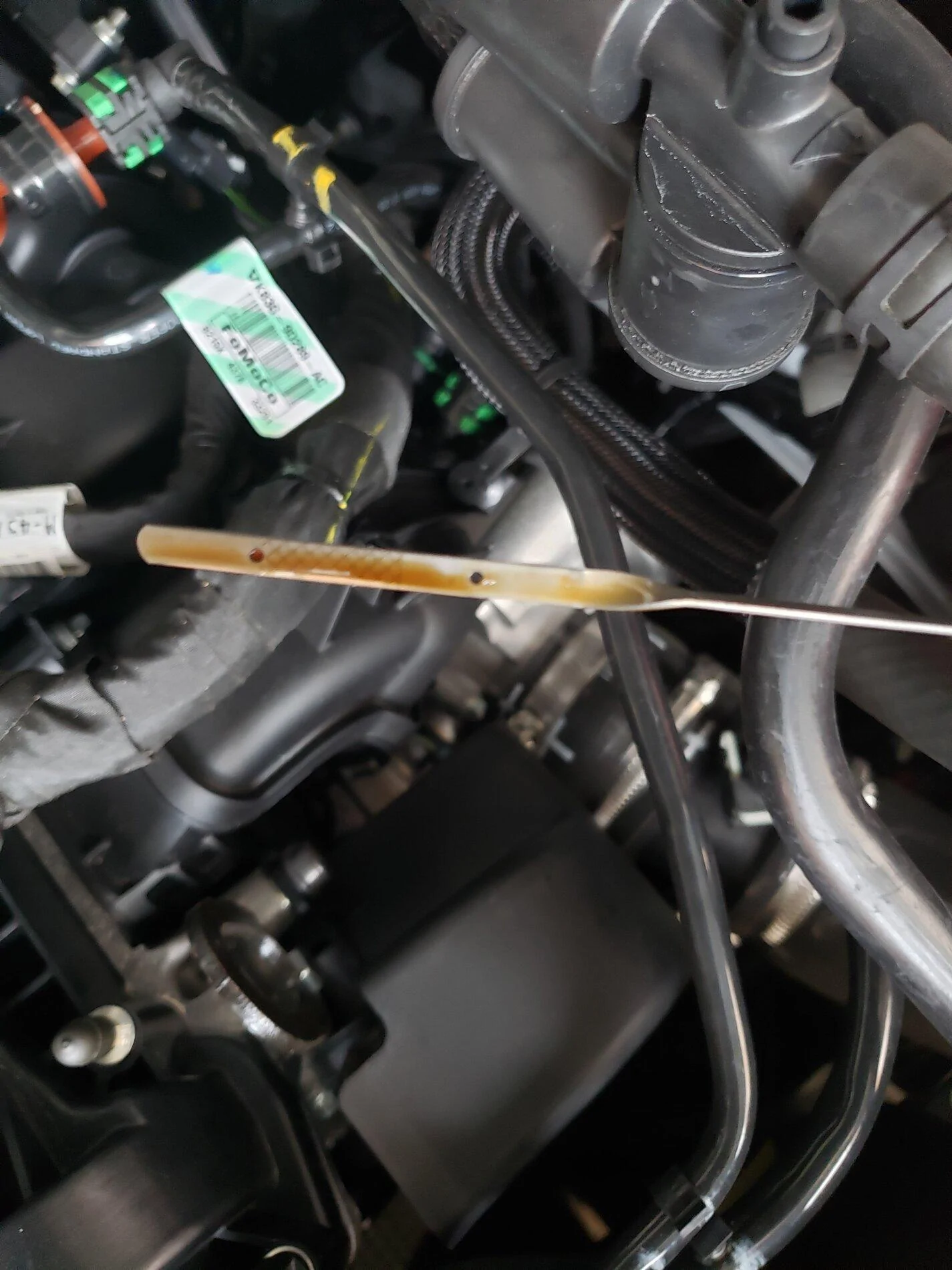

So after reading this thread I decided to check the oil on my ranger 3053 miles on the dash, oil level seems high and smells of fuel, going to change at 5000 and do a sample
