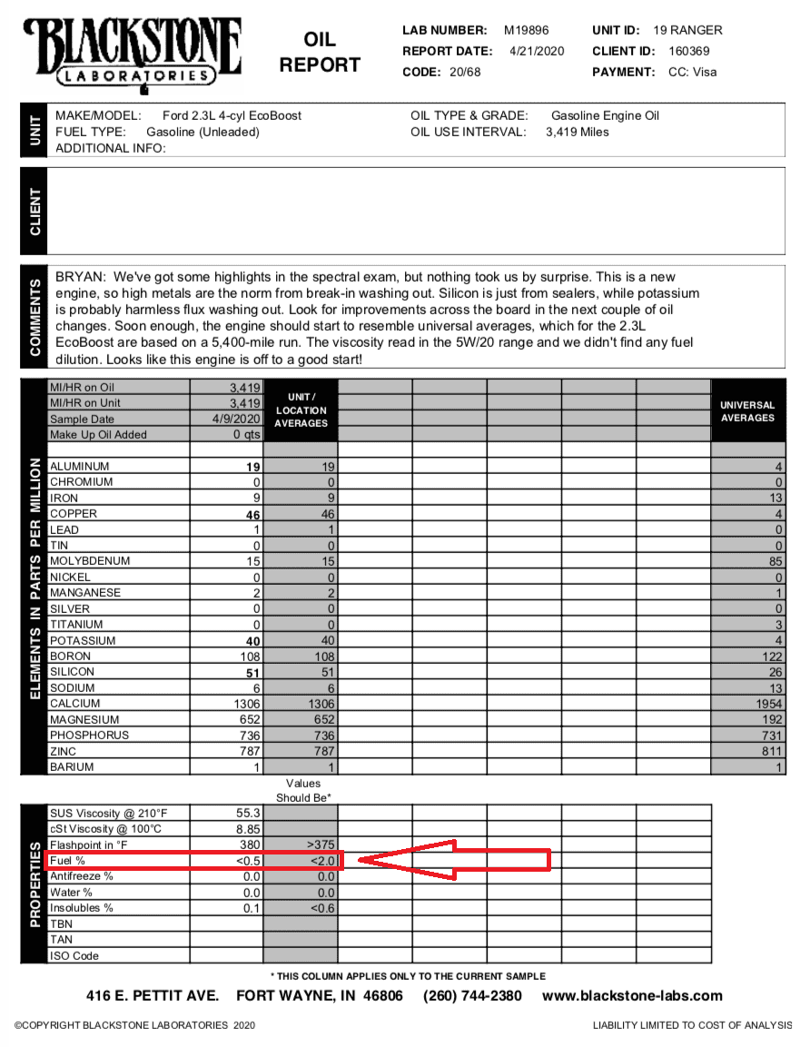

Explain what you call fuel dilution please. In my experience every engine may have a certain amount of "BLOW BY " which is spent combustion gases. The higher the cylinder pressure the more blow by depending on how well the rings have seated. Brand new engines will usually have more blow by gases till the rings seat. If any minuscule amount of non combusted fuel is in the blow by gases it would be re absorbed by the pcv system or evaporate when engine oil temperatures get up to normal operating temps. If what you are suggesting is true especially with the amount of gas in the oil that is happening to these folks that would be like in kind to cylinder washout which would effect the rings seating among other issues and is not normal. And I will repeat I had no gas EVER in my GDI regal nor in any of the vehicles I have owned that caused the oil to smell like gas or increase the crank case oil level.
I agree with everything your saying... except... "I never had fuel dilution".. every internal combustion gasoline motor experiences it on some level.. It just normally not excessive, but it is always there.
Any fuel in the crankcase causes fuel dilution. This happens especially when the motor is cold. Once the motors comes up to temperature then the fuel, and any condensation, turns to vapors and are typically evacuated from the crankcase by the PCV system, if your vehicle has one.
My point is.. fuel dilution happens, it in itself is nothing new. The issue the folks are having is something other than the normal blow by.
Ford is working their way through the issue, and it appears they are finding it is high pressure fuel pump or injector related.... not blow by related.
As I said Ford will get this sorted out. It's the price you pay for buying new(ish) technology.
