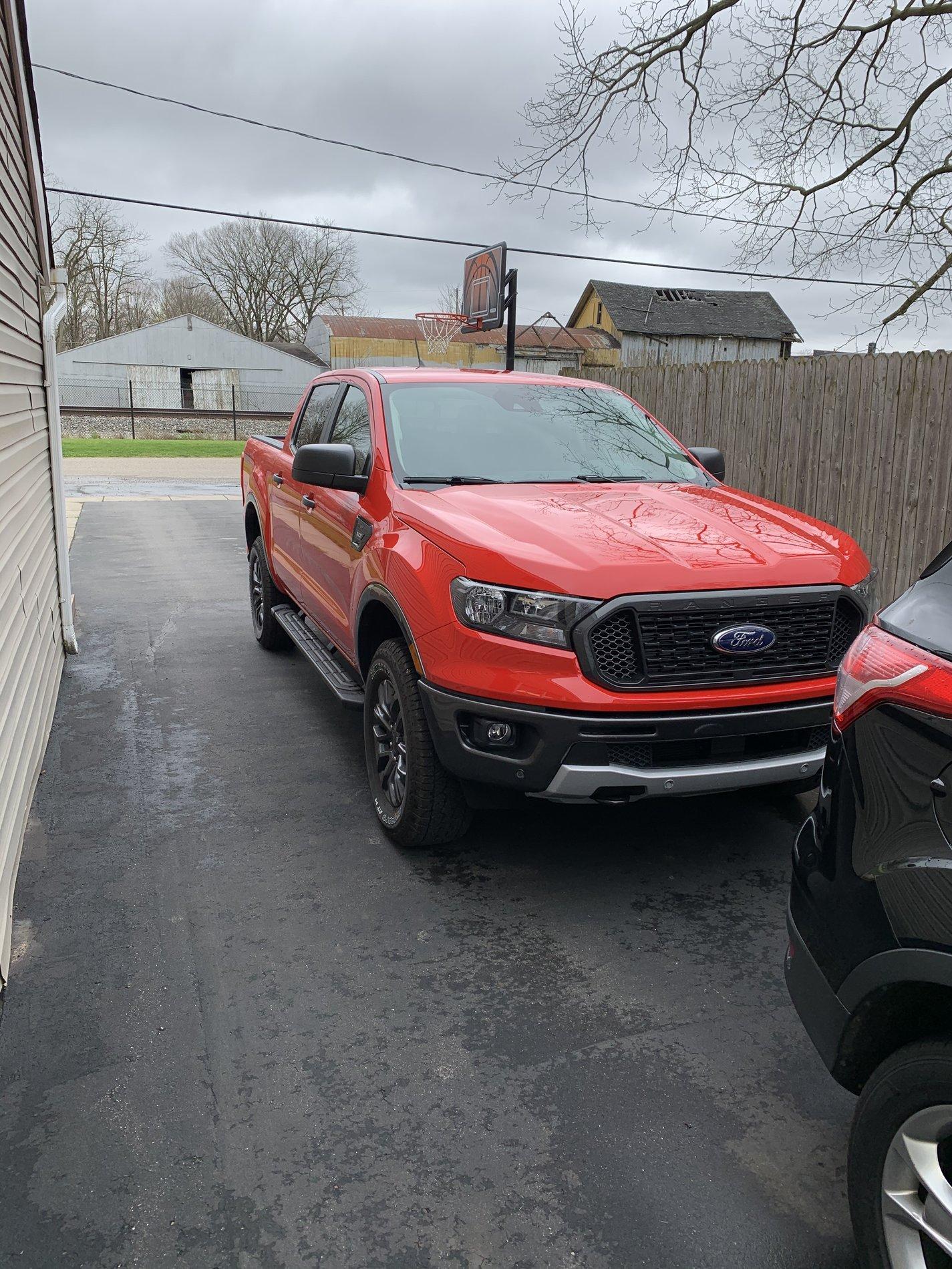

Well back from the dealer. Waiting on Ford Engineers to call back to tell them what to do. ????. But they did give me a Ranger to drive in the meantime. I’m amazed at how going from Black to Red make the truck feel smaller. Will let you know what I find out when I get more info.

I know im responding to my own post. But some might find this interesting. Got this loner while mine is in the shop and curiouity got the better of me. Yes i checked the oil. ? and it is just passed the top hole in the stick. Only 71 miles on it and a 2020 engine build was Dec 2019. So it might just be the break in period, but mine didn't get that high till over 700 mile mark. Wow!
