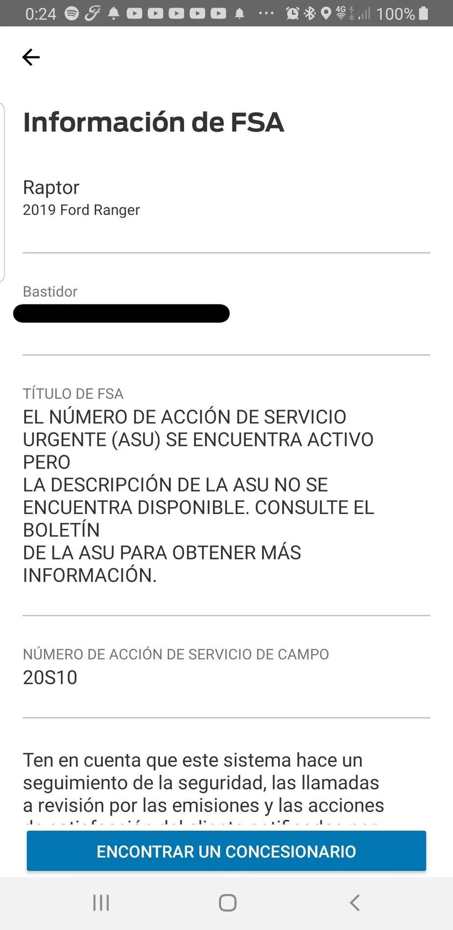

I just used my FordPass App, and found next message;
Anyone know more about the code 20S10?
