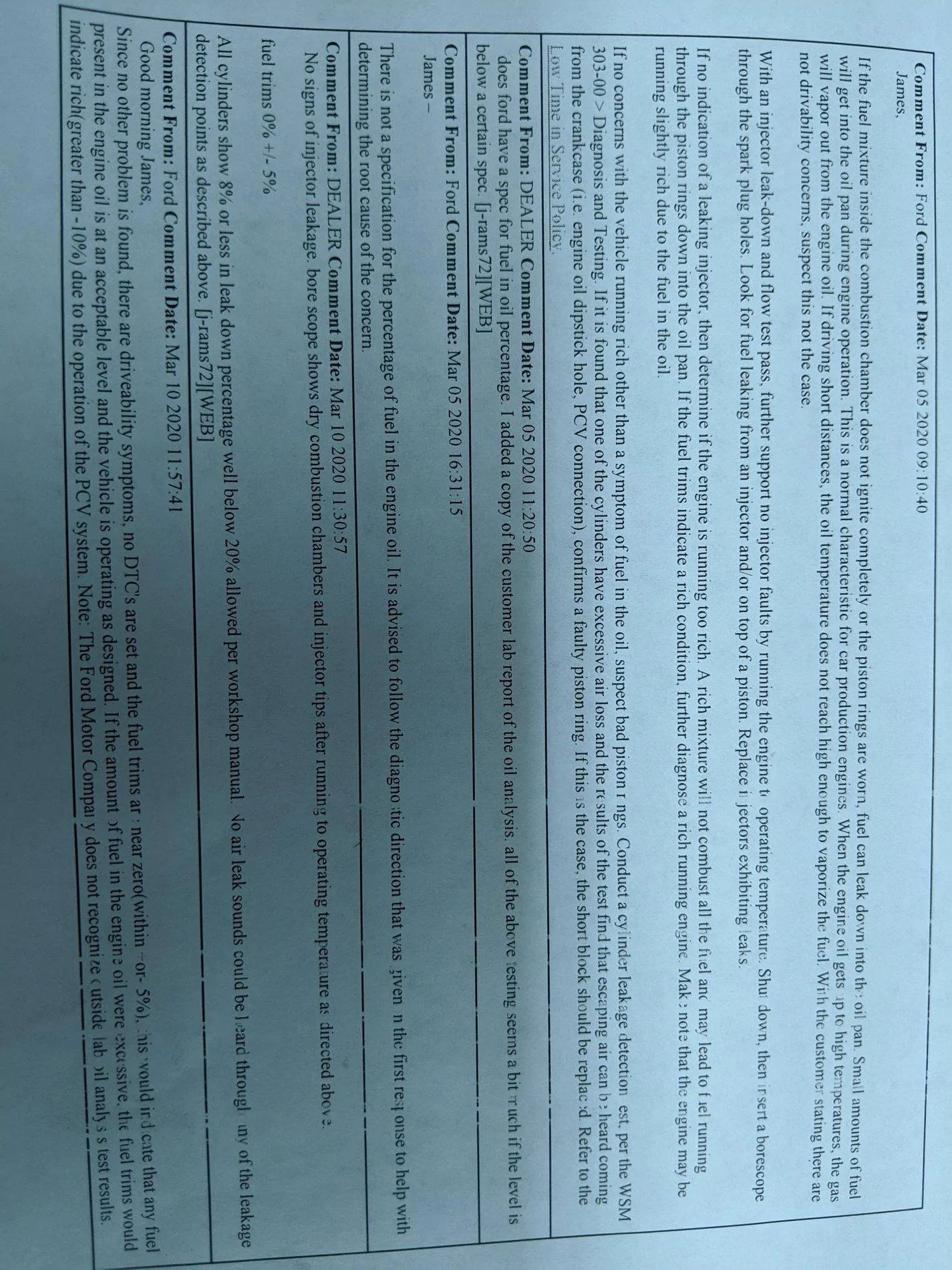

Sorry for the crappy picture of a printout but this is the back and forth between the tech and Ford on my Ranger. They basically concluded it was fine and reasonable and that it was "doing its job" since I have no drive-ability concerns. So me being me said "F" it im just gonna send it. Filled up with 93 octane and re flashed my 93 octane tune from Torrie @ Unleashed and im just going to keep an eye on the oil level and go to 3-4k mile intervals on the oil changes.
So I dont see any mention of high pressure fuel pump leakage, They pretty much isolated the problem to the fuel pump since all the other tests were okay.
