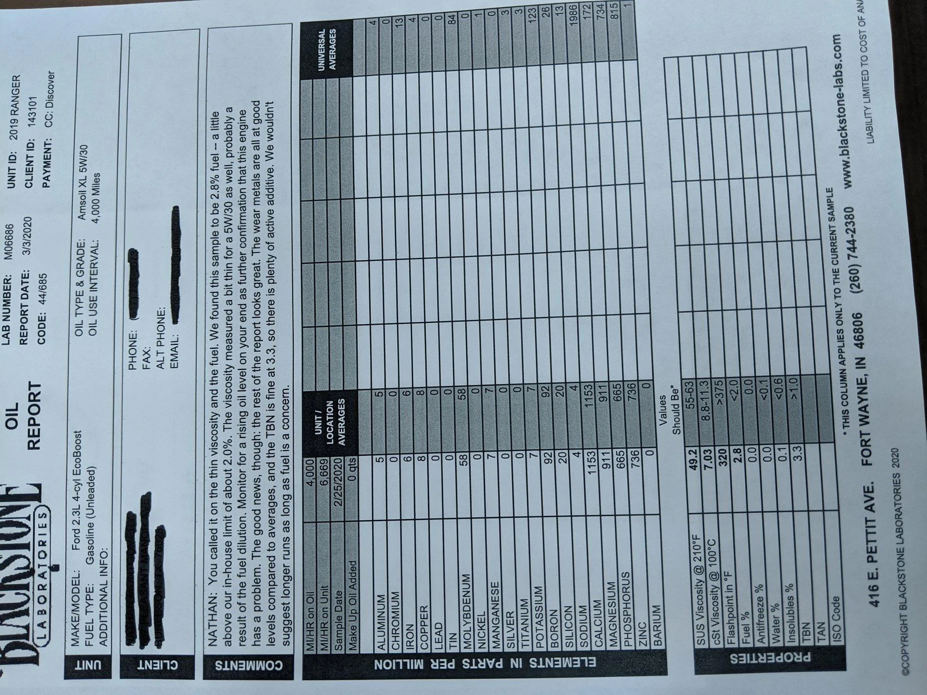

OWSportninja
Nathan
Jan 17, 2020
109
118
Burleson, Tx
2019 Ranger Sport SuperCrew 2wd
Sorry for the picture being sideways lol but anyways finally got my analysis back. 2.8% fuel dilution and it is causing the viscosity of the oil to go down prematurely. Also notice the flashpoint of the oil. And this is only 4k miles on Amsoil XL which I ran in my focus for almost 9kmiles with no issues. There is definitely something going on here. Having my service advisor write up another ticket and seeing how Ford is going to tell us to handle it. I'll update as I get more info.
