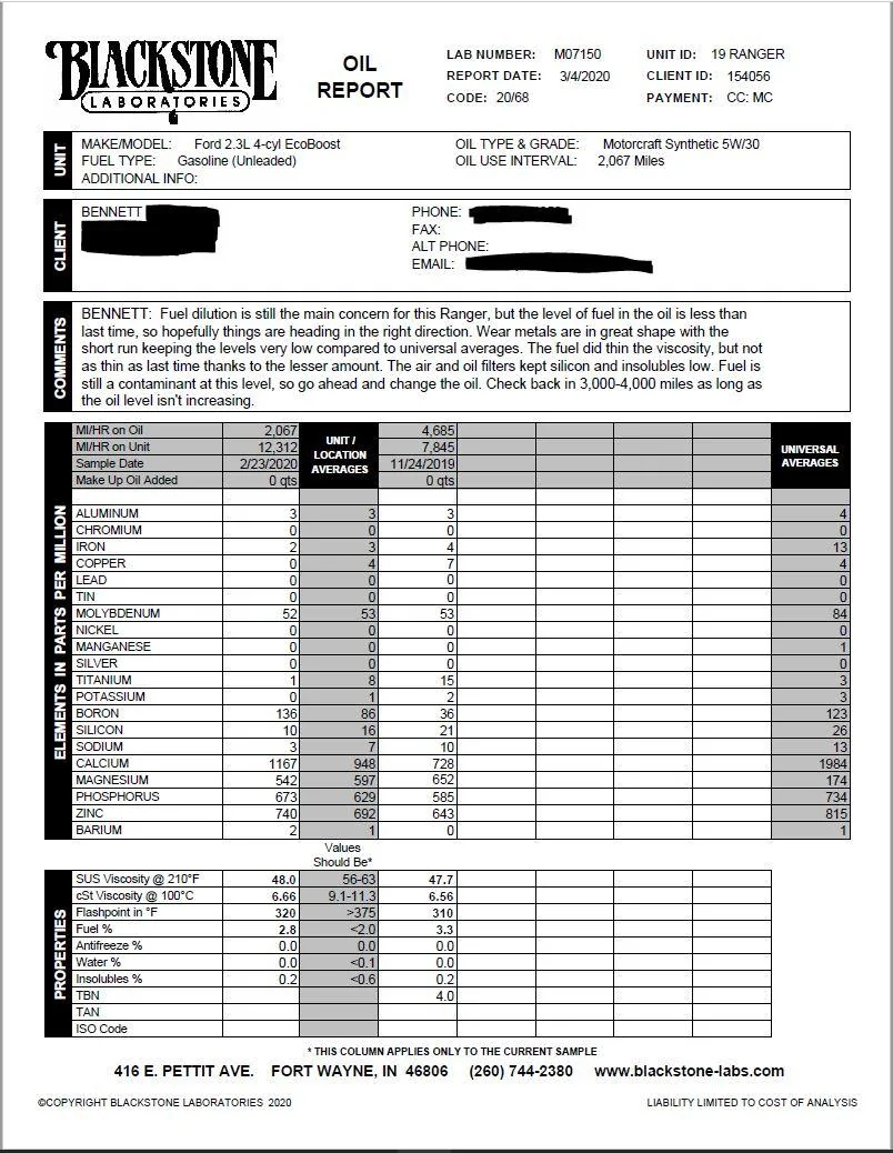

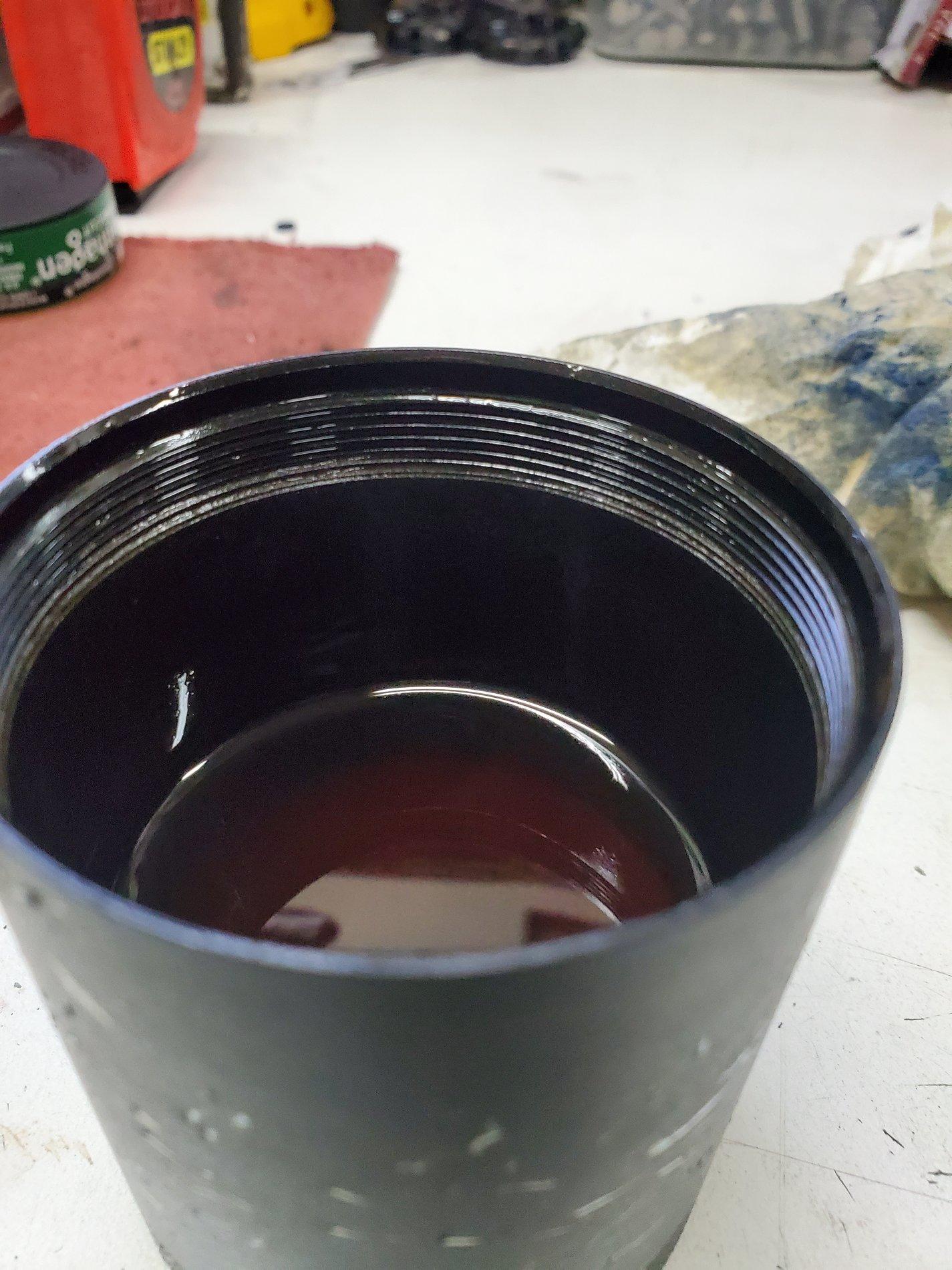

You need to tell them to check the fuel pump, you need to notify Ford Corperate, changing the oil will help BUT not if they dont do anything about fuel getting into the oil.My oil is over full an smells like gas. I have 2400 miles on it, never use the start/stop an drive about 11 miles each way to work so it should get good an warm. Been avg around 18-19 combined with 87. I ran a tank of 91 an got 17 mpg but we had a cold snap. I rarely use the sport mode either. I'm just over a quarter tank into this tank an I tried 89 an it's been quite a bit warmer an so far it's a little over 20 mpg.
I made an appointment at the dealership svc department for next Fri. I asked if they had any complaints of gas in the oil an they said none at all. I'm hoping for a free oil change to get rid of the gassy oil an hope it goes away.
