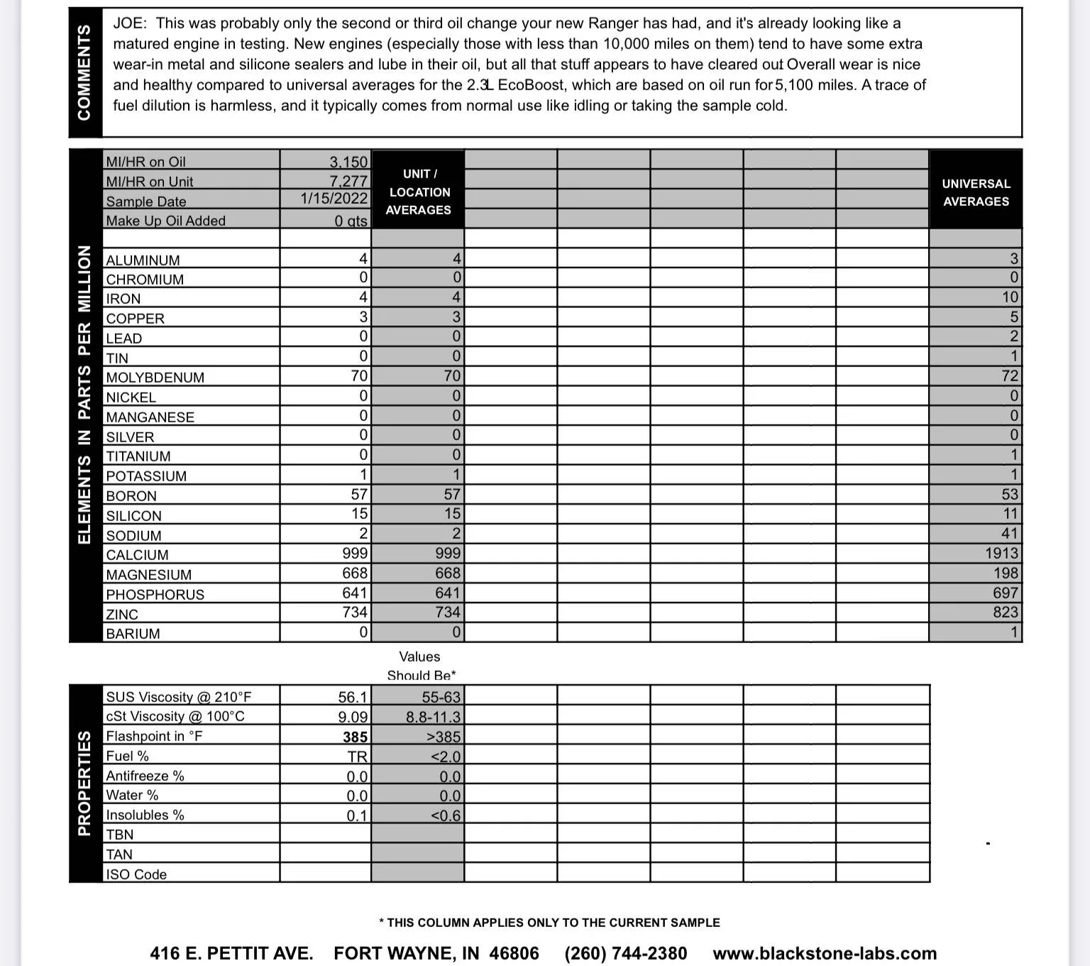

Have you actually had a fuel analysis done yet? Couple things on this topic to keep in mind. If your truck is brand new the oil has smelled funny for a bunch of us on the initial oil change but been mostly normal after that. The fuel smell doesn’t seem to perfectly correspond to a specific level of oil dilution.
With a DI engine there will be some fuel dilution. A small amount isn’t anything to be concerned about. The 2% factor that black stone uses is also not something carved in stone for this specific engine. It is just a figure that takes into account averages across a range of engines that black stone has tested including non DI turbo engines from what I gather.
Get an actual oil analysis done if you’re concerned. There’s simply nothing you can tell 100% from the smell or a small rise on the dipstick. When reading the results just keep in mind all these turbo charged vehicles expect to see some fuel dilution.

Well, back from the service visit. While the dealer agrees the oil level is high based on the owners manual, they had to preauthorize any work under warranty. Pre-approval request to Ford was met with a revised way to check the engine oil. Run engine and shutoff. Immediately check oil level before oil drains back down completely to get accurate reading. I requested revised documentation from Ford on that, but know that I won't get any. Not my first rodeo with Ford.
Anyway, going to change the oil and send off my Blackstone sample to see just what percentage of fuel is in the oil. I rarely keep a vehicle longer than the warranty period, so I'm not gonna sweat it.
