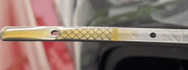

So just wrapped up at the dealership. They tested/checked the injectors and they are good. None of the cylinders had fuel saturation in them and spark plugs were fine. They did admit the oil level was high, so they drained some out. Gave me the speech about it's normal for there to be some fuel "odor" on the dipstick. Scored the dipstick, service manager took a pic, and asked me to keep an eye on it. I said no problem and came home.

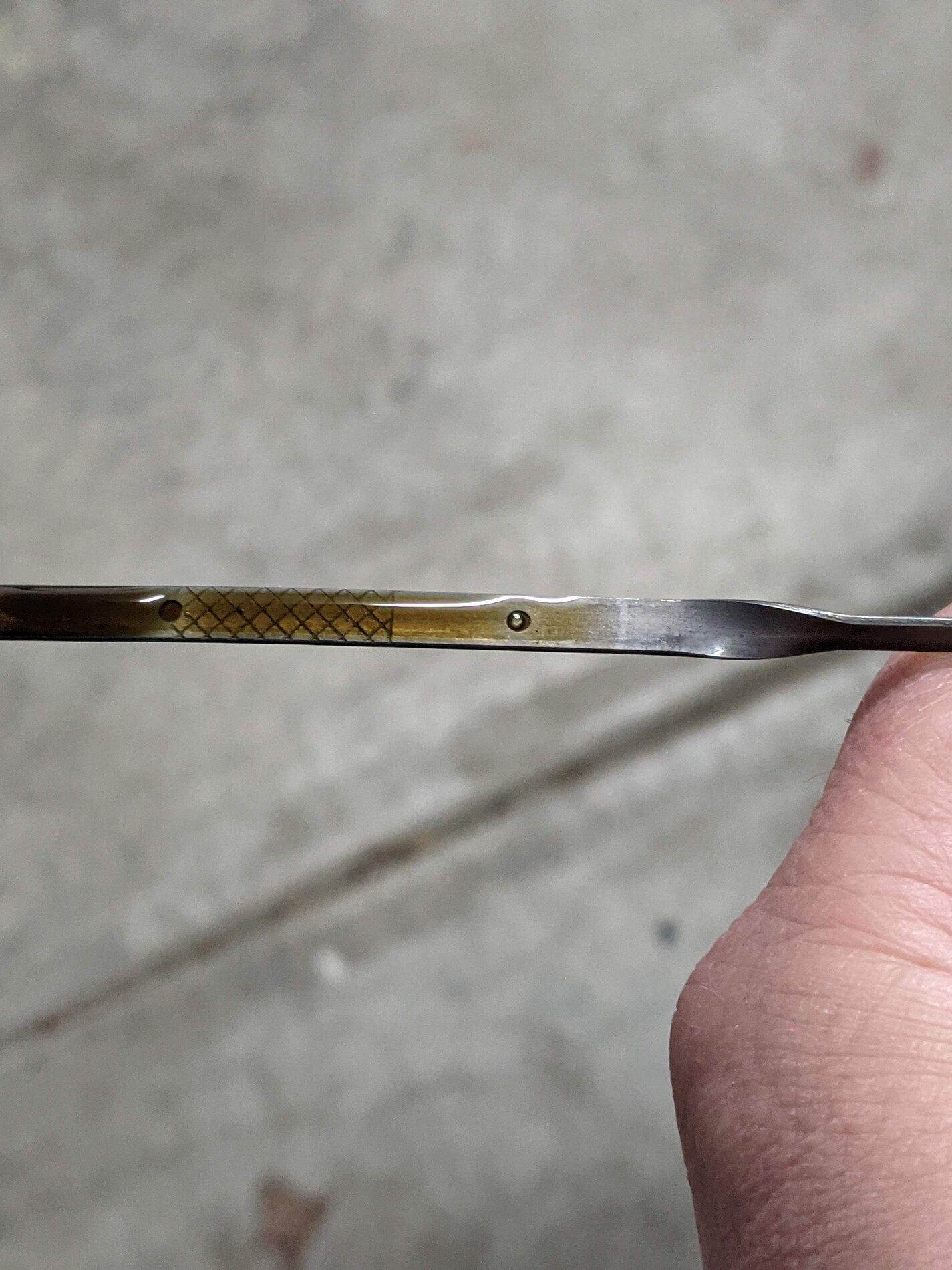

Well add another to the list. 1800 miles on the truck.
Was told this was normal by the dealer?
Asked to see any documentation starting the oil level above top hole was a normal operating level.
They then told me to bring it in Saturday morning to do their oil change and seal her up for a 1k run and check it again.
Update about 600 miles in my 1000 run
The mark is the level at the oil change 600 miles ago just a tad bit over 1/2 way to full now..
