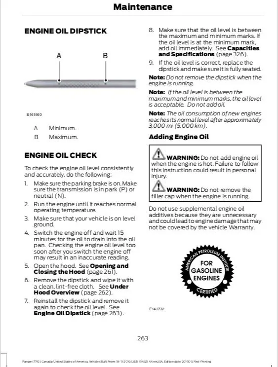

That goes back to a question I was wondering: what's the best way to check oil level?
There were a few methods on this thread;nthe manual doesn't specify whether the vehicle should have been running recently, just that it should have been shut off for >10 mins.
Has anyone checked oil after leaving the car sitting for days? If so, has the oil level increased or stayed the same from these top-hole readings?
Here's what it says in my 2020 manual:
Thanks -- but that's what I mentioned in my post, that I know what the manual says :D It says to wait 15 minutes, but doesn't say if longer is okay too...longer is also after 15 minutes :)
My question is: have people tried checking oil after sitting longer than 15 minutes, eg after a day or few days? Does that change the reading? Could this be related to oil drain rates?
Mine sat for a week while on vacation. I checked it when I got back out of curiosity before starting it, and the level was still at the top hole. Smelled like two stoke mix.
Lol - Sorry - I misunderstood your original post. I would think letting it sit overnight after driving it would be ok. So after sitting all night I checked the level and the oil was just under the top hole on the dipstick. I mean just under. I started the truck and let it run for 15 minutes, shut if off and waited 30 minutes (had a 30 min conf call) and I just checked the level and it is covering the top hole on the dipstick (oil is in the hole). So i don't know what to say. I have a 11:30AM appoint at the dealership. I'll see what they have to say. And both times I checked the oil there is a very strong smell of fuel.
I think it stands to reason after letting the truck sit overnight all the oil has drained down to the pan and cooled that's when you would get your most accurate reading. Every vehicle I've owned that's the way I checked it for an accurate reading!!
