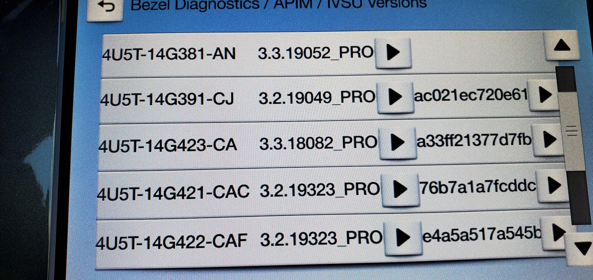

Please remind me as to how to access the Diagnostic Menu and what I'm looking for?
It sounds familiar but I haven't found the Diagnostic Menu.
Hold down the seek forward buttons on the wheel and the IP for 10 seconds. Make sure the radio is on prior. You’ll end the speaker walk around and you’ll be in the diag menu. Select the APIM item then the IVSU Versions.

So it took me almost 4 hours to download - then warned by the instructions that it could take an hour to install and having a 30 min trip, I started mine and let it run for 30 min before my trip only to come out and find that the truck had shut itself off. When I started it the screen said installation failed and had some error code, but I took off and then it started to download again and within about 25 minutes it successfully installed...now if I only knew what was added and updated :) My question would be is the file I downloaded somehow tied to my VIN and Sync code??? If not I could give the thumb drive to my buddy who has a new F-150??

Check your packages to make sure it actually did finish and not only the first part like some of the others have run into. No, you can’t share the drive. It’s linked to your APIM.

I seem to be missing the hash image of the upper file. Is that the problem?

No that’s no problem. Looks like you have everything installed. If the nav voice stuff still isn’t working, run that master reset. That *should* clear it up.

Thanks for the reply. My USB drive has no LED but the Sync system wasn't acting slow like it does when it is updating SW. I'm pretty sure it was not loading SW.
I remade the USB drive - quick format (again) then loaded the files onto the USB drive using drag and drop. The first time thru I used copy and paste commands (after a quick format). I'm not sure what made the difference here but the first time trying to load the "Updating system software" came and went but this second time through it stayed on. That said, I have no voice navigation files so I tried this:

The odd thing here is the system said it was successfully updated but there is still no CAF file installed according to the diagnostic menu.
Bottom line is this is becoming a bad joke. Almost 2 hours of engine run time and I still have an incomplete install to show for it.
I'm giving the full install one last shot.....
FAILED - AGAIN
Nothing I've tried has been successful in getting the CAF file loaded.

How long did it run while installing the one file? Should take ~10 minutes.
I'd guess it took closer to 15 minutes to complete.
Nothing seemed abnormal and the message indicated the software loaded okay before it rebooted itself. I do not understand why that file did not load....

OK, that sounds like it should have installed correctly then. Doesn't show in the IVSU Versions and nav voice is still down? Have you gone the master reset route post-installing the CAF? I've not run across a case of the file not showing post install before.
Yes, I tried the master reset and it's still not showing up in the IVSU menu.
I wonder if I should try reverting back to 118 (I have those files saved if that is even possible). Or will the voice commands get loaded when I update to 3.4?

I have succeeded in getting the map update installed and have verified via a known missing POI from the original version to it being there. The voice recognition returned after accessing the Diagnostic menu and poking around a bit. I made no changes in that menu but when I exited, the voice command was functioning.

3.4 wouldn't do anything as it won't touch those particular files. Then again, I've never heard of this case of an install showing complete, but the image not appearing to be there either. You can try rolling back to 18 maps to see if that recovers it.
